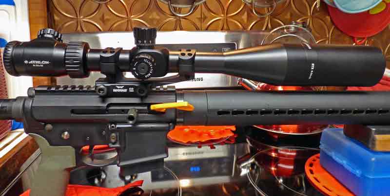

I have a couple Aero's and I don't like the clamp system and honestly don't trust them for anything more than light LPV's on low recoiling rifles that won't get tossed around and smashed into things. There's just not enough metal there for me to trust them with anything important or heavy.
@TonyTheTiger
Can you into more detail about the Aero mounting system? You mentioned it has a weakness? How do the other mounts you listed improve on this?
Interested to hear as this will be bumped agaist metal/wood/concrete.
Just can't really summon a lot of confidence for this design.
Also when you tighten the rings down it inevitably rotates the scope a couple degrees, Aero is aware of this and will tell you to start with the scope that many degrees off of level. Not really the easiest to be precise while mounting. Then there is the vertically split ring thing if you want to open that can of worms.
And for me personally the SPR version doesn't have enough cantilever to work with my desired LOP/eye relief. I asked Aero about making a longer offset mount and they said absolutely not, probably because the already minimalist design wouldn't be strong enough if extended further.
