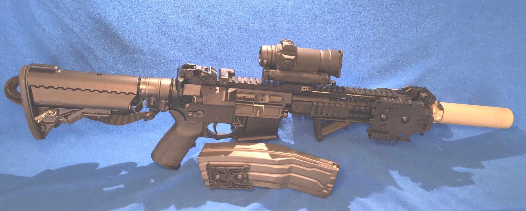

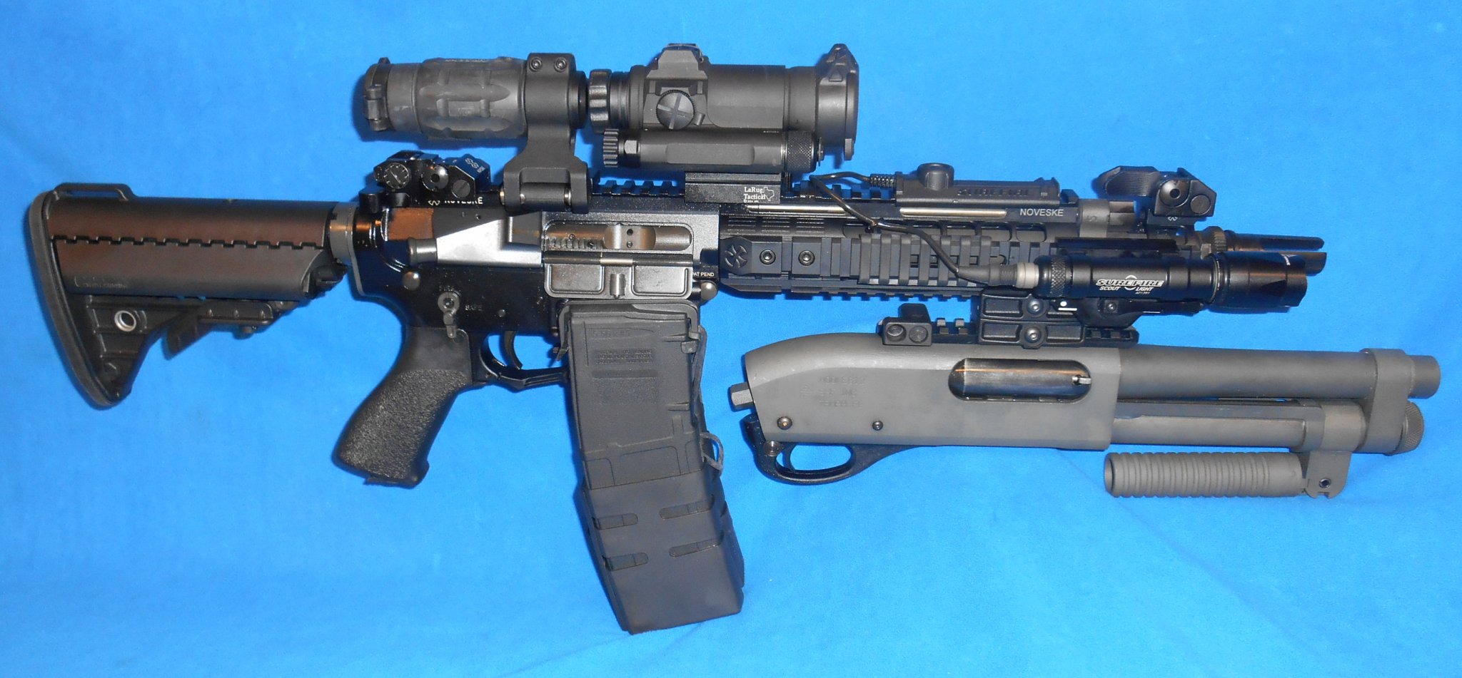

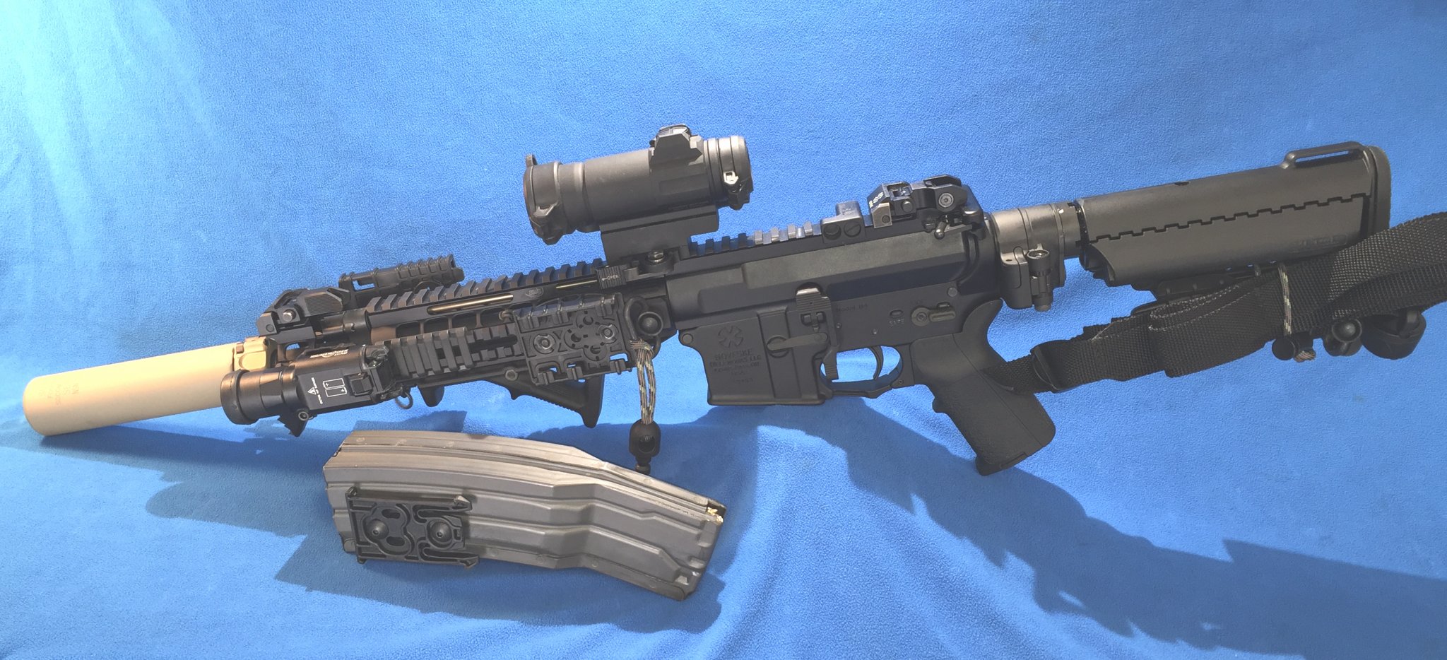

I have several 5.56 SBR's but in the OP's barrel length range, this 10.5" Noveske N4 is my favorite and also set it up as a "Master Key" just for fun. As mentioned little to be gained by swinging about another 4" of 5.56 barrel.

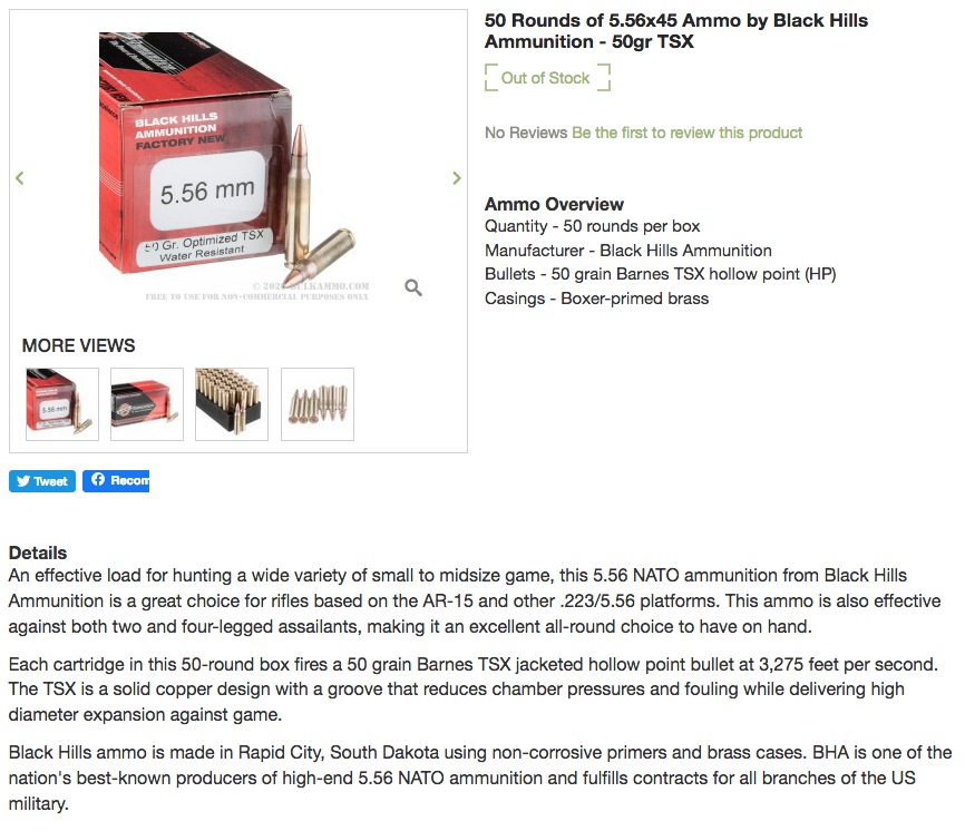

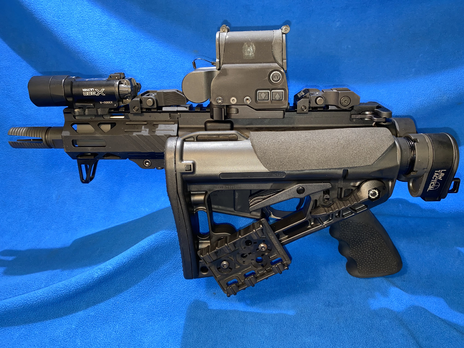

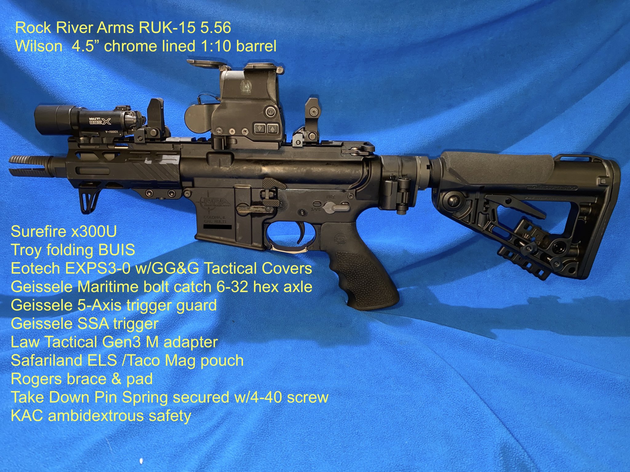

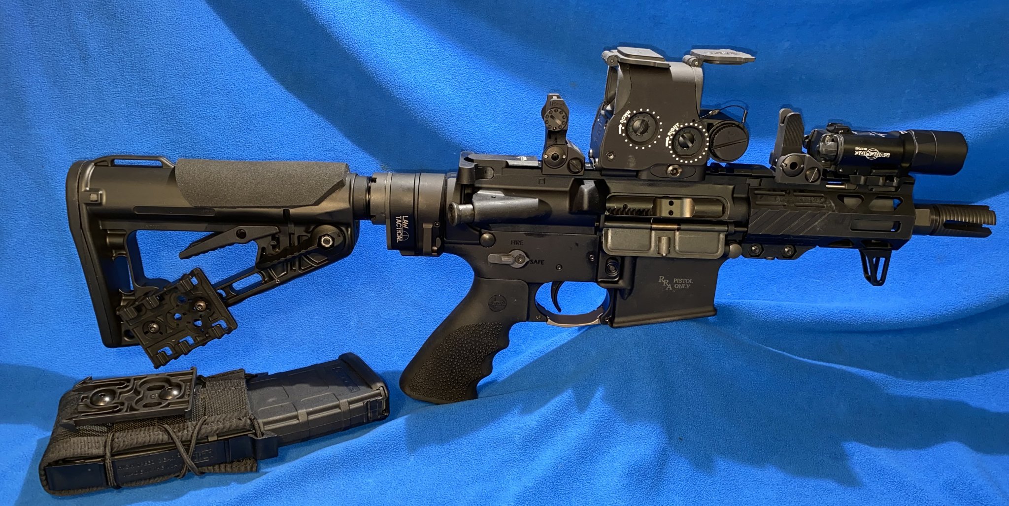

Also, went the other way by 6" with this 4.5" Rock River Arms 5.56, MagnetoSpeed V3 clocks it at 2250 fps (same as my FN 5.7 pistol) with Black Hills 50 gr TSX Optimized ammo; pretty small package. Unsupressed it is not any louder than FN5.7 pistol as one would expect with similar ballistics
