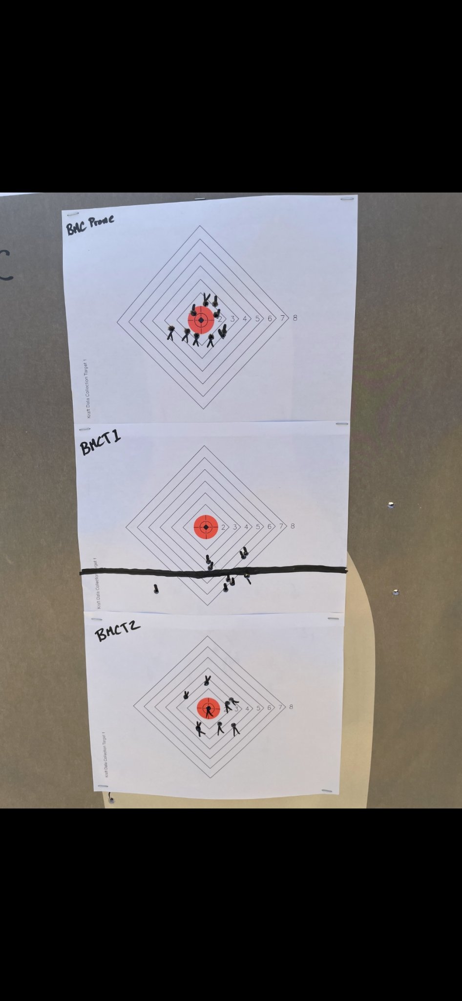

AR Positional POI Shift Test
Veracity
Edit **I’ve had a few people ask. Here is the link to my test target if anyone is wanting to use it. https://veracitysolutionsllc.com/resources/ **

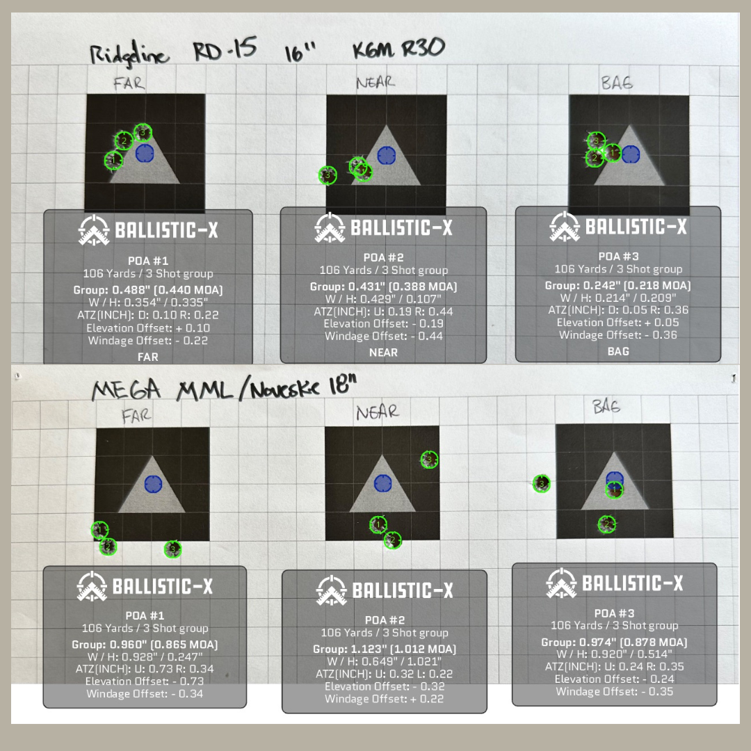

Finally got a chance to get out and test a few different uppers for POI shift and get pictures.
These are NOT to bash any company but to make aware an issue that could be affecting your shots when changing positions or bipod locations. The point is to test and know if your shift is consistent and repeatable and then accounting for it if the style of shooting and targets you engage warrant it. I have used several methods depending on what I am using the rifle for to work through this. *I understand this isn't super scientific and the data is limited, feel free to test for yourself. More rigid receivers, semi-monolithic and monolithic receivers help mitigate this issue.
1. Zero normally from bipod, and add the shift to my data when in other positions that would have a shift. (Ex. .3 MIL shift, Normal data when using bipod, add .3 MIL to positional data)
2. Zero inbetween the shift as the targets may be tall enough it is in the noise. (Ex. .3 MIL shift, zero from bipod .15'ish high and bagged position is .15ish low)
These were shot from a bench modified prone as neutral as possible to do my best of not affecting results from inconsistent pressure. The bagged shots were taken from kneeling using the same bench.

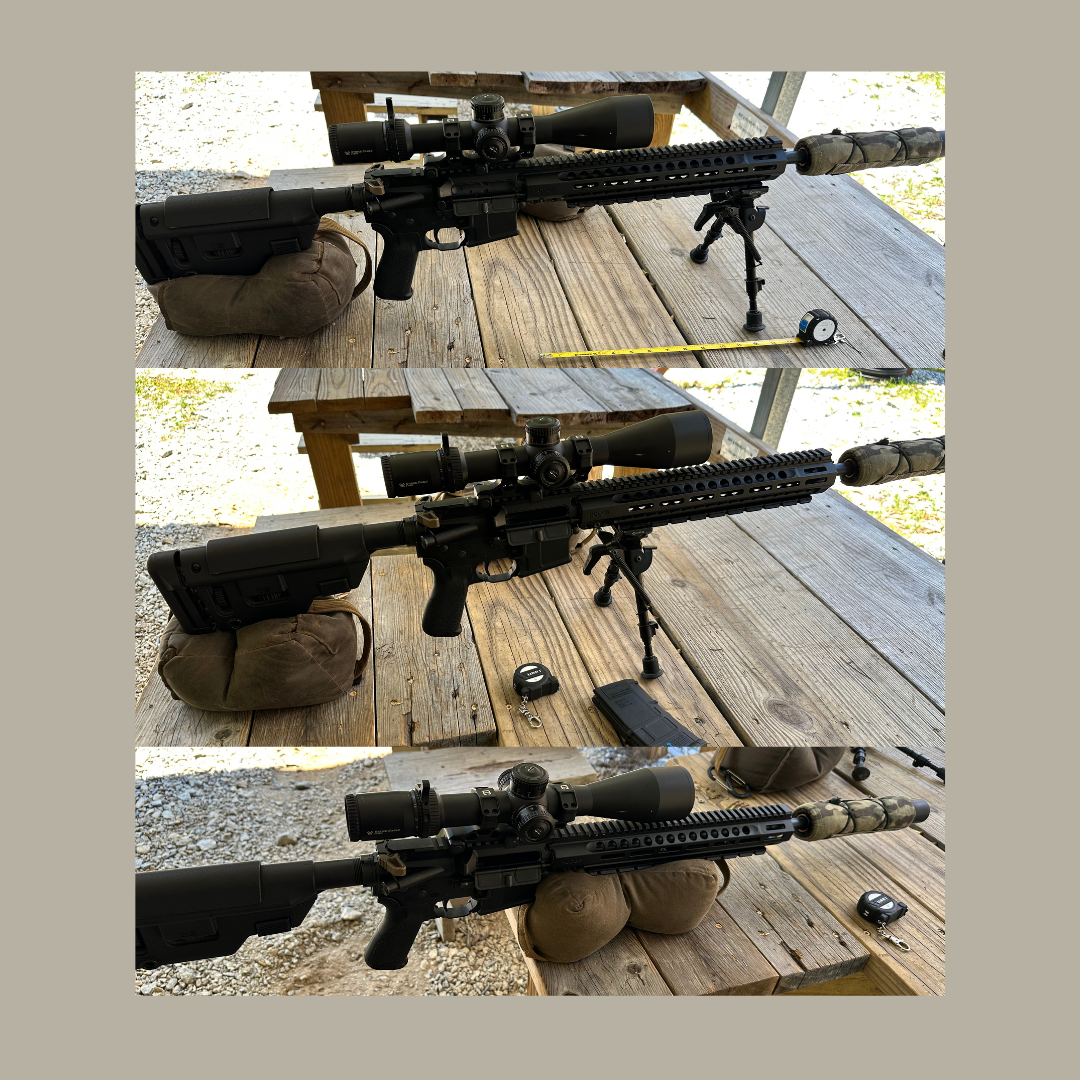

Harris BRM-S 6-9 Bipod was placed at 12.5” from the front edge of the magazine well, then at 3.5” away, then fired kneeling from an Armageddon Gamechanger shmedium w/ heavy fill. This was done to keep things consistent across each upper.

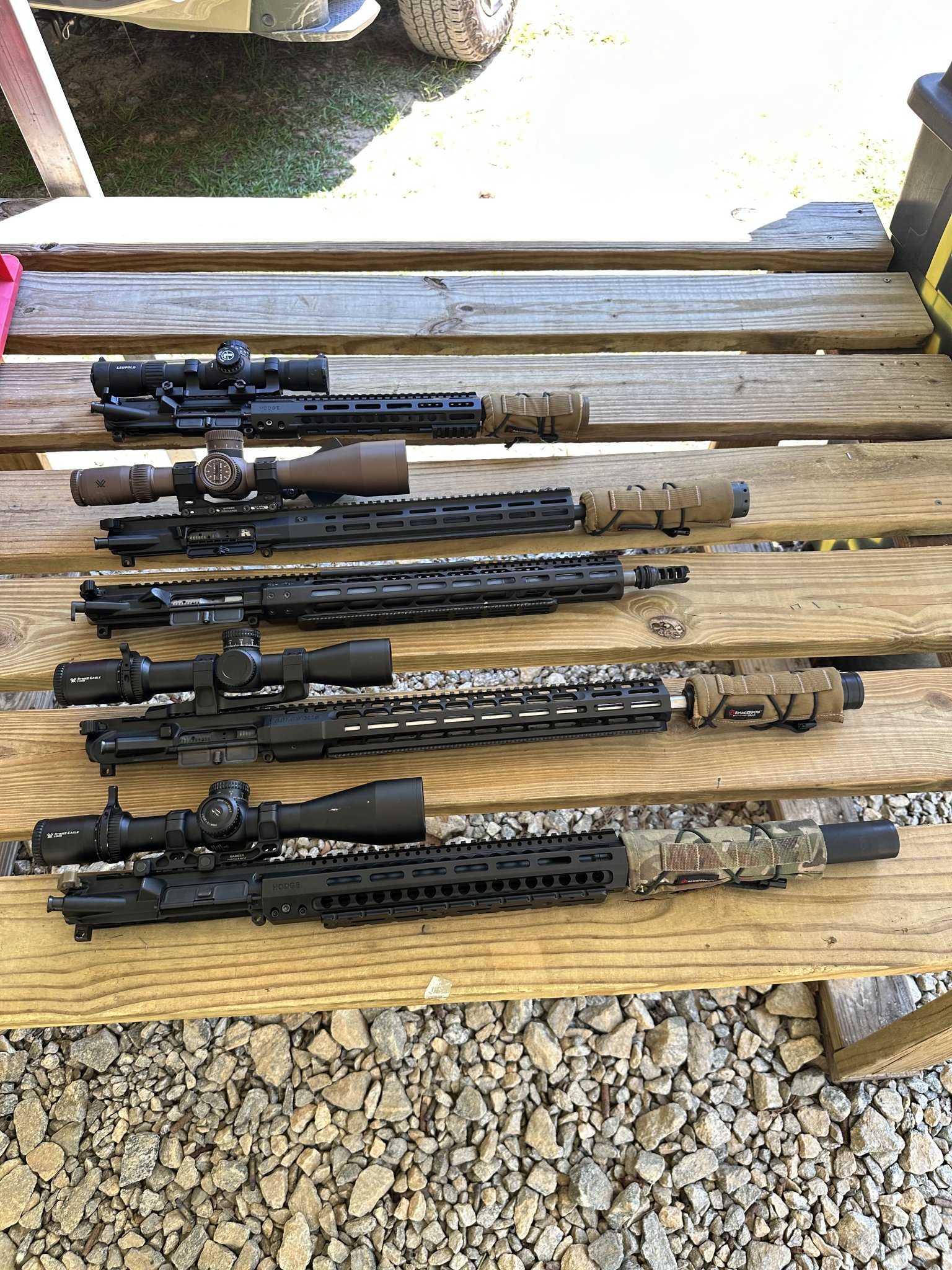

Uppers:
Semi-monolithic:
Ridgeline Defense RD-15 LPR 16” Proof Research (KGM R30) (Thermal fit and bedded)
Mega MML 18” Noveske Barrel (no suppressor) (Unsure of assembly)
Standard Barrel nut design:

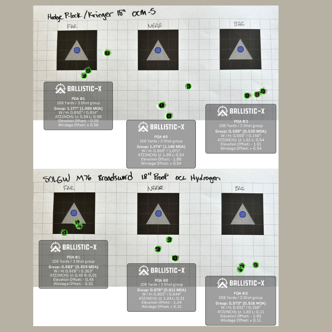

SOLGW Broadsword M76 18” Proof Research (OCL Hydrogen) (Thermal fit and bedded)
Hodge Defense Pinchlock 18” Krieger (OCL OCM-5) (Thermal fit and bedded)

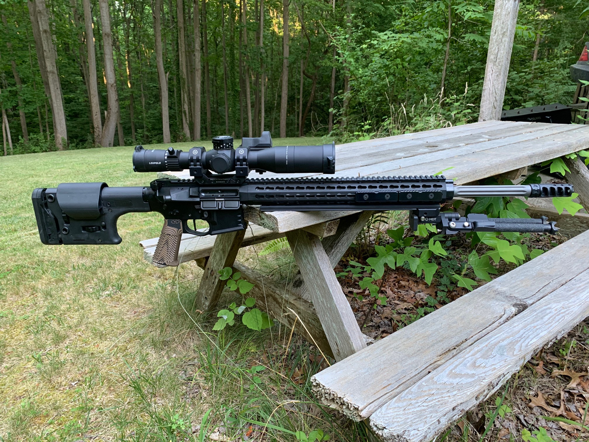

Nice to see the post here from IG. Here is anofher data poinf. Vltor MUR/WOA TR handguard with a .4mil shift low. Note: the bottom group was centered due to holding .4mils in the reticle. Top group is bipod/rear bag. Middle is tripod standing/kneeling/sitting off a table/bag. Bottom is the adjusted group.

Nice to see the poat here from IG. Here is anofher data poinf. Vltor MUR/WOA TR handguard with a .4mil shift low. Note: the bottom group was centered due to holding .4mils in the reticle. Top group is bipod/rear bag. Middle is tripod standing/kneeling/sitting off a table/bag. Bottom is the adjusted group.
Thanks for sharing that extra data point. Always loved those VLTOR MUR receivers

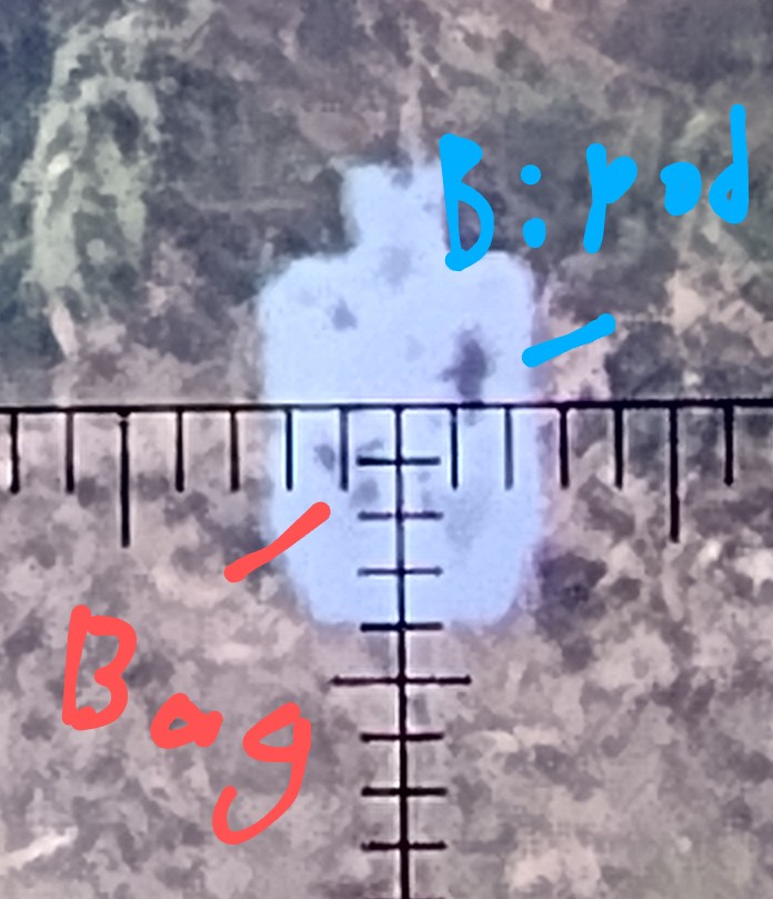

I see about .4 between a bag and bipod. I just got a thermofit upper receiver and was hoping it might reduce the shift. This makes me think it's not going to be promising...

Can you speak on the Ridgeline design and why you believe it has less shift? Also, what amount of shift in mils do you consider it to be?
The Ridgeline is a thicker receiver and semi-monolithic where the barrel nut is thread into the receiver and the forend makes no contact with it.
After a few hundred rounds of testing I’ve seen no perceivable POI shift with the Ridgeline. My Seekins IMRT-3/SP-10 and Aero Enhanced w/ Sgt of Arms forend would have up to .1 MIL shift but have always been solid for my use. The Ridgeline is just on another level.

I've got 40 rounds loaded for the test. 6ARC
Lapua Grendel necked down
108 eldm
29.4 Lever
2.290 oal
should be 2670-2700 This barrel only has about 40 rounds on it. It is the replacement Rainier UM. If head space grows over these 50 rounds they can stick this barrel up their ass.
VLTOR Fusion F-15 Face trued & shimmed. The VTOR Fusion extension is just as loose as the MUR's
Steel KRG Arca rail
22" +2" gas barrel
Gun weight with Ckyepod & no mag is 15lbs-6oz.
I'm thinking 5 rounds to get a good zero @100y Bi-pod/rear bag & light preload, 5 more to true dope to waterline at 500y with same bi-pod rear bag. Then build and break position 5 x with 3 shots each from prone bipod/rear bag to kneeling off a barricade with a smedium heavy fill up against the magwell.
Does this sound like a reasonable test?
What is the preferred program you guys would suggest I use to calculate mean radius after this test??
500Y on paper will probably hurt my feelings. Hopefully the load will be at or under 1 moa at 100y
Thanks

1a. I wonder if the steel KRG rail bolted to the handguard makes for a stiffer upper? Obviously the issue we are all seeing is the area around the barrel nut, but I am curious if a steel ARCA rail aids in less POI shift.
1b. Does anyone have the means to test this? Do a normal test without the rail, then another with the rail on? I assume there would be less shift due to higher rigidity along the length of the rail, but testing alone would show this.
2. Paper groups at 100y seem to show well enough POI shift. At 500, there is a bit more noise from velocity and BC rounding errors and inconsistencies compared to 100y. 100y is just cleaner.

The gun still has a gap between the magwell & the rail. For the poi shift flex must be happening across the joint where the extension mates to the upper. Seems like the steel rail may actually aggravate the issue since it's heavy. In addition to the heavy Arca, I've got a few weights out towards the front of the rail.
The range I'll be shooting at for this has 100 & 500 only.
I could just shoot dots @100y, but I'd still want to enter them all into some program to calculate mean radius from dot center for the total group of 15 per position. Not sure what tool/program is best suited to do that?

Just shoot the dots in prone and off a bag, the impacts will show any shift.
