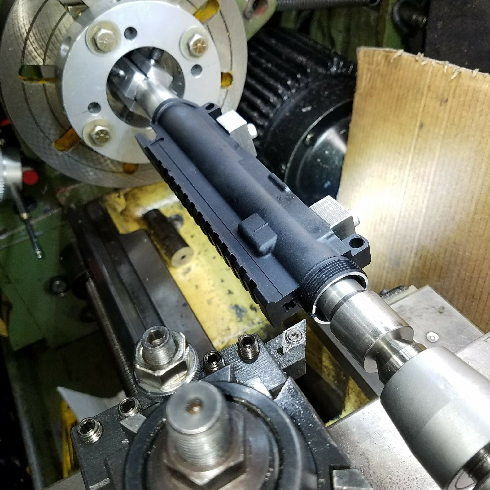

I have a lapping tool, I would just feel better about dialing and cutting. Anybody have any ideas for a fixture?
Here you go. I used the same precision rod on both set up
The bottom picture I use a rotating tail stock chuck and a mini spider. Why so many adjusters? I drilled/tapped the extra set while I had the spider in the super spacer. The rod is held by a copper ring in a set tru 6J to allow the rod to gimble as I adjusted the TS spider.
The top picture I just dialed the rod at the chuck side, TS center just holds the rod
The rod center holes were drilled and single point cut with compound at the correct angle.
Use a 1" rod with a slight interferance fit , make sure it's running true. You don't need a dog or pin, you'll only take a few thou. off the receiver.
This is what I would do. Mandrel turned between centers, stick it through the receiver. Can't be anything but right.
I can't see holding one end of a mandrel rigidly in a chuck/collet and the other end in a spider unless the TS is seriously out of alignment. Nothing is gained over just sticking it in the center and it's a hell of a lot faster with nothing to dial in.
Yep, the other is a nice fixture but I could square 100 receivers in the time it takes to make it and set it up.

Everything on the extension except the lugs, chamfer and feed ramps are cut all in one op. Drilled, boring bar cuts the front of the lugs, threaded, profile, flange cut and parted so all of that should be square with each feature.
Everyone should try to use receivers that are tight to the extension. Vltor Mur and Mega which is now Zev always had a better fit than most I could find.
If the extension has to be tapped into the receiver then the ID of the receiver and OD of the extension hold the extension square with the receiver bore and the receiver really doesn't need to be squared.
Most receivers I squared over the last 12 years are around .002-.003 out of square across 1". If the extension fits loose in the receiver and the face is out of square half of the bolt lugs may be touching and will catch much of the thrust before the bolt lugs on the other side.
We can't catch every single problem but we can try and every thing we catch will help the build.

I special order my competition barrel extensions from BAT Machine with 1.000 OD. On most receivers I have to slightly heat up the front end of the receiver and tap it into the BE. The competition BEs have 20 TPI threads and are 0.3 longer.

Frank,
You are right
I checked runout after chambering, I even check thread runout by running a DTI on the thread with the lathe still set up for threading, verified shoulder for any runout, all checked good, but barrel extension is screwed on and check for runout, the reading is all over. The best ones are the ones I order from BAT Machine. Plus, I like the 20 TPI thread, 1.000 OD, and 0.3 longer tenon.
