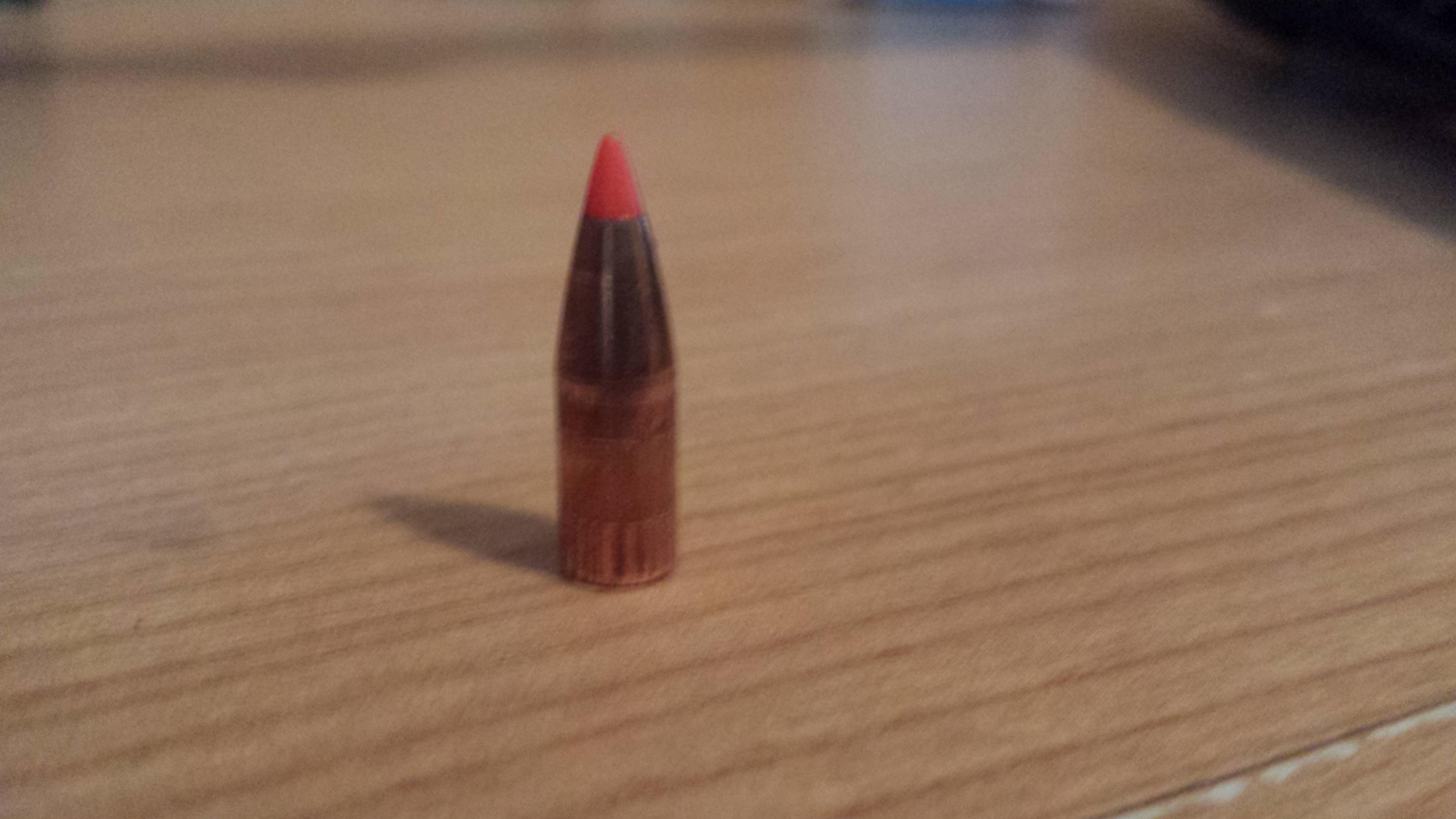

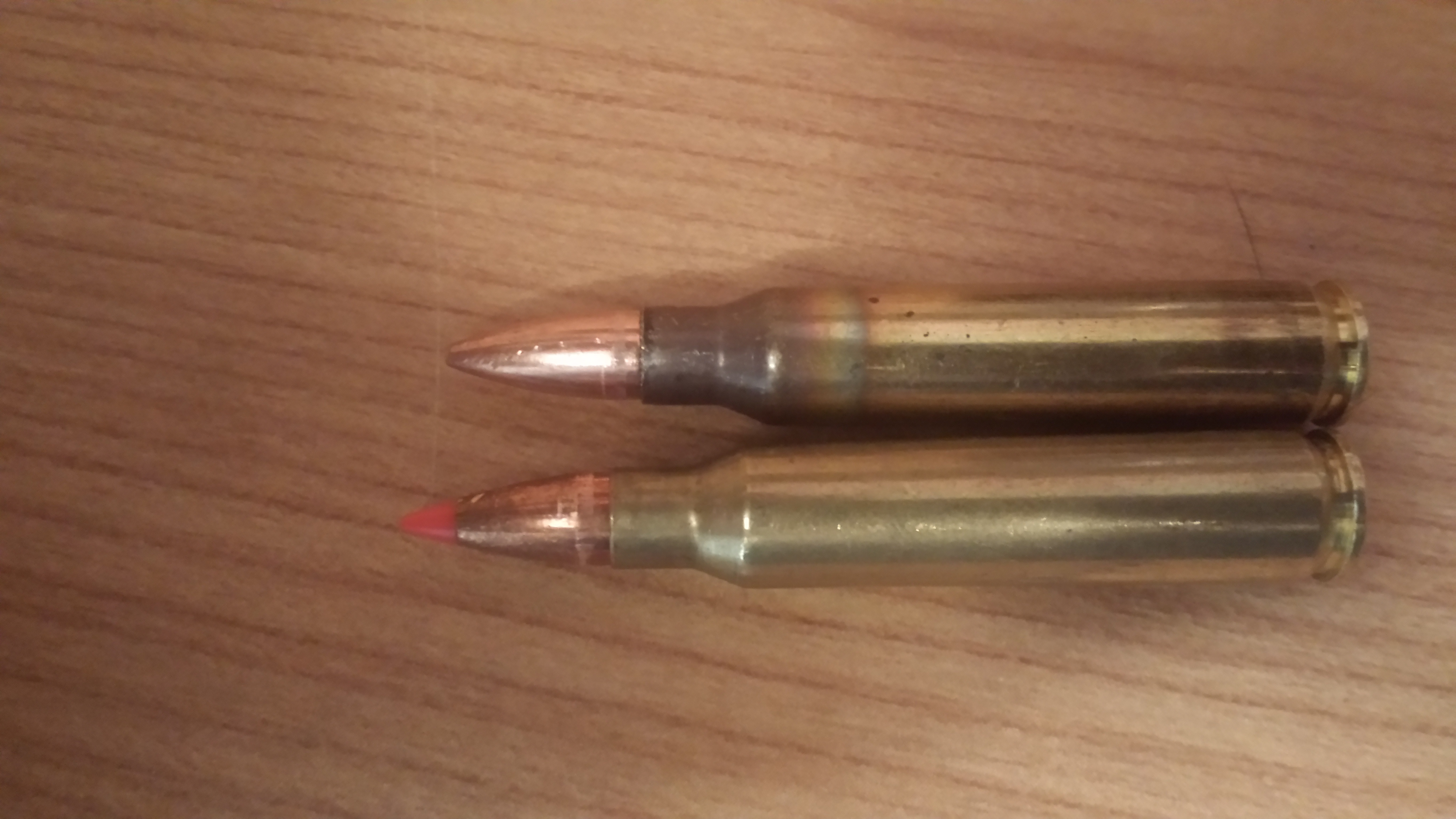

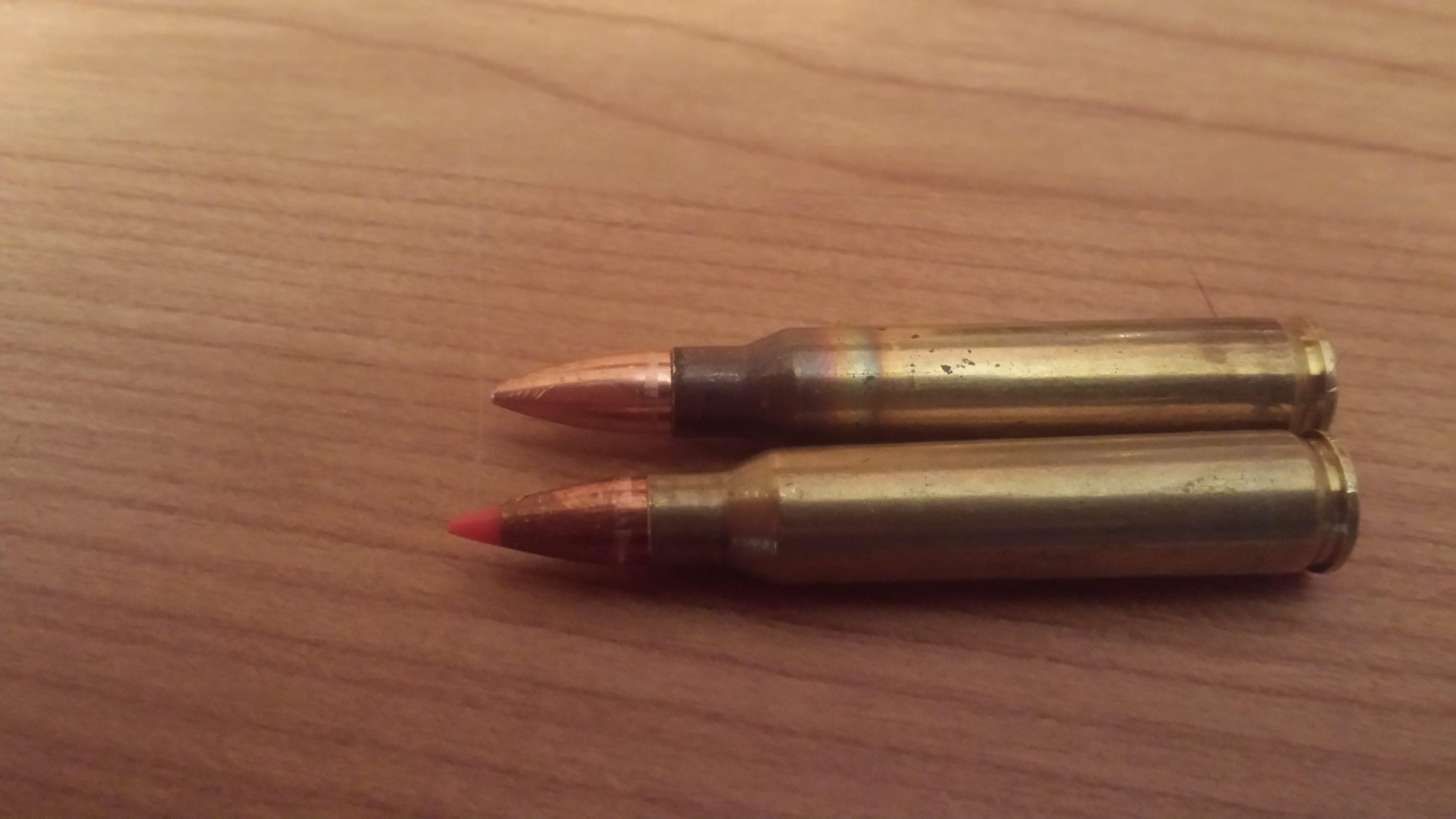

So have probably around 500 rounds through this rifle, the issue didnt start right away but its getting worse to the point of pissing me off. I chamber a round and they all fire no issues, however, if i go to do a brass check or un-chamber an un-fired round its a B**ch. Its super hard to get the round out and 3 times its actually pulled the projectile out of the neck of the case. The barrel is clean, the chamber is clean so it being dirty isn't an issue.
Barrel is a Black Hole Weaponry 5.56
I usually fire handloaded match ammo through it but its super tight whenever factory ammo is chambered as well
So here is the kicker. Its not tight on the casing, its tight on the projectile. You can see in the pictures were the chambered rounds have scuff marks on the ogive. one is a factory ball and the other is a handloaded vmax.
any ideas?

Your rifle doesn't have a tight throat, it has a short throat. What is happening is that the bullet is engaging the rifling upon chambering; which is causing the marks on the bullet and the three instances of the bullet being pulled from the case neck.
I would check the COAL of your hand loads and the factory ammo first. From there I would probably contact the barrel maker and see what they can do for you.

If the scuffs are all the way around the freebore is smaller than .224 and should be returned and re-throated. If there are only 4-6 square marks the bullets are jammed into the lands. Either set them back or send it back to be re-throated. Anyone with a .223 Wylde reamer could fix it.
You could remove the barrel from the receiver and insert a +.224" inspection pin into the freebore to check it.

the bullet doesnt reach the rifling because the scuffs are all the way around. otherwise it would have 3 grooves which it doesnt. sounds like i will have to contact blackhole tomorrow and see what they say
Maybe the scuffs are all around because of the polyaganol rifling? Rifles are typically more accurate if the bullets are seated on the lands but you could have pressure issues. Honestly if the chamber Mikes at go then I would just shoot it. Bring a rod in case a bullet gets stuck....
First ask Blackhole if they are chambering there barrels or if they have it done for them. I see this happen when a solid pilot finisher is used in a CNC Lathe. Most often when this happens coolant in used and the chamber is finished in one motion. After time the front of the solid pilot finisher is worn down not opening the bore enough for the bullet to seat. Live pilot finishers are if you want a short throat enabling people who reload the ability to reach the lands with out exceeding the mag length. Then you have the hot rod chamber, some match barrels are done this way to improve accuracy. When you chamber you finish "go" -.0002 you bolt will close on a live round but not on a go gage unless you force it.
I wish someone would explain why is there such a big difference between the unfired brass and the reloaded brass? Something is very wrong here.
Attached Thumbnails Attached Thumbnails
They are identical OAL, its just they aren't even in the photo.
