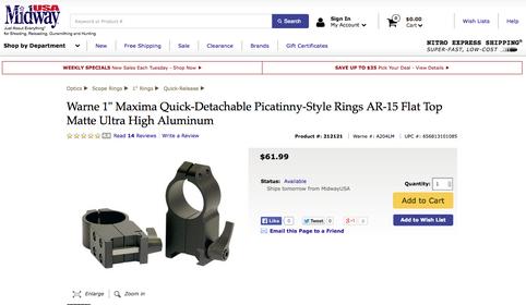

I am changing the scope mounts to these which are 1.5" from the top of your rail to the center of the scope tube. This height gives ME a comfortable cheek weld. If you go lower be sure your scope mount "DOES NOT" extend under the zoom adjustment ring because mount will bind with the adjustment ring.
