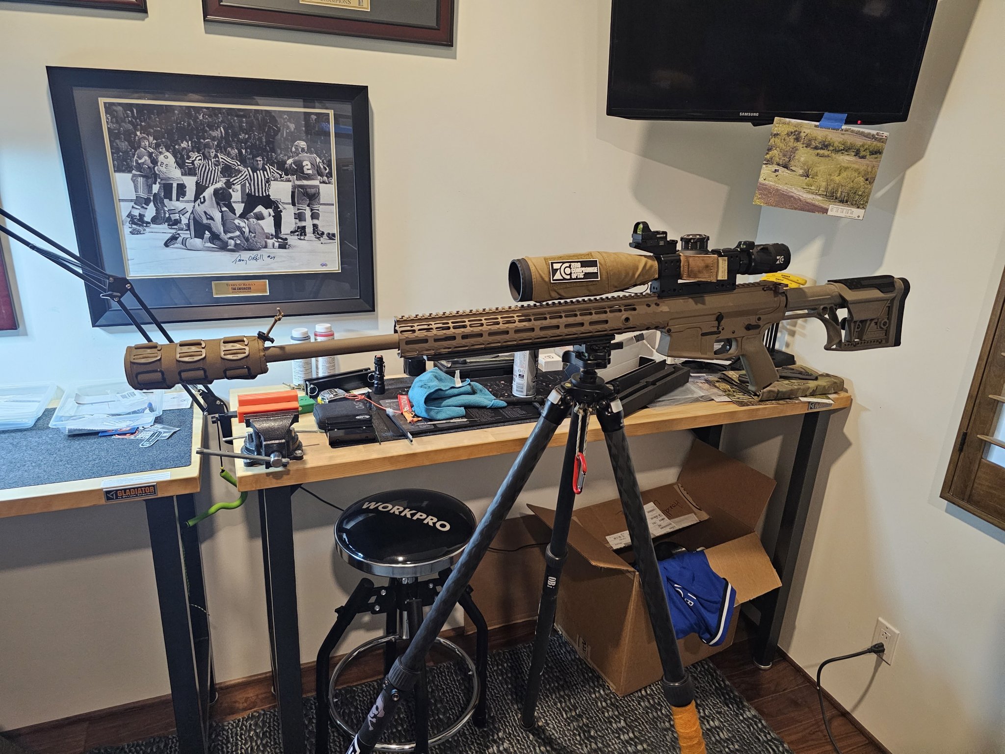

I have a large frame gasser in 6GT with a 22" GAP Bartlein and have shot in PRS for about a year. The only feeding issues I had were early on with factory 109 ELDM. Occasionally a polymer tip would shear off when feeding. I polished the feed ramps and radiused any sharp edges and that eliminated the problem of snapping polymer tips. I currently shoot 107 SMK over 6.5 Staball @ 2850 fps. The rifle is a joy to shoot.
