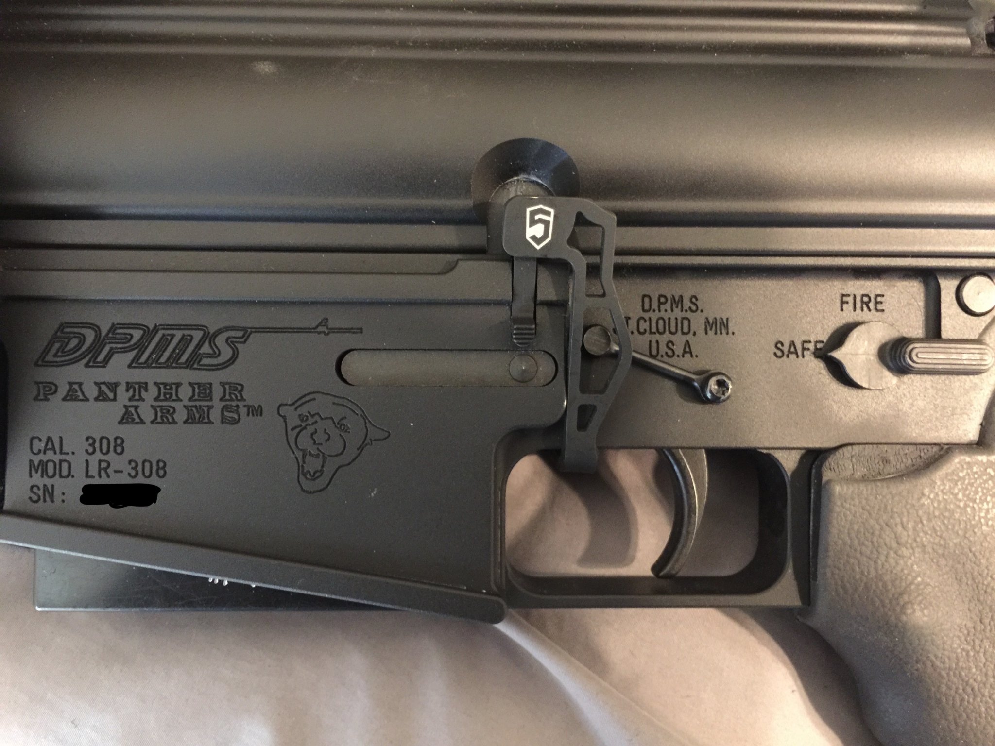

I just wish PHASE 5 would make an extended one to fit my 308 like my 223.
You mean like this one??
