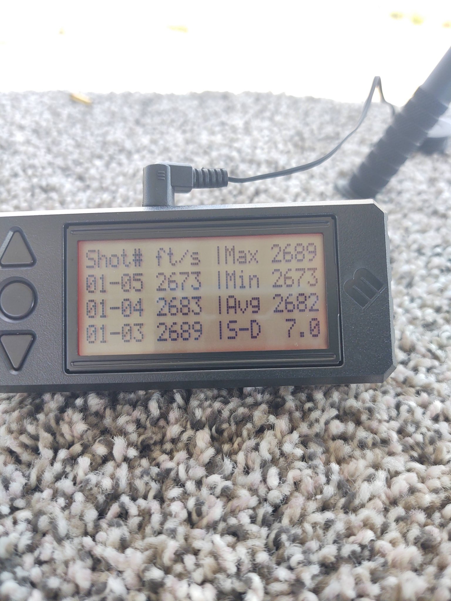

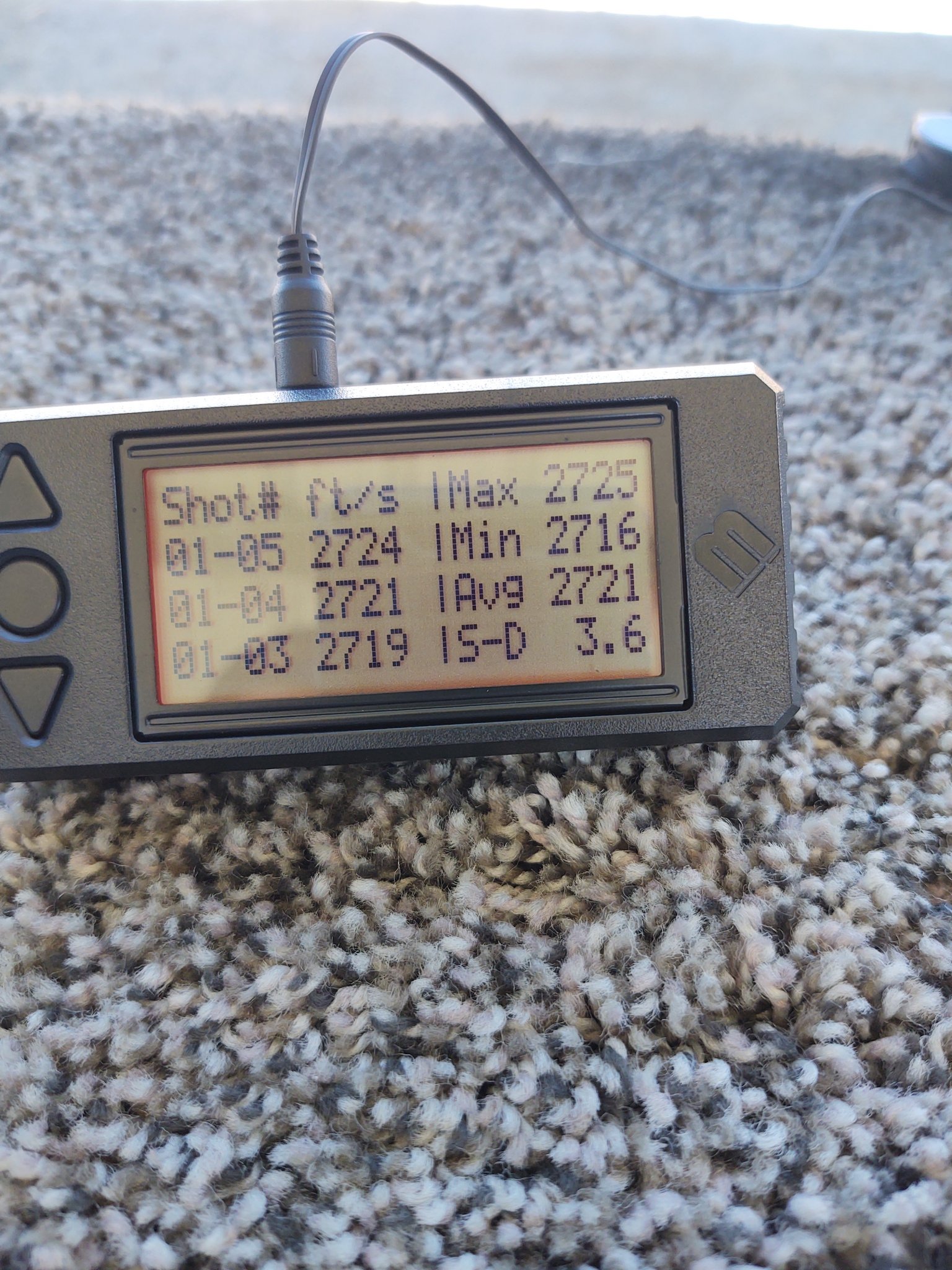

What kind of velocity are you getting with the load your 6.5creed likes with the 147’s and barrel length?

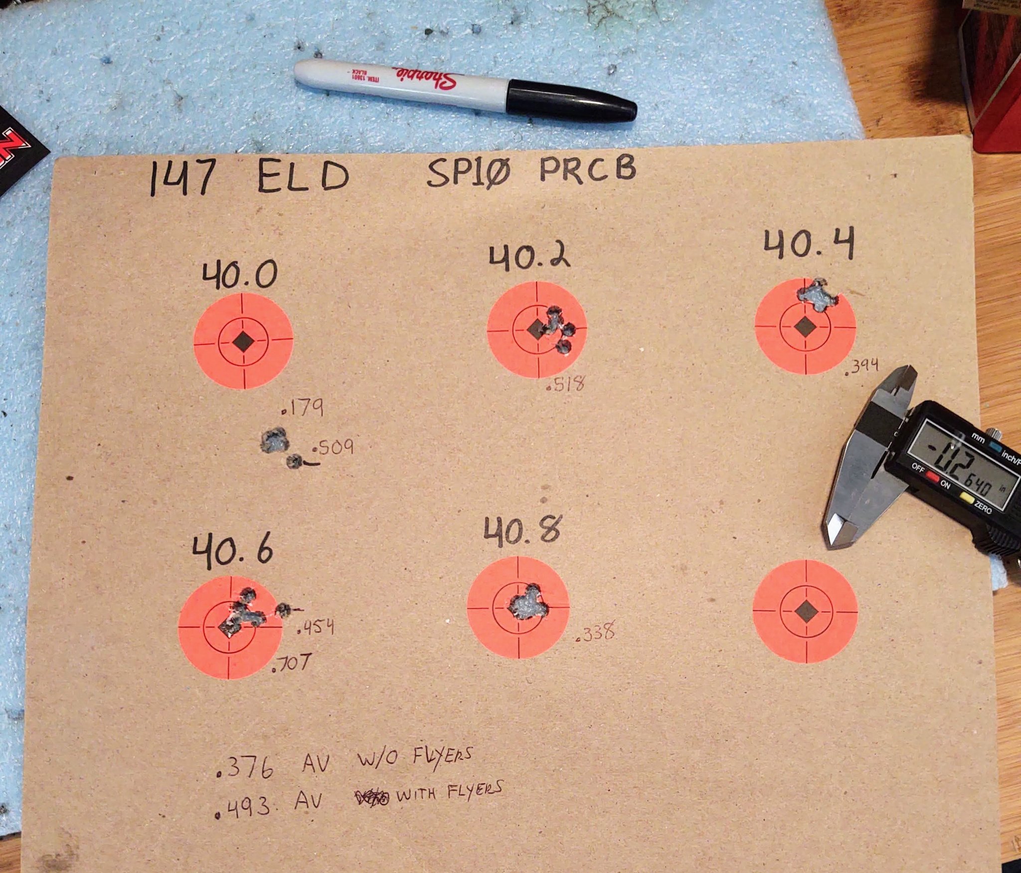

24" Proof Research Carbon
147 ELD/ 40.8grs H4350 / Starline Brass / FGMM 210M

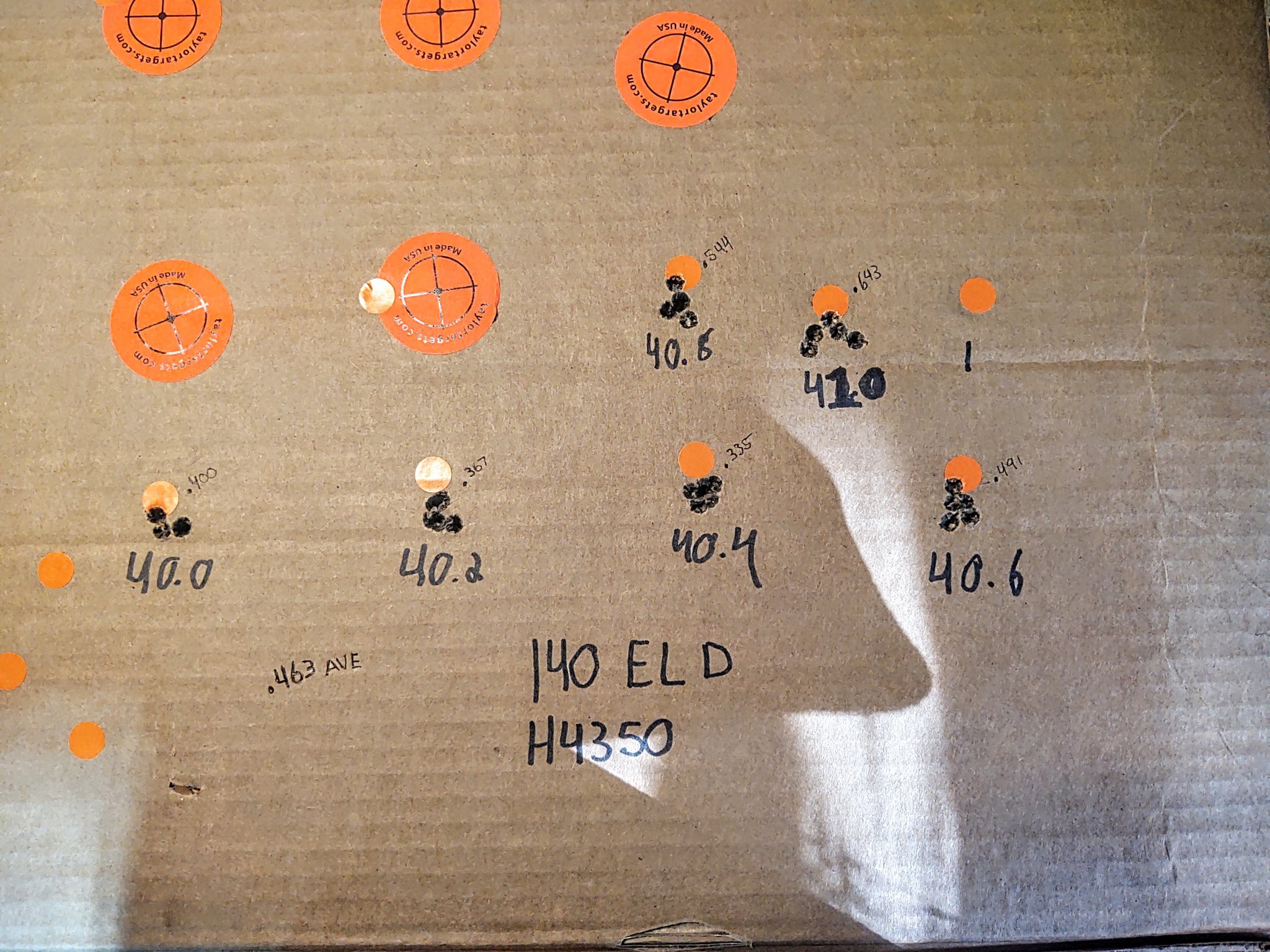

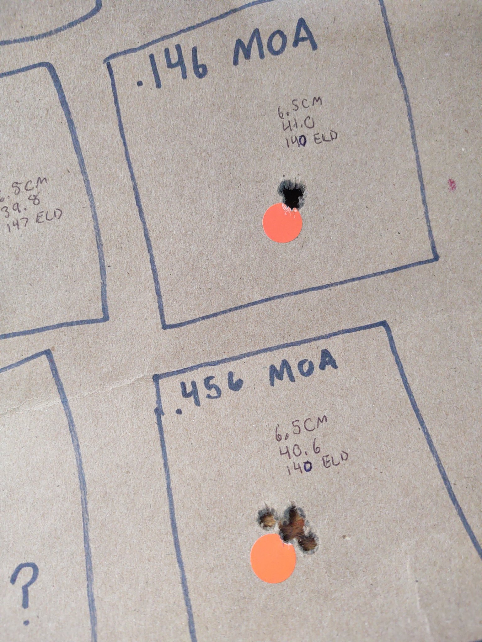

140 ELD / 41.0grs H4350 / Starline Brass/ FGMM 210M

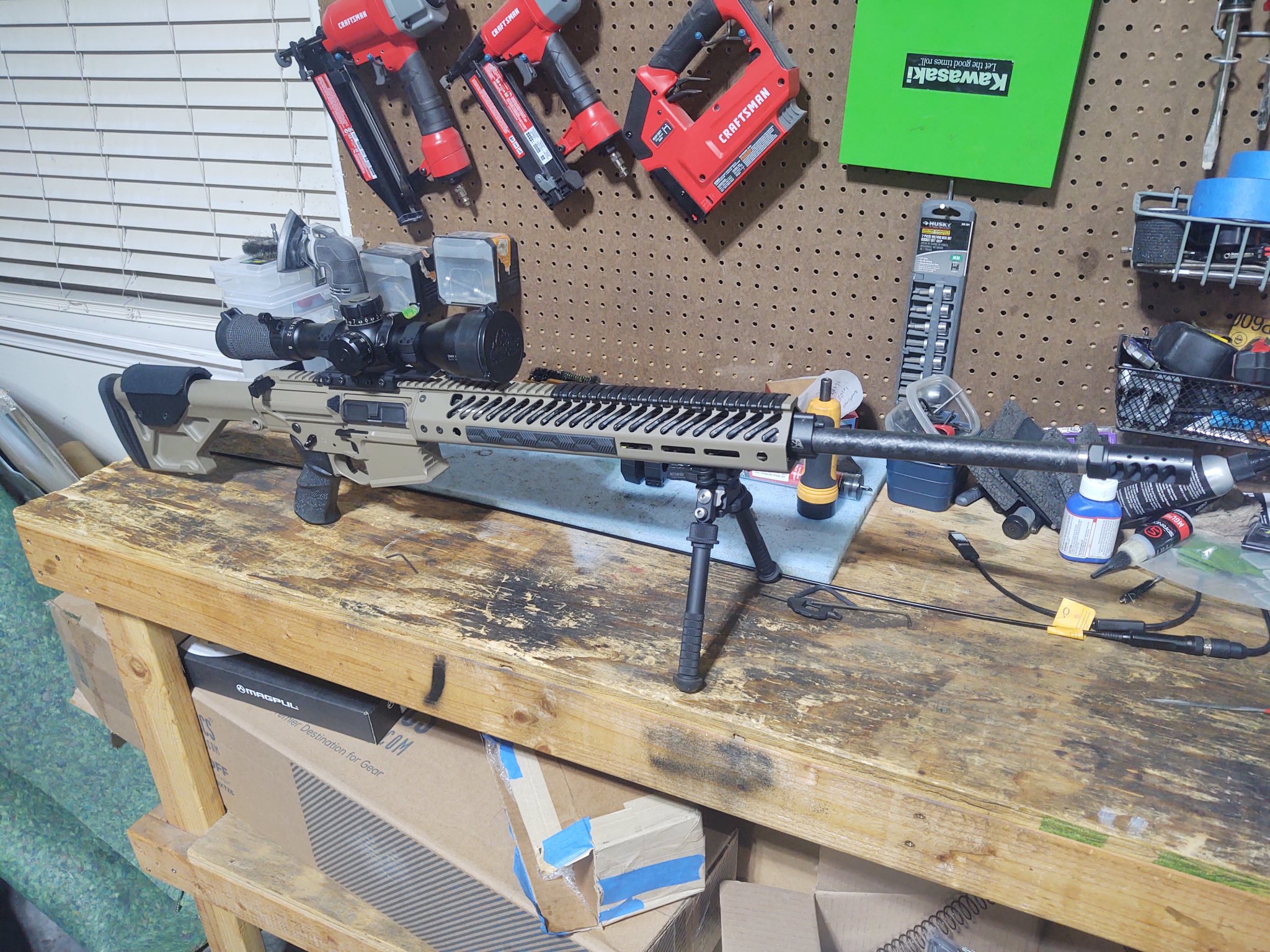

I haven't chronographed my two new Bartlein 6.5 CM barrels yet, those are 18" and 22". I've just started load development on the 18" that's in my OBR and its showing promise for the first round of load development.
