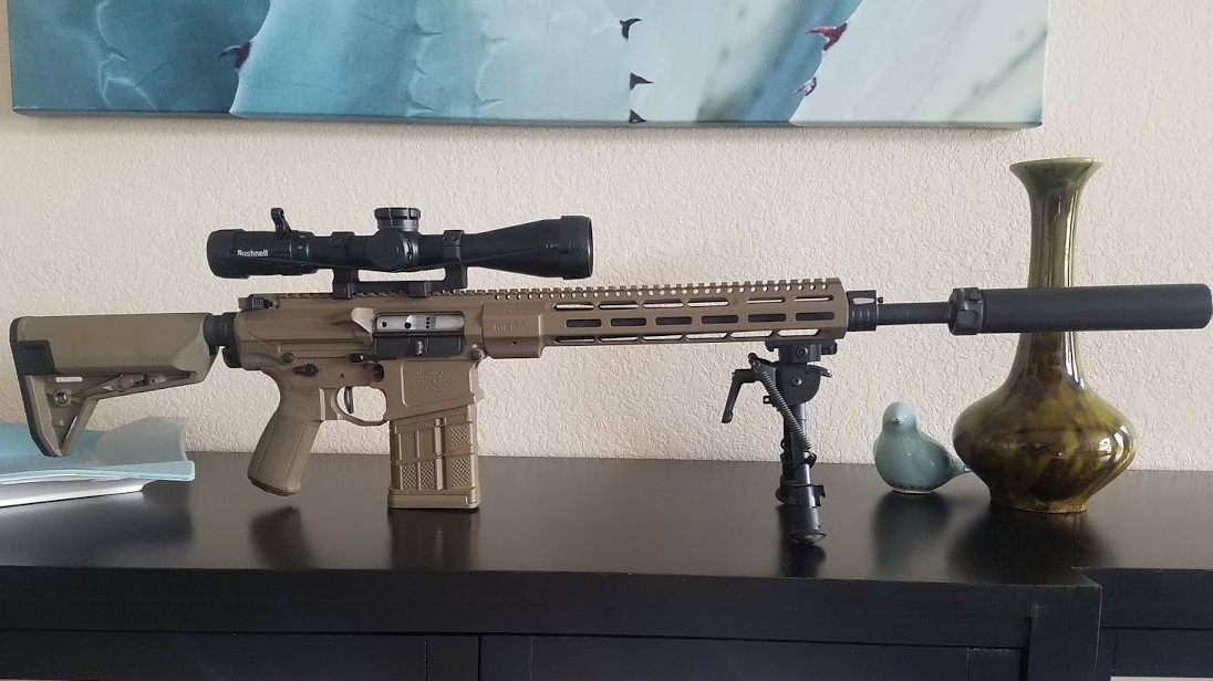

You pretty much just described my rifle! Only difference is I used a LMT MWS BCG and a MWS spring and buffer in a KAC tube. As pictured, with optic, mount, bipod, and suppressor it was still less then what a SR25 would have cost me. Also goes bang every time I pull the trigger both suppressed and unsuppressed. Makes a hell of a knick-knack too.
