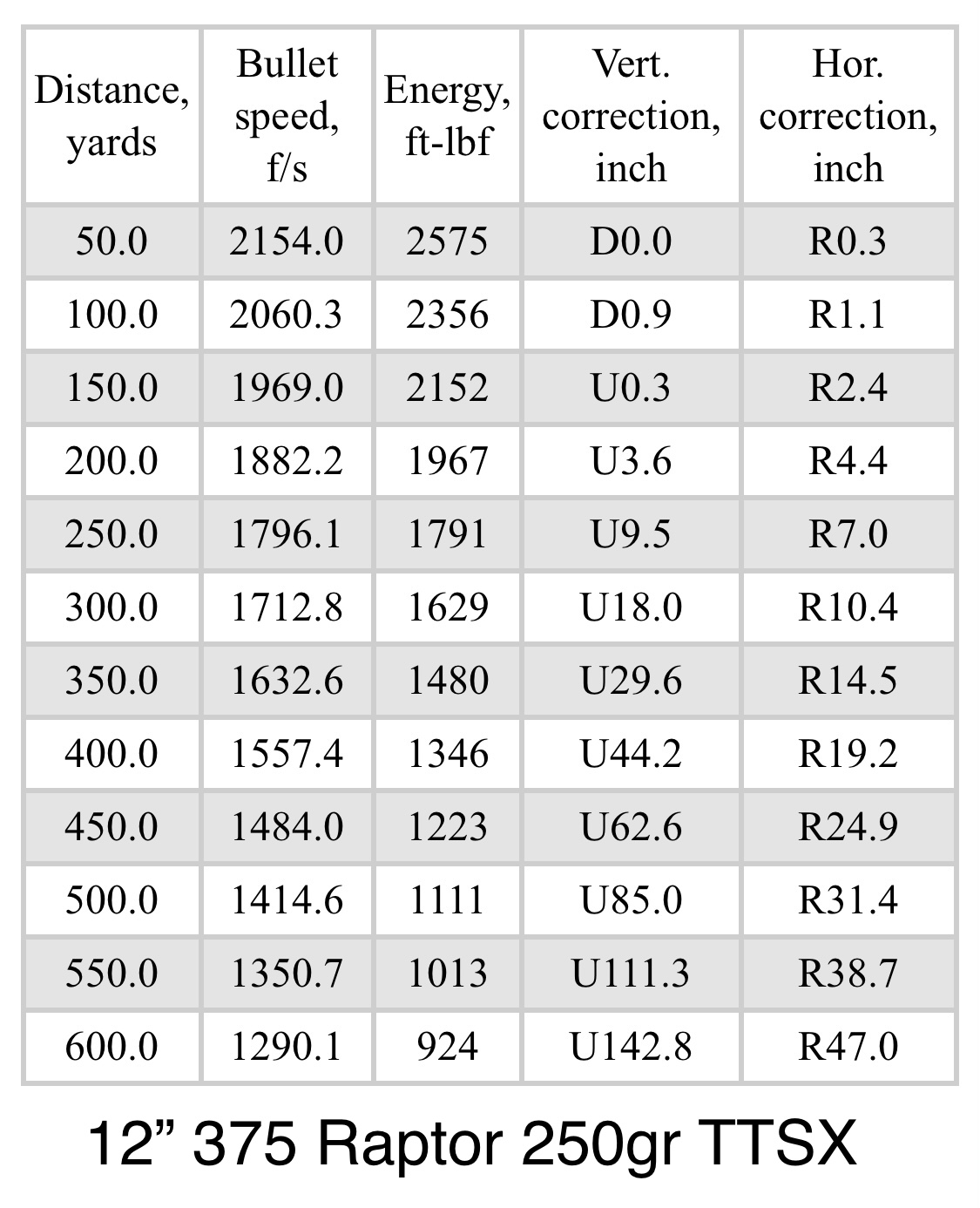

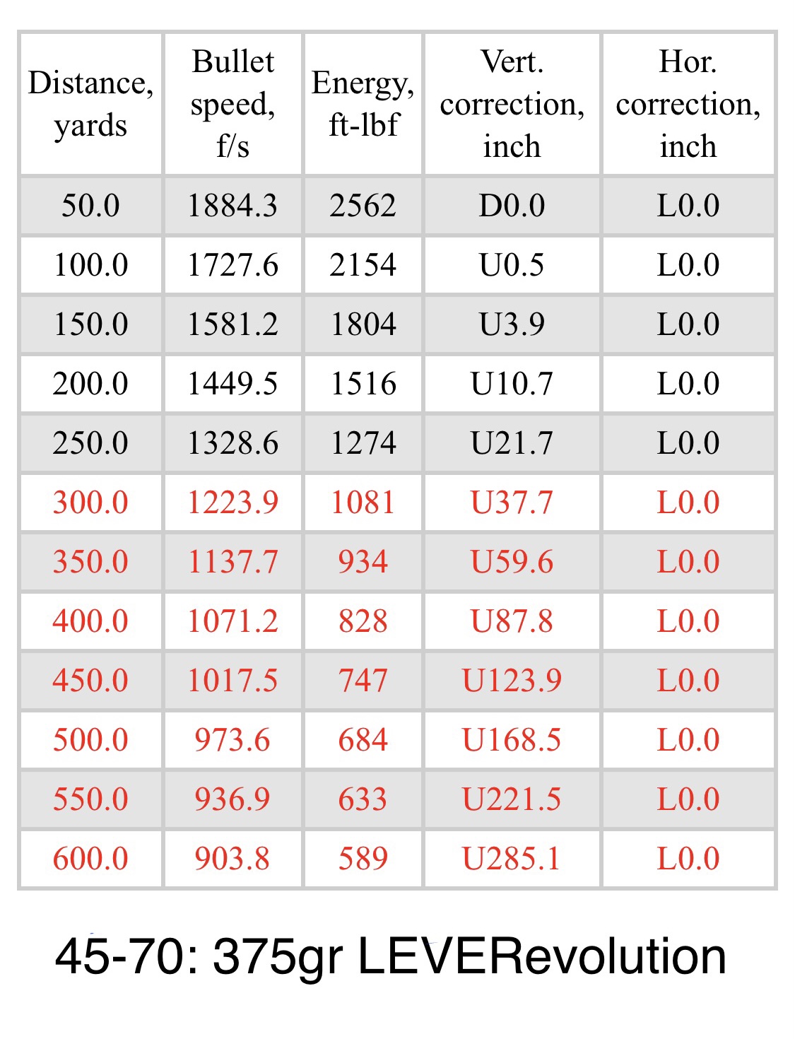

.375 raptor was an option too
I don’t have one yet, but that’s what popped into my mind. I keep debating getting a Browning BLR in it. It is pretty neat. Similar energy to an original 45-70 up close, but then extends that range.

I’d be getting a bit more speed out of the raptor too runnning a 16” barrel….

After looking at the raptor website, given all the other recommendations, that’s the direction I would go. It’s not a great coyote rifle, but you already have that covered. That 375 Raptor with a 260 Accubond is impressive.

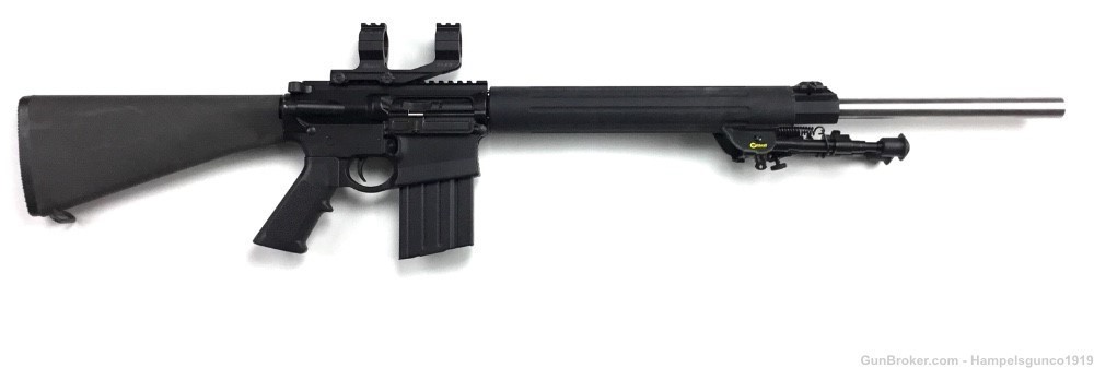

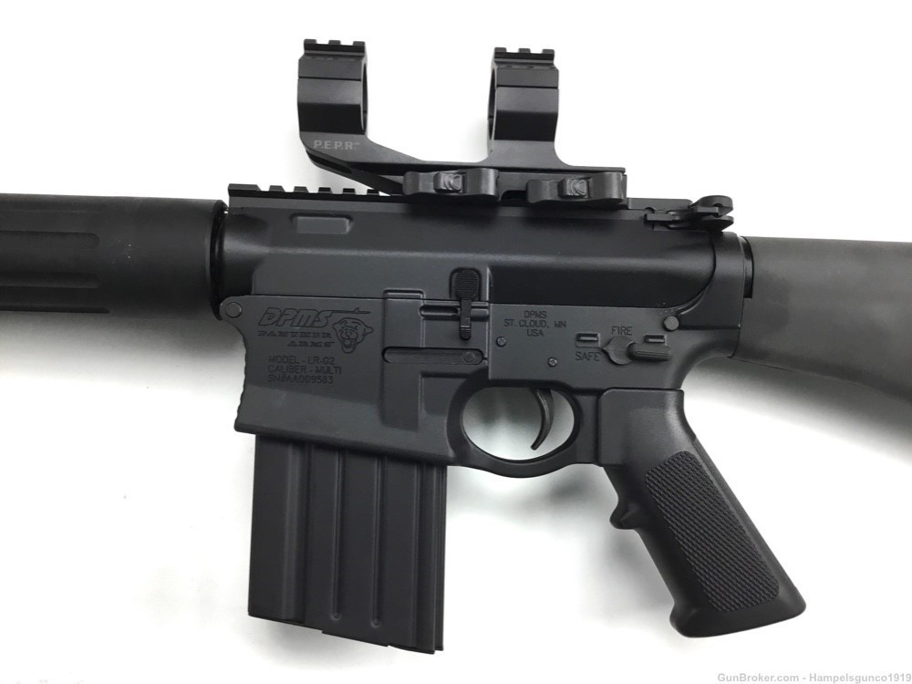

.260, .270, 284 7mm-08, or how about good old .243, or a 308 G2 if you can dig one up, frames closer to an ar15, and std with 24" stainless bull. they also came in a lot of odd calibers, and no matter what some people say the quality is superb. a triggers all you need change
