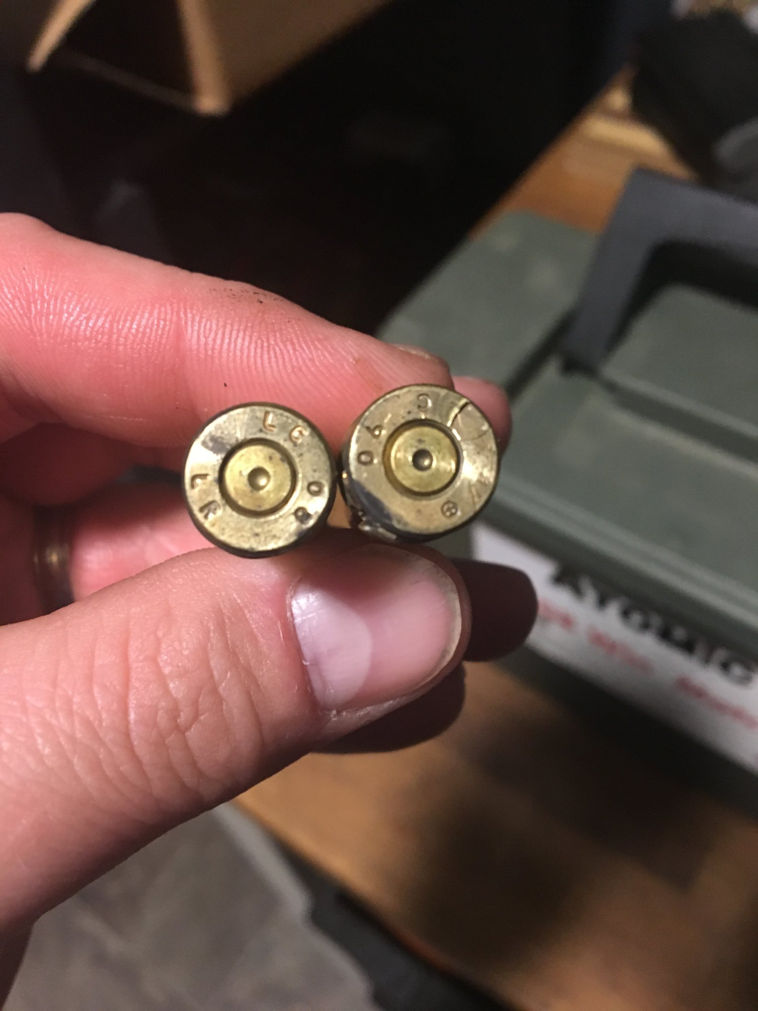

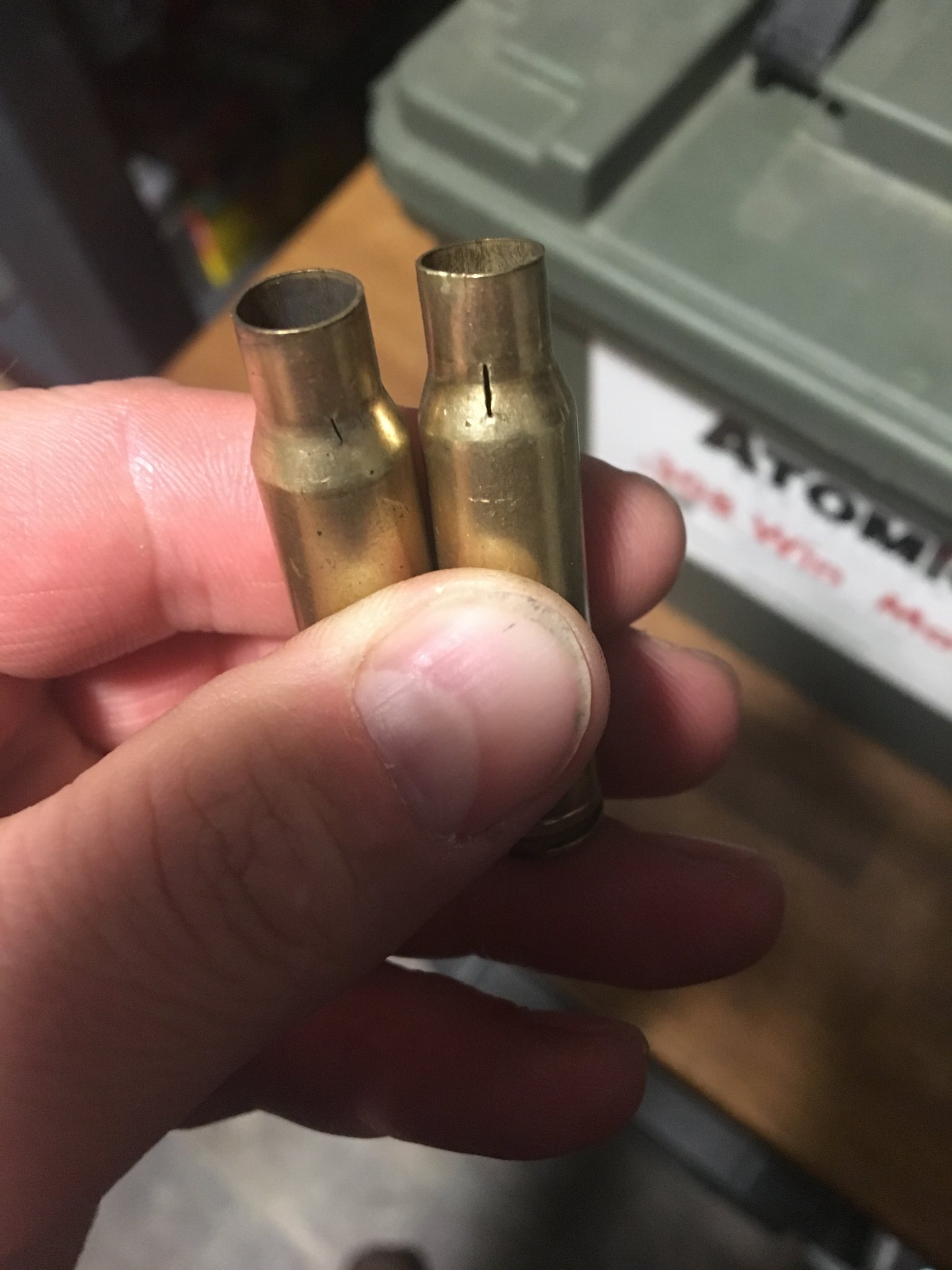

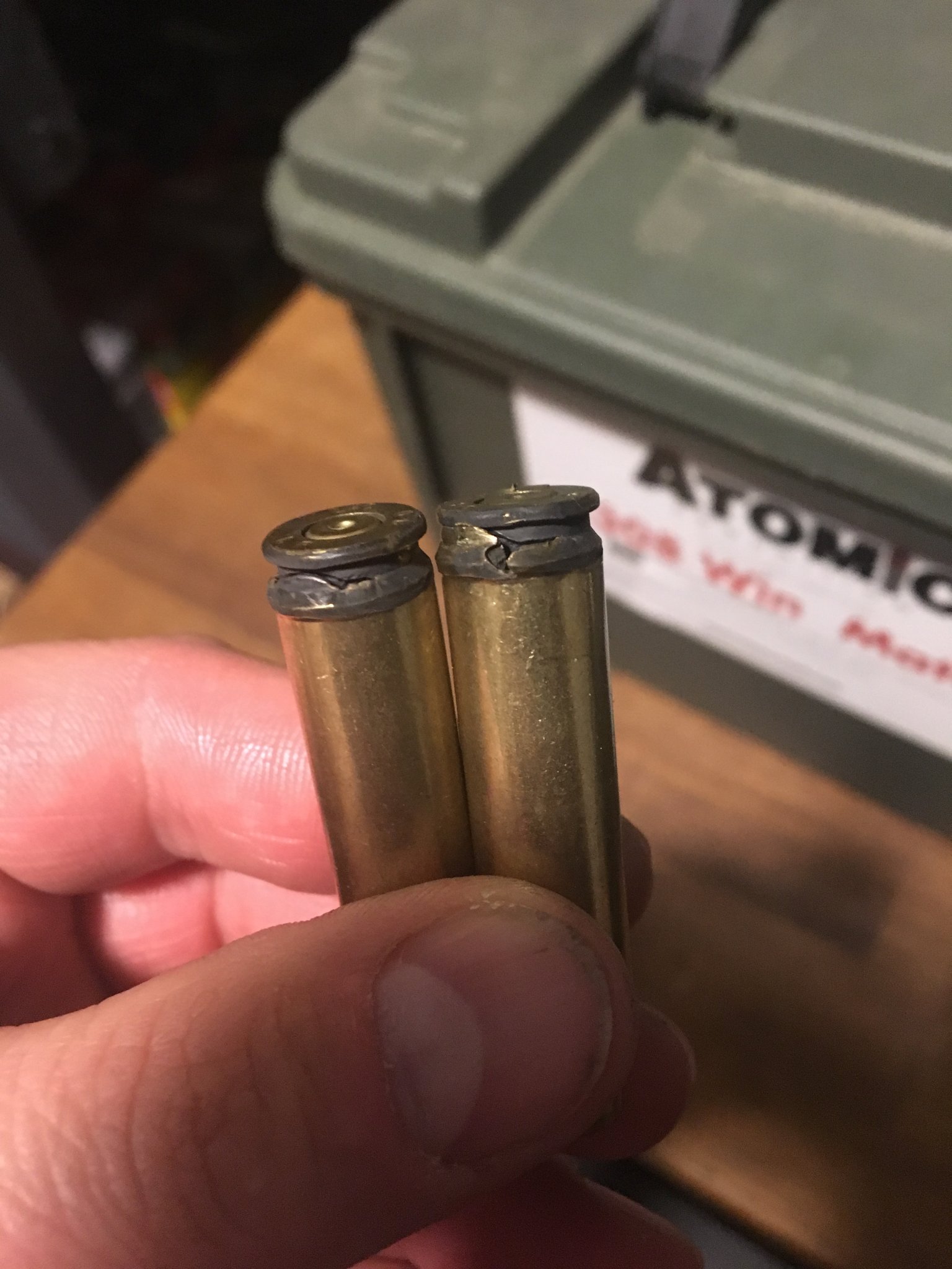

Hoping for a little help/advice diagnosing something that happened to me today while shooting.
Rifle - S&W MP10 .308 Win. Since my last outing the only changes to the rifle were a new scope (Vortex Strike Eagle 1-8x), and a JP SCS (1 tungsten, 2 Steel, medium spring). Other prior alterations are Geisselle trigger, and MI free float rail, and Geisselle gas block, and Area 419 Hellfire brake. The purpose today was to dial in the new scope, and evaluate the SCS.
Ammo - Atomic Ammo 168gr. Factory ammo that is in once fired Lake City brass and using Nosler Custom Comp bullets. I bought cans of 200 count from CMP several years ago.
I fired a couple of rounds normally, and then got one with big blast of gas and smoke and the magazine and guts (Larue) blew out the bottom of the gun. Case head was torn off, and crack on the shoulder of the case. I took down the upper and inspected the barrel and bolt and lubed them up again. I took a couple more rounds from the can and using a different magazine (Lancer), again got couple normal shots, and again big blow out through the magwell with the same case results.
This time I quit. Brought the rifle home and cleaned it, besides a lot of brown carbon buildup all inside everything, looks none the worse for wear.
So, please help me with some advice on the potential causes for this... ammo related seems likely to me, but I’ve been shooting this stuff off and on with no real prior problems. My only other change as I mention is the SCS. I don’t think that is the culprit here? Should I try lighter or heavier spring on it? Change the weights? I really don’t think that has anything to do with it though? But - again, please help me with some thoughts.
Thanks.

I would do a web search to see if anyone else is blowing up that ammo.
Also, think about how it was stored. If it was subject to a lot of vibration that can change the burn rate of the powder.
The recoil system shouldn't cause a problem like this but did the blown cases extract and eject? Any extractor marks on the rims?
If you had a recoil system so light that you got extraction while the chamber pressure is still high, that might rupture cases but an SCS with a full weight bolt is pretty heavy.
My money is on bad ammo.
I would carefully examine the bolt lugs before firing again, maybe get it magnafluxed to see if there are any surface cracks.
measure shoulder against other fired maybe slightly out of battery. with that split neck / shoulder have to bad brass . I once turned the neck too far on my bolt gun my case heads started to blow out
Well it’s certainly atomic lol.
Looks like out of battery or lack of case support to me. Change to SCS is a major clue but it could still be the ammo. If the headspace is shorter than that of the ammo is could certainly be doing it but that’s highly unlikely.
Regardless I certainly wouldn’t recommend shooting that gun or that ammo without figuring out for certain what’s causing it or having it professionally inspected.
Reactions: djarecke
I don't have a calibrated eyeball to tell very much from the pictures.
Case head separation without signs of severe over pressure (although those primers look pretty flat) would get me asking "once fired in what?".
Only time I have seen that was when I was shooting some multi-time fired Federal brass that had been neck sized only a couple too many times and in a different rifle from which the original firings occurred.
I would get out the calipers and start checking all that brass and get out the head space gauges and check your chamber to be sure about head space in your rifle. Quite possibly a chamber cast and measurement could be in order.
That cracked case is particularly disconcerting. Are you sure the brass is only once fired? It could be a die setting was off and bumped the shoulder way to far back.

https://www.snipershide.com/shooting/threads/lr308-failure-to-feed.214109/
OP, take alook at the link above.
I experienced the exact same types of blown case heads just prior to my rifle finally refusing to feed.
The ejector retaining pin was worn causing the ejector to protrude ever so slightly.
Pull your bolt apart and look for worn, irregular parts. There likely isn’t anything wrong with your ammo.
