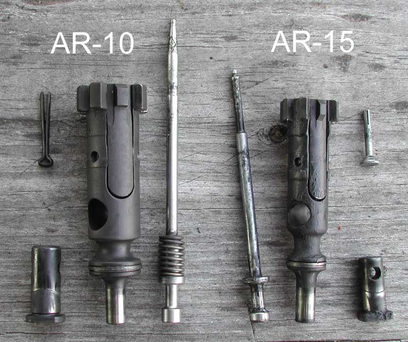

Not totally correct... While DPMS pattern AR-10s do not have a firing pin spring, Armalite AR-10 rifles do have a firing pin return spring. The OP didn't state if his rifle was Armalite or DPMS pattern.
Also of note, Armalite uses a small diameter firing pin (0.062") that is much less prone to cratering and piercing primers compared to the DPMS firing pin (0.078".) Hence why several manufacturers came out with "high pressure" small firing pin bolts for the DPMS-pattern AR-10's that liked to pierce primers when chambered in .260 or 6.5CM while Armalite AR-10's didn't have the same problems.
I don't have my Armalite anymore, but here's a pic from Google...
