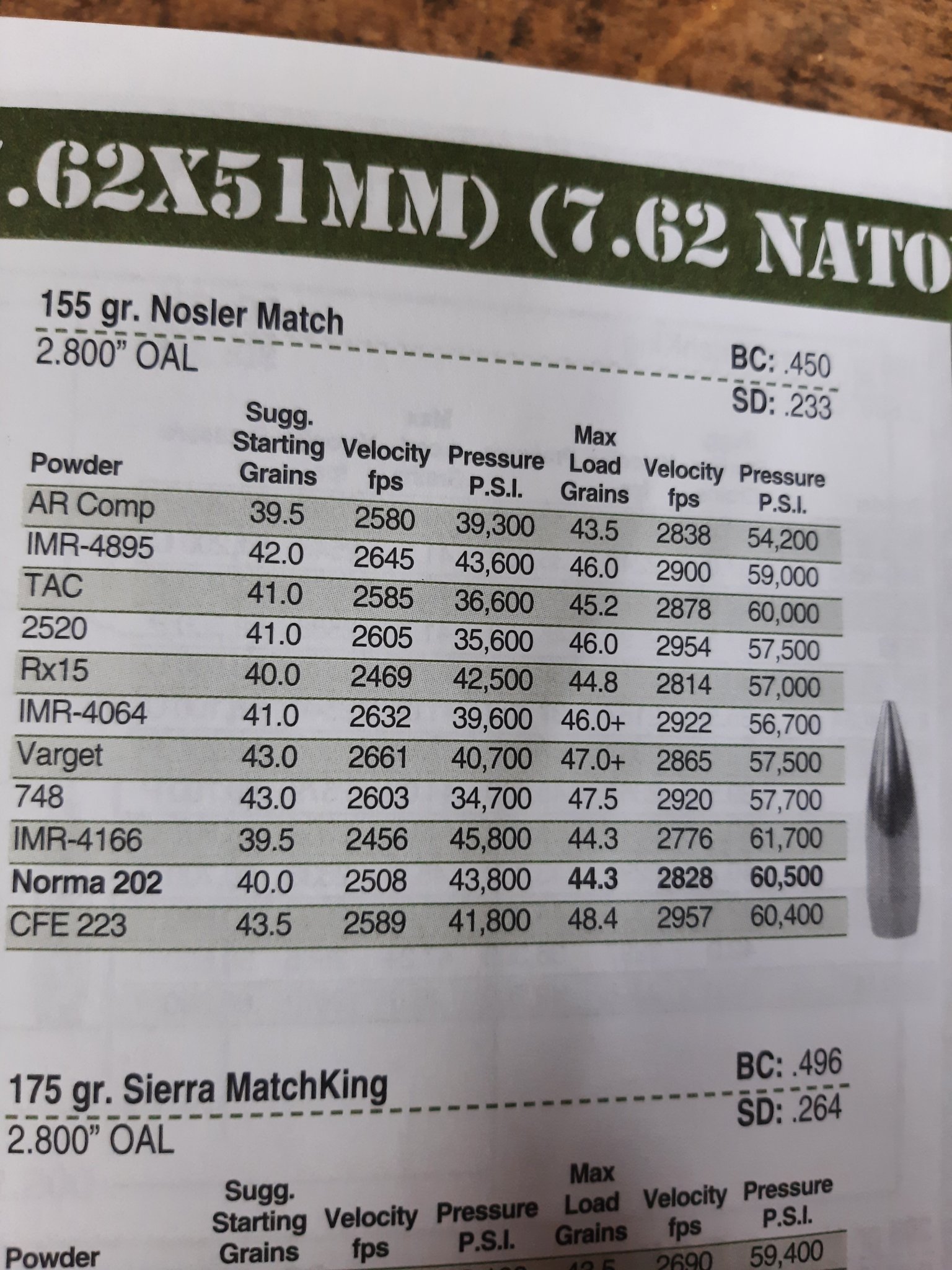

You maybe right. I looked on Hodgdons reload site, and for service rifles they recomend a max of 44gr!! I do not think that my manuals specify service rifle vs bolt gun, so I think I just worked up to a good group with the max load being 47gr. That is kind of a bummer, as I just loaded up another 50 to test fire with the new spring/ buffer. I guess I need to pull these and rework a load? That being said, it still does not function reliably suppressed with FGMM suppressed.

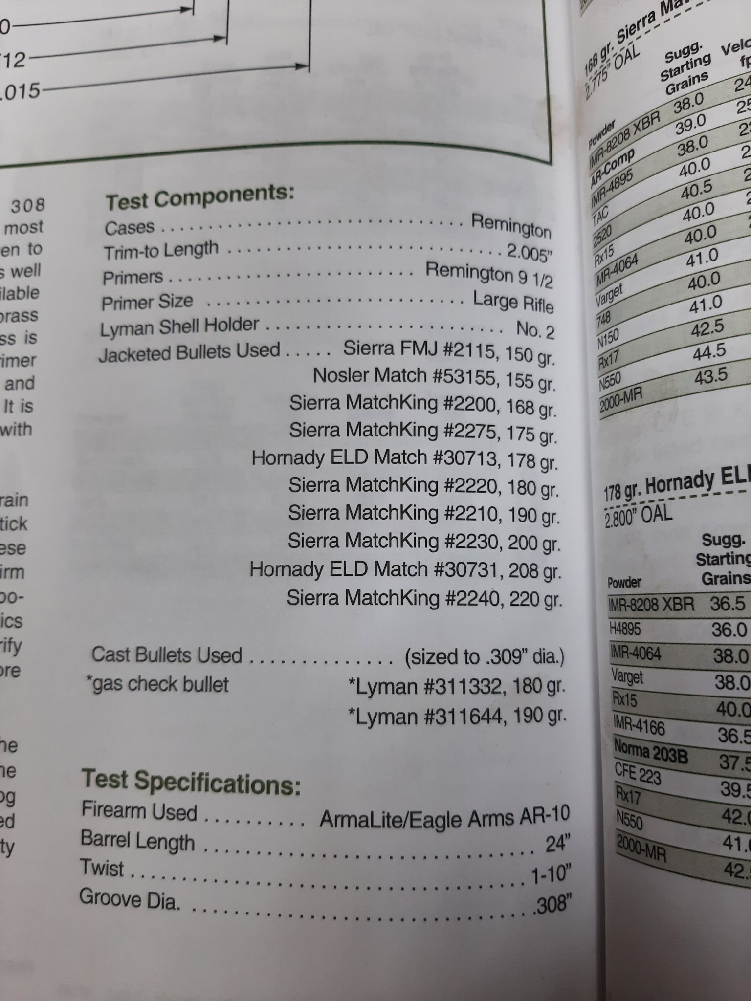

Here's what Lyman says. I normally trust them but this does look a little extreme for ARs. Also even though they used an AR10 for testing it had a 24" bbl. Not too much help when you're running a 16 or 18.
Interesting. The Nosler and Speer manuals both also claim a max of 47gr. My rifle has a bull Wilson Combat barrel on it. I did have 1 blown primmer last time I took it out, and when de-primming, the pockets felt a little loose. Guess Ill pull these rounds and work it back up.
I looked over my notes and I think what I was trying to do was push a 155gr 308 as close to 3,000 FPS. In my ballistic app this shows a trajectory similar to my 6.5CM shooting 140s, and used bolt gun data.
