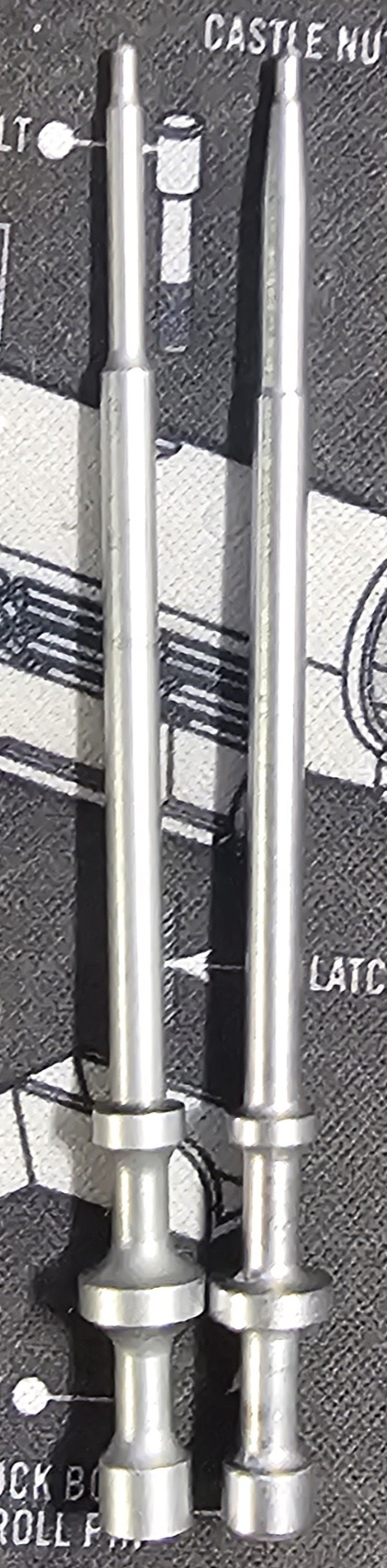

I put together a mostly Aero gun with a BA barrel and Aero bolt, Aero upper/lower. Getting light primer strikes every once in awhile, 3-5 out of 100 and then after a couple hundred rounds 1 or 2 per 25 round mag.

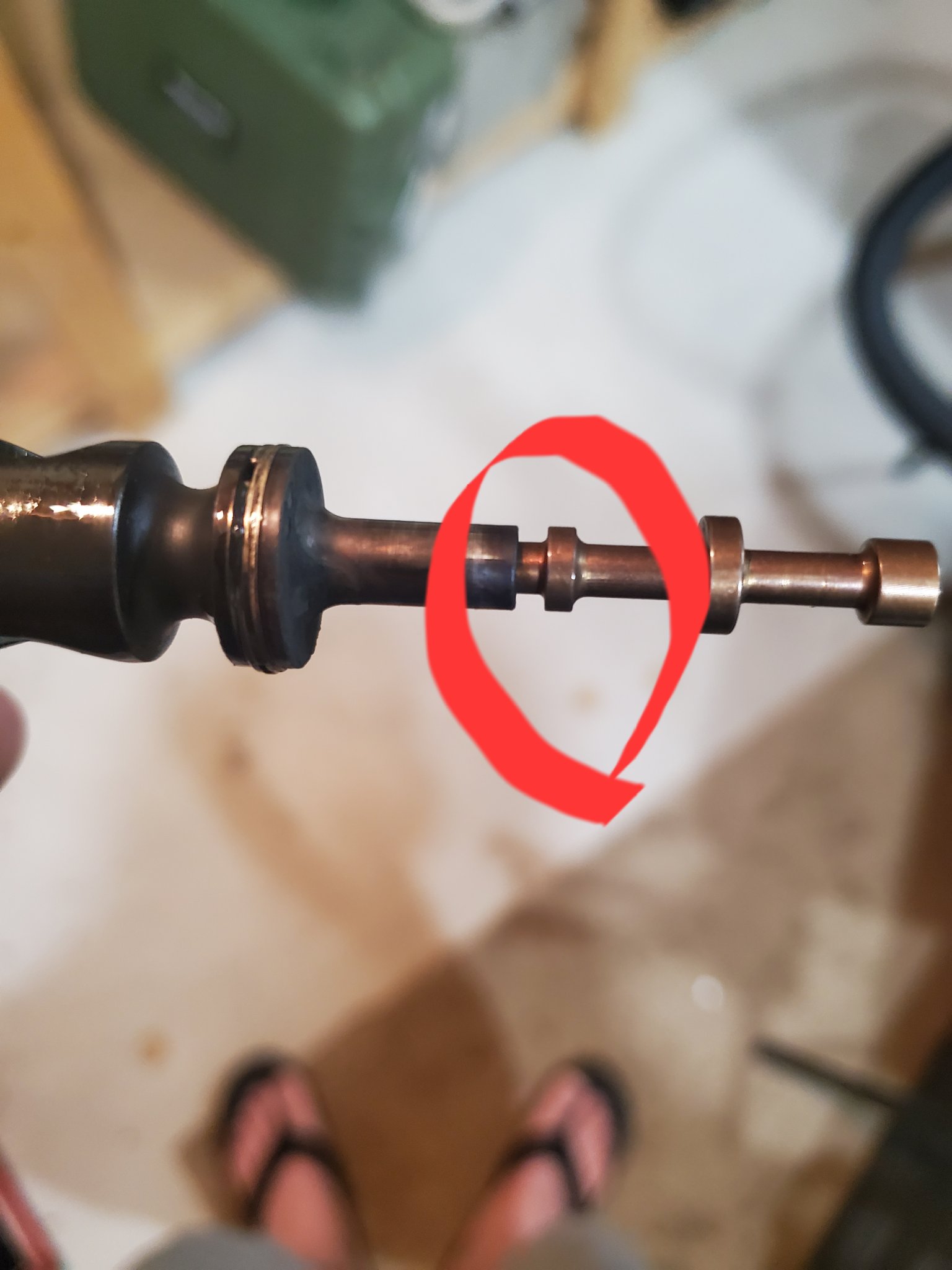

I bought a cmmg firing pin (darker colored pin pictured) which is a touch longer but won't go all the way into the bolt because of the back end diameter of the firing pin hole in the bolt.
Wtf

I can't quite tell... your first photo, is that a tapered FP ? ( Sure looks like one )
And can you measure the diameter of both FP's at the end of the longest shank, by the smaller collar ?
I can compare that measure measurement to what I have on hand .

I will have to check/do that when I get home today. The first silver pin the the Aero one that came in their nitride bcg.

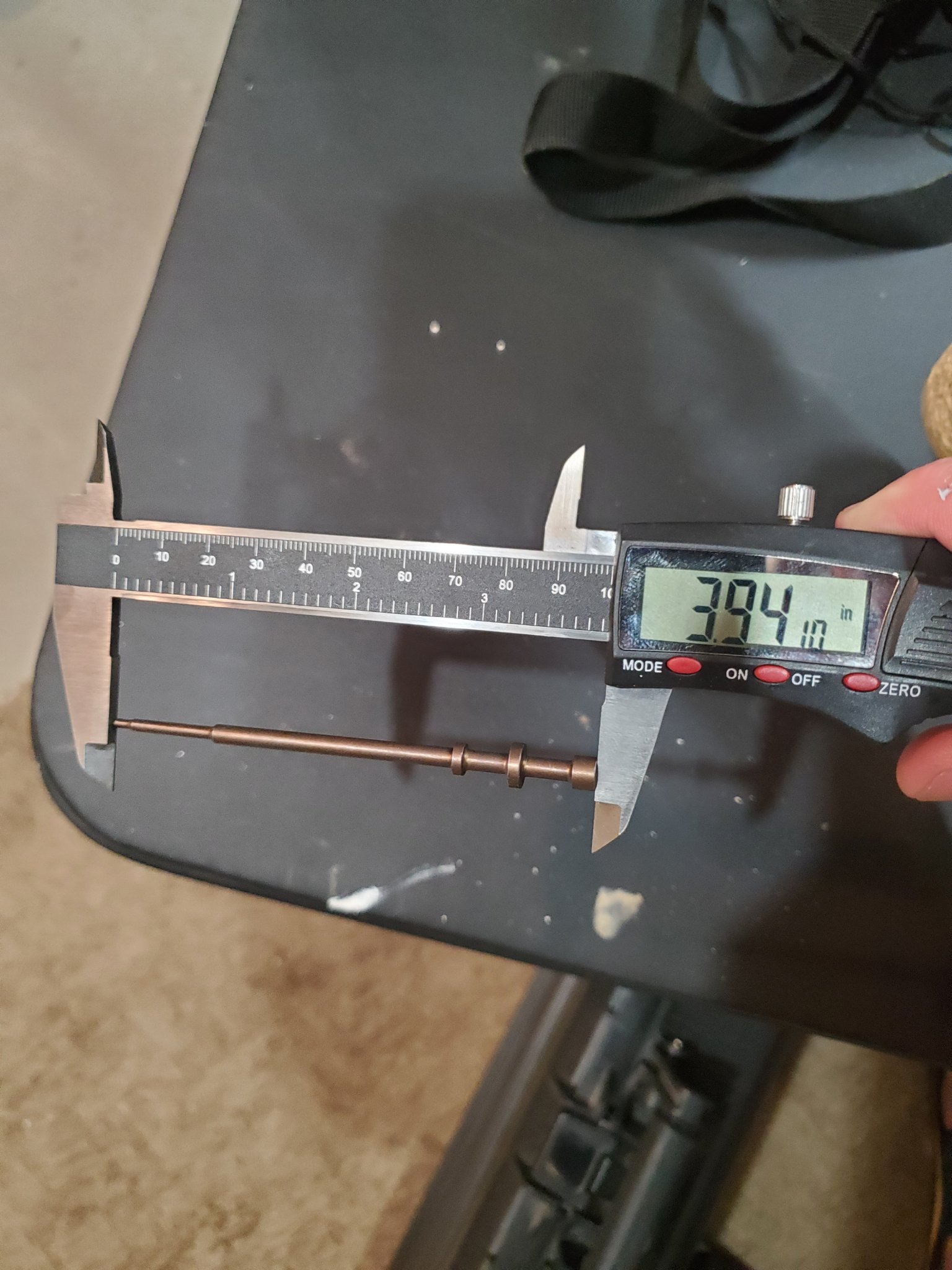

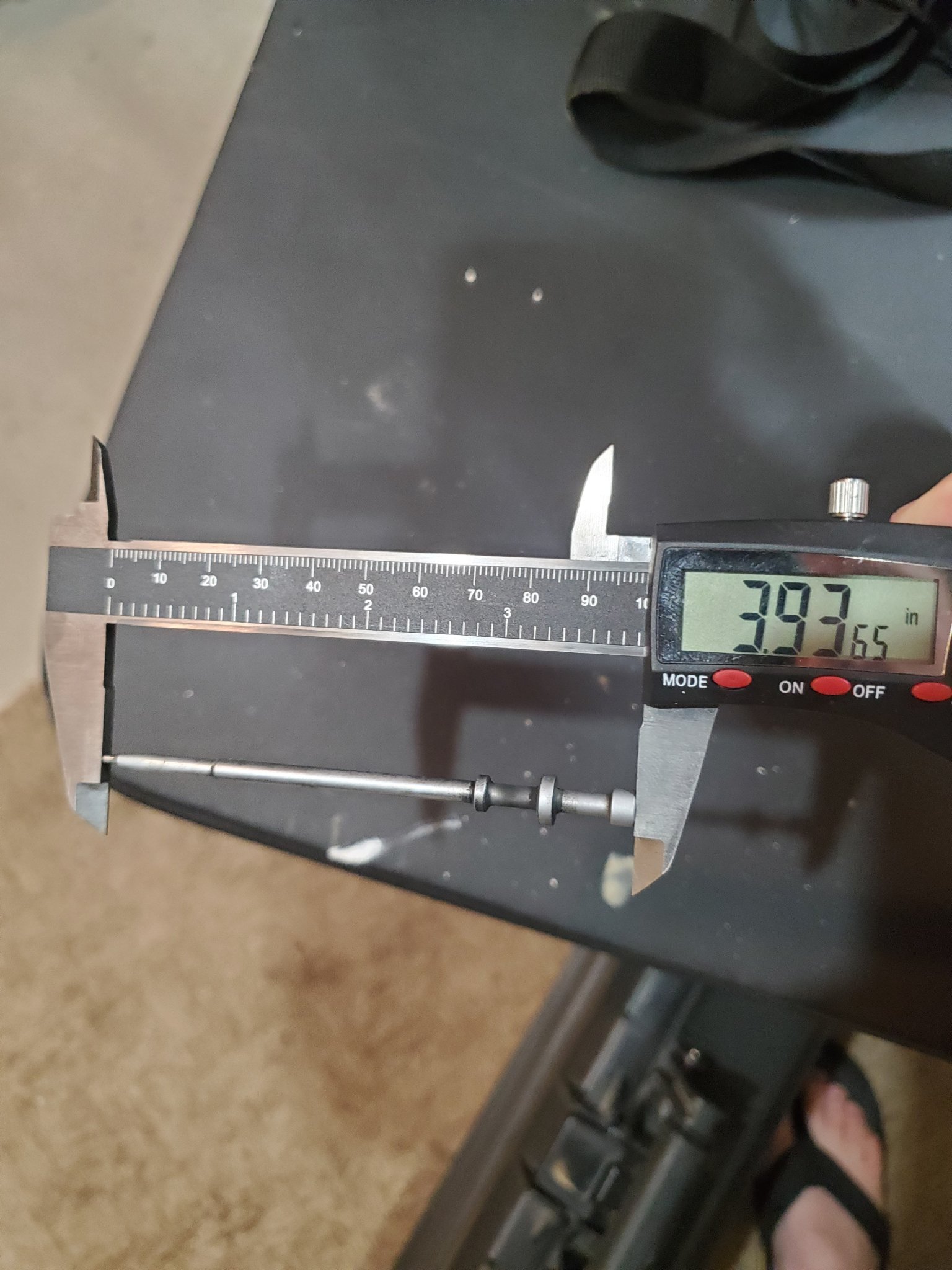

I think I may know "why" the CMMG FP won't seat all the way.
The Tapered FP's I have on hand , have a SD .068" tip size, ( both KAK and Azimuth , Aero ( in some of their BCG's ) and Craddock use these for sure as well as a few others ) and a shank size of .1525- .1540... most were of the 8 I checked were .1530".
So most likely just variance in the chrome thickness.
FWIW... the longest Tapered FP was 3.937", the shortest was 3.936"
The CMMG FP, like the one you bought, .074" Tip size. So it probably can't go through your Bolts FP hole. Shank size was a consistent .1525" for all 4 of them.
OAL, was also 3.938"... probably just a insignificant difference between yours and mine.
To find out if that is the "issue" ... try sticking the AERO FP tip in through the front side of the bolt face, vs the CMMG FP tip.
As to why you are getting soft primer hits... I am not 100% positive... but, as mentioned earlier, make sure primers are fully seated and maybe the round isn't 100% sized for your chamber , and maybe double check the hammer spring is installed correctly ( The correct side up )
