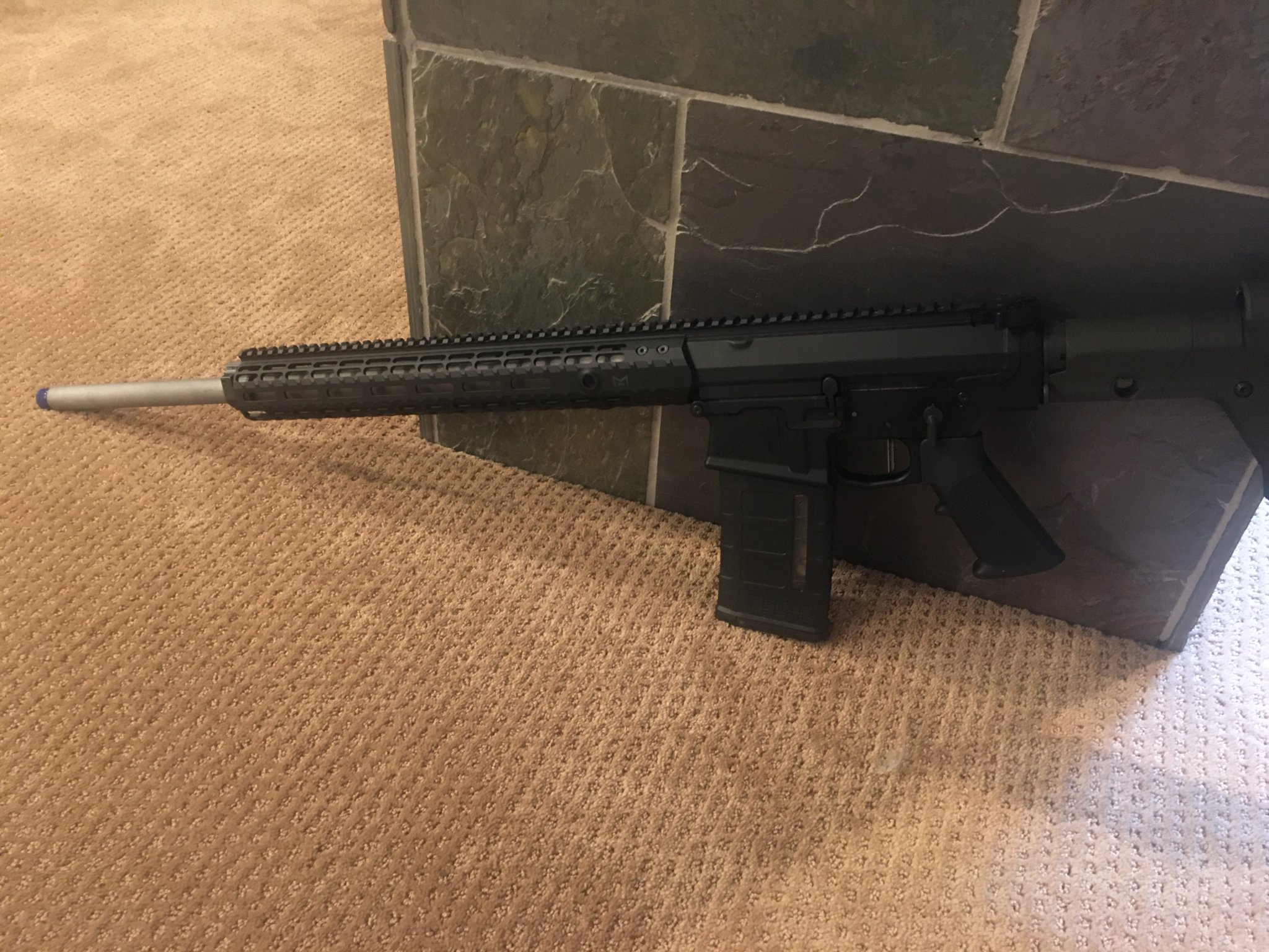

Just finished an upper for my A.R. 10 one and seven twist 24 inch barrel it’s barrel by rainier arms Issue I have right now is the lack of powder selection for larger heavier bullets
Reactions: 232593
Varget, Tac,big game H380, Superformance, and a few other shooter world powders that were designed for the 6.5 Creedmoor , and some of that Vivitori stuff it was made for the 6.5 Creedmoor I believe it was N555...
So I’m not sure how I’m going to sling these pills down the range in 7twist.
Ideally it would’ve been a 8 twist barrel.
I may send the barrel back and pick up a mcgowen 1/8....

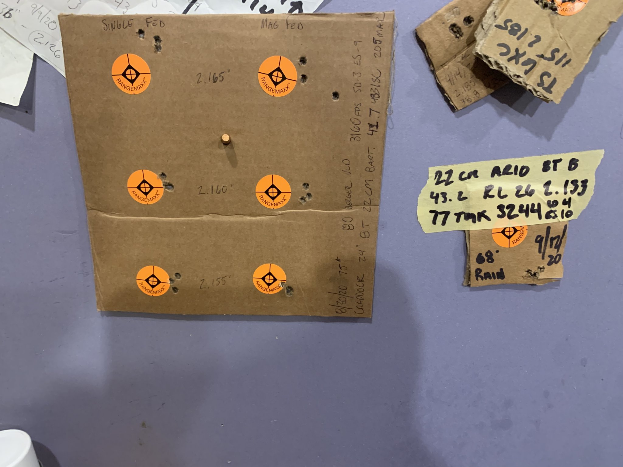

I built a very legit 22CM for night hunting last year. I did load development and it shoots phenomenally well, but I never bought a thermal scope for it. It’s sitting in my safe collecting dust. If you’re interested in it I would sell it.
