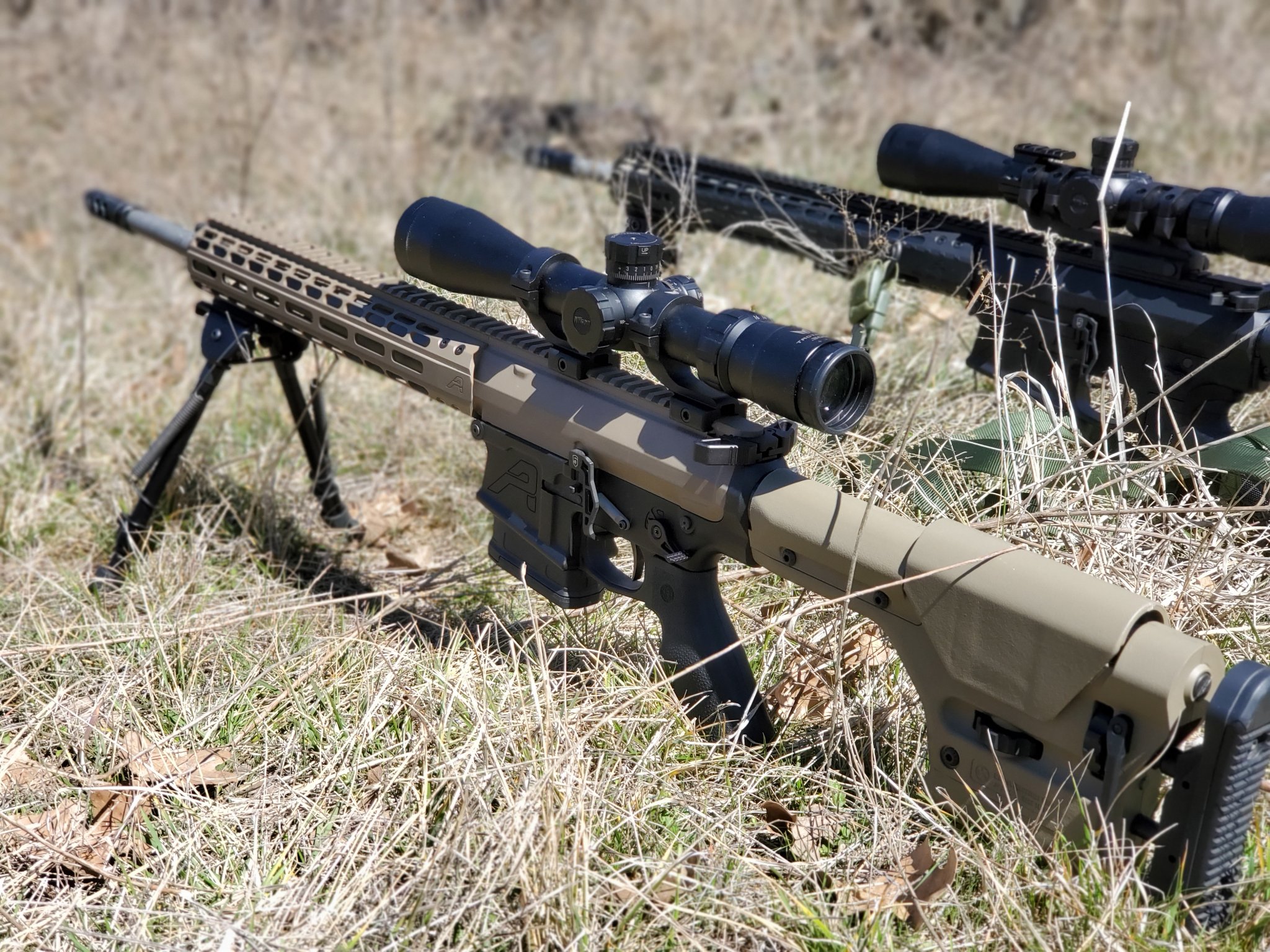

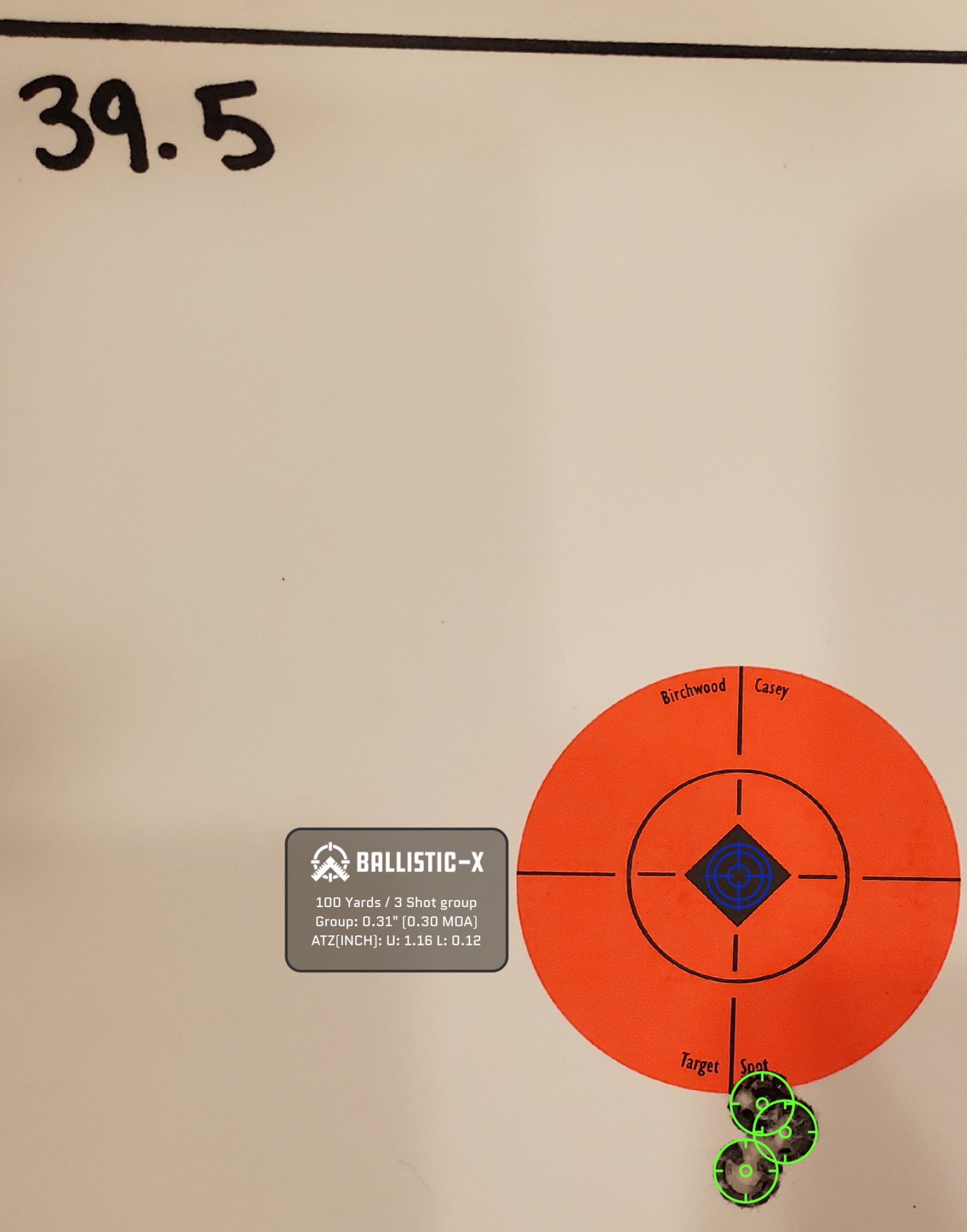

I have an aero m5 upper with aero 18" ss barrel and its a decent shooter. I am currently shooting 178gr eldx with varget.
Ballistic-X-Export-2020-04-21 20:56:49.126294.png

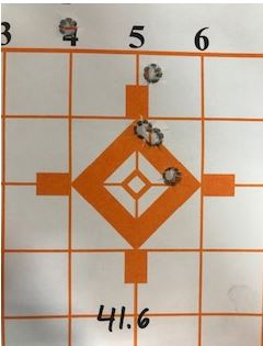

I am more accurate with bolt guns. I've been shooting gas guns for many years, but mostly M16-A2s with iron sights at pop-up targets out to 300m. This is my first large platform AR. The attached photo is typical of the groups I've been getting. The flier in the "4" was me. The other 4 shots were good (at least I thought they were at the time :) ). I use proper form, breath control, trigger squeeze, etc.
The rifle was way overgassed when I got it. I added a Superlative Arms adjustable gas block and it now ejects at about 3:30. I also added a VG6 brake. Rifle has a carbine length buffer tube with a standard DPMS 308 buffer and spring. It's an M5 with a freefloat handguard that has 8 screws to attach the handguard to the block at the front of the receiver.
I've been running Hdy 168 Match bullets over 41.3-42.0 gr IMR4064, and Hdy 150 FMJBT at 42.0 IMR4064 both in LC brass. I also shoot FGMM factory 175s and the FGMM duplicate handload - 175 SMK over 41.8 IMR4064 in FC brass.
I had to take the rifle back to the store where I bought it several times because it would not chamber rounds reliably. It is running well now. The gun store has gone through several gunsmiths and was recently seeking yet another new 'smith so I don't want to take it back there. It sounds like my next steps are to get 168 FGMM (if I can find some), have a friend who is a good shot test the rifle, and re-torque the barrel.
