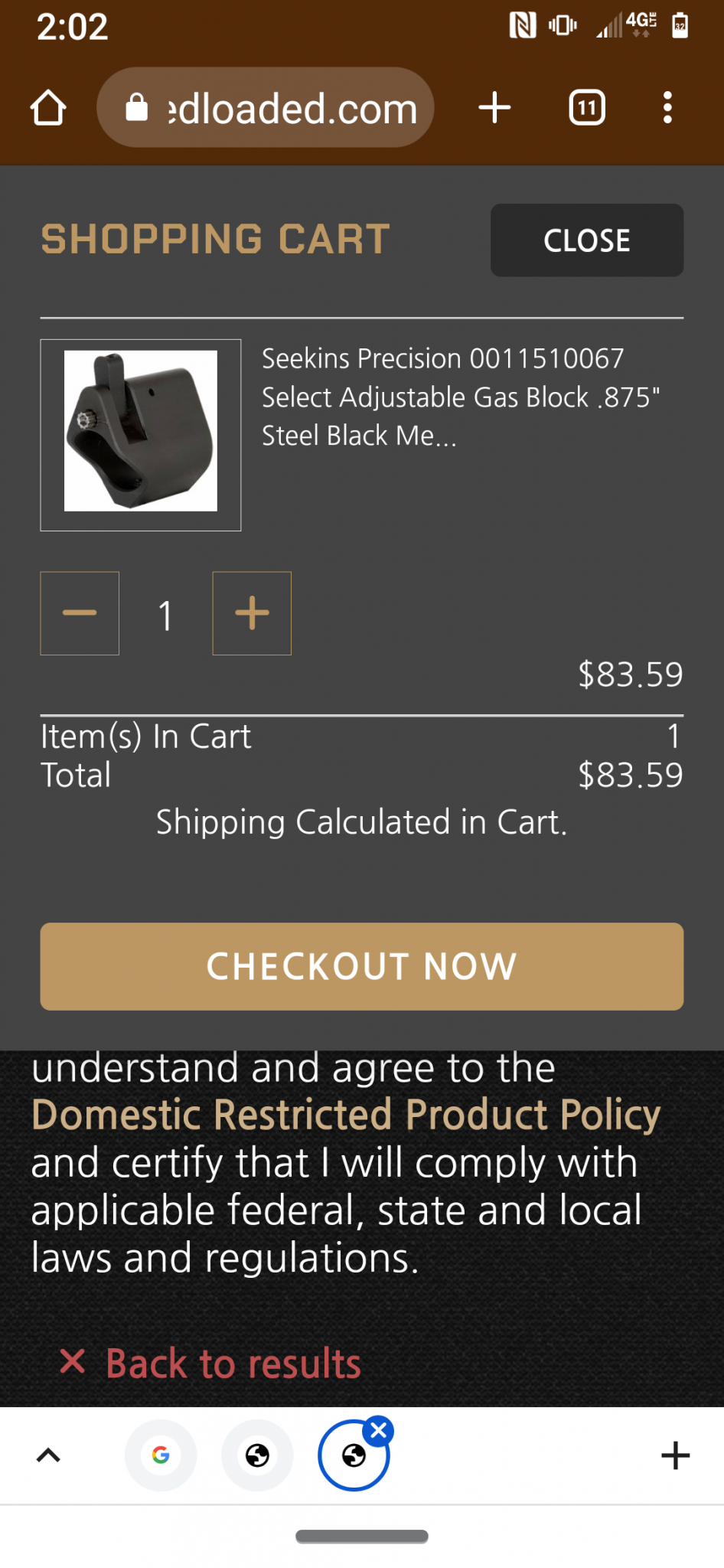

    Probably not an option for you, but the Noveske 7.62 Switchblock barrels come with a selectable gas block. Unsuppressed, suppressed and off. There are other selectable gas blocks for quick gas flow adjustments, Seekins Precision Lever, Strike Industries Collar and the Riflespeed to name a few. Some of these require specific handguard specs.
    Also, if your AGB requires side access or uses stacked or double adjustment/lock screws. consider getting an AGB with a front access detent type adjustment screw and use a long ball end hex driver.
