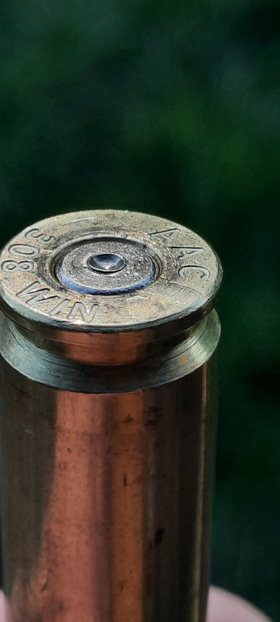

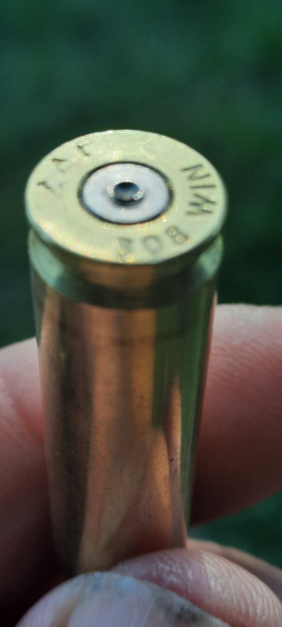

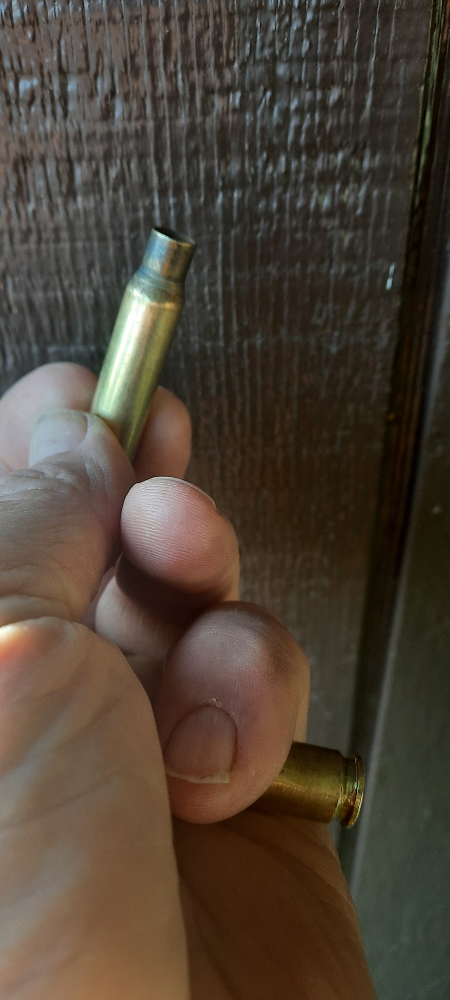

I've got a areo precision self built 308 that I think I might have headspace or other problems with , the parts are areo upper ,lower ,wilson combat super sniper 20" barrel, toolcraft BCG aero buffer tube ,spring and buffer all rifle length A2 type. The gun cycles ok ejects 3-4 o'clock, but all ammo including factory 4 differt types show some signs of over pressure ,flattened primers primers with slight lips around the firing pin strike and what I consider excessive soot or carbon around the mouth and shoulders of the fired brass, and the recoil seems excessive for 308 although I don't have another 308 to compare it to .I was going to buy a field gage, but after reading the literature on the midway site I'm not sure that would do any good , I'll load som pics of fired brass but the soot or carbon has worn off from carrying around in my pocket , these brass are factory AAC 150 gr blk tip at 2700ish fps.anyone have some thoughts on this , the accuracy is less than stellar also barley moa .

What do your gauges say? I'm not sure what the midway site says, but testing a barrel with all three gauges is always a good idea, especially if you're doing DiY stuff, and definitely if you're not using a barrel that has been matched to a bolt.
Looks like too much gas. I don't see anything that suggests too much headspace, just unlocking early. Typically long headspace results in excessive growth of the brass. Your second picture looks like early unlocking ejector smear.

I’m not seeing any evidence of there being a headspace problem.
Your primer blanking is from excessive firing pin aperture size on the bolt.
Notice the nice round edges of the primers.
Your rifle is ejecting at 3-4 o’clock, shooting ~ MOA, and working.
What more can you ask for with an Aero .308 DIY build?
Consider yourself blessed.

It looks over gassed, not a headspace issue. There is a long thread on here about that same barrel. Take a look at it.

As far as the primer cratering, you might try a few different replacement firing pins... I bought about ten just so I could measure the tip sizes, and they varied quite a bit in size.
