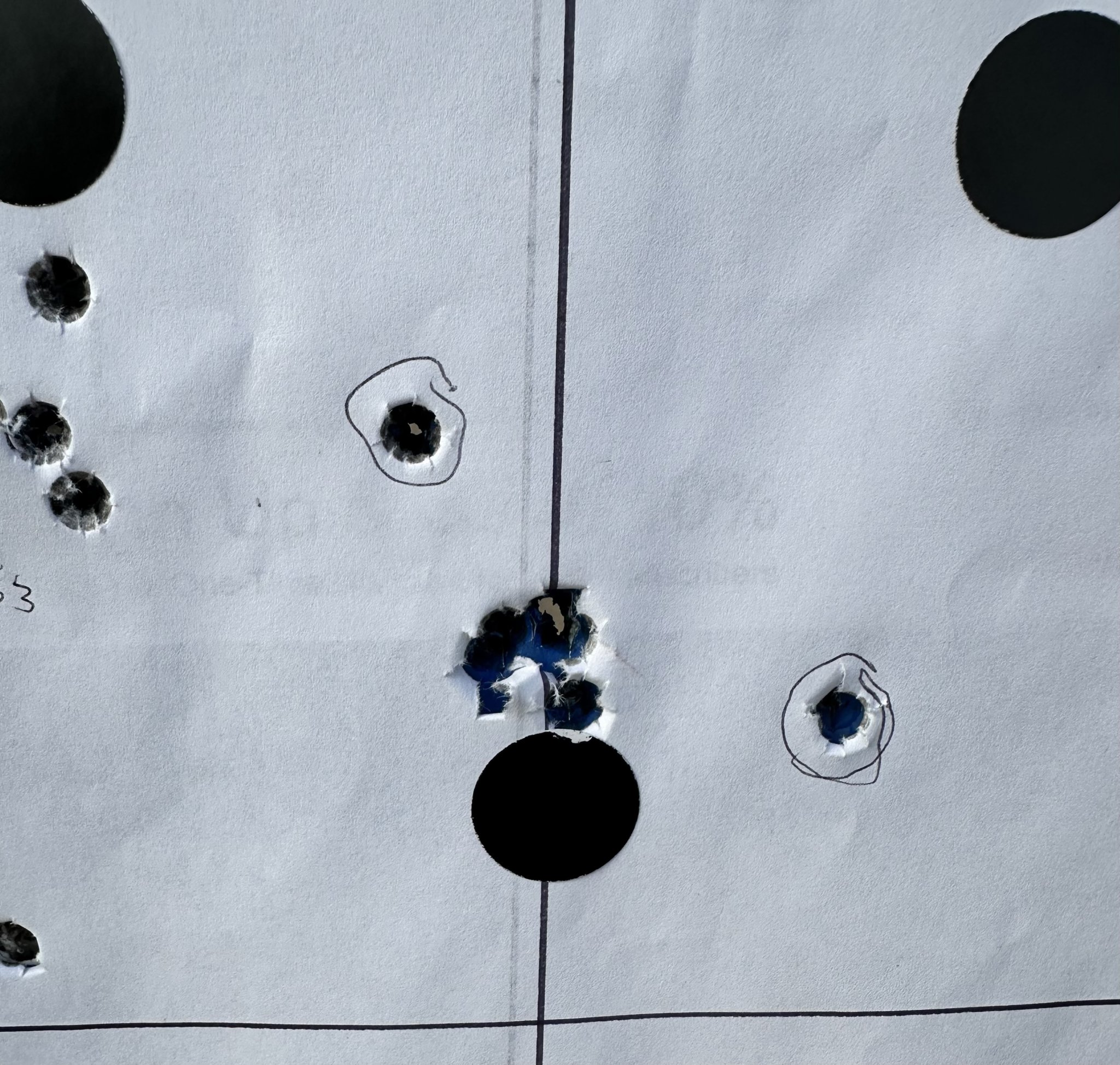

Not to beat a dead horse, but in a word; Fundamentals. Some of Frank's older videos will go into detail about why, but your fundamentals need to be impeccable if you're really trying to get bolt gun accuracy. The components are also important. Given the OP's parts I'm assuming the barrel will shoot, my experience with proof has always been positive thus far.
So fall back on your fundamentals. Loading the rifle, being square behind the rifle, Trigger finger position, pulling straight to the rear with the pad of your finger, breathing (breaking in respiratory pause), and finally what I think is arguably the most important fundamental of a semi-auto; is follow through. You've got three recoil impulses happening during that some odd split second after the primer is detonated. Carrier is unlocking, travels the length resistance of the recoil spring to stop, and then slams home, this requires so much more consistency on your part than a bolt gun.
I'm by no means an expert either. Just sharing my experiences. This is the first 5 shot group out of my LMT with AAC 175gr OTM. Could i replicate that consistently? No i don't think so. Do i think the rifle is capable. Yes, yes i do.
Another argument could be had though. Rather than try and achieve bolt rifle accuracy out of these things lets just say even the most expensive systems are on average 1-1.5 MOA shooters, discounting maybe Seekins and Larue. Which for the most part these uber expensive contract guns are just that. Is that going to be the limiting factor in your impact on target downrange? Not in the slightest. It'll be your windcall and fundamentals. I know I know, it's crazy right? To spend all this money on super expensive firearms which on the other end of the spectrum in bolt rifles will net you 1/4 MOA groups with the right shooter and on the LFG side of things you're sitting at 1-1.5 MOA. Preposterous right? Maybe a little, but either way I find it interesting.

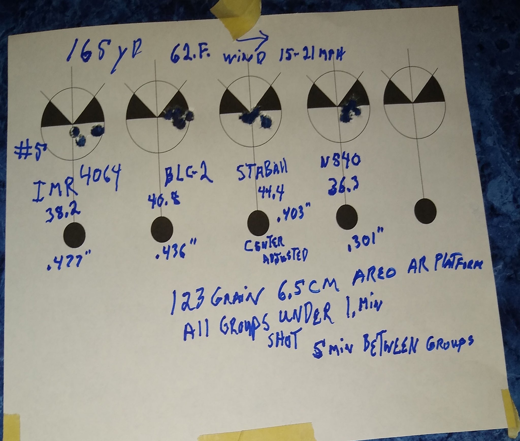

ANYTIME regardless of weapon bolt or gas . I park the rig on sand bags ,fire #1 fouling shot on a clean bore .
Now as I reload , I'll take #15 rounds of a particular bullet style and weight . #5 lower velocity , #5 Mid-range velocity and #5 upper range velocity . I will fire all of one particular velocity at a point on MY target . Clean bore Repeat until all shots are down on target .
This evaluates harmonics within the bore ,as one group usually shows it's accuracy . Regardless of which range of velocity I'll fine tune that bullet to that particular powder . It doesn't mean I won't try additional powders or bullets styles or weights . Simply gives ME Data I can rely on for what I'm shooting .
Without a clean bore to begin ,it's a cluster fuck guessing game ,as to IF the barrel is capable . IMO

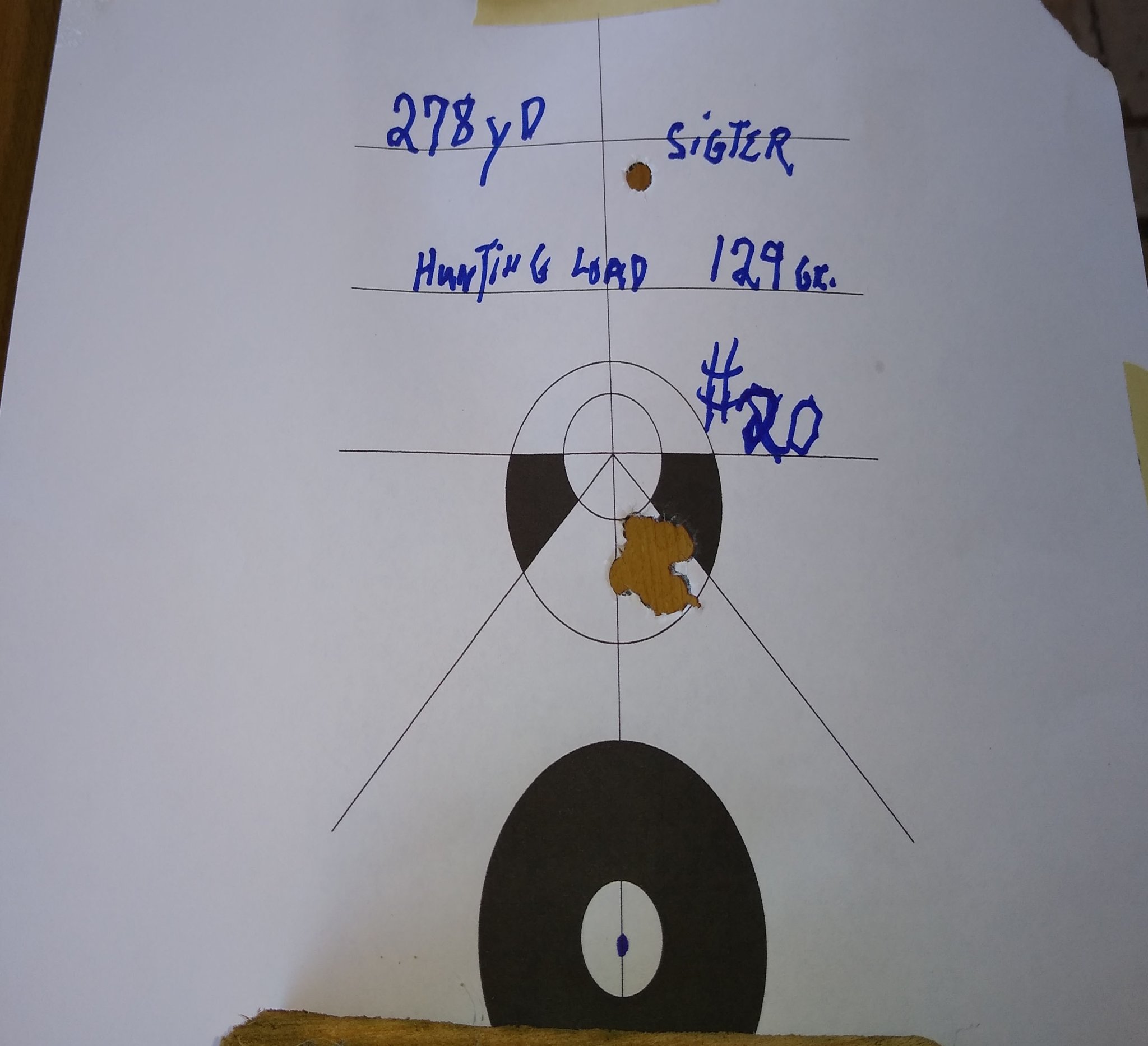

Aero Platform Ballistics 22.5 barrel #20 rounds into .404 at 278 yd. off sand bags ,say what you will but it works for ME .

I don't know what no barrel cleaning required means ?.
I understand... but I was saying all this if the OP was testing one round after another. Without cleaning.
I also have gotten my best groups from a clean bore. ( Grudgingly, Lol )
10rds, 100yrds, bagged, benched, scoped.. etc. Hornady AG 140gr 6.5CM
!!!!!!!!!!!!!!!!!!!!!!!!!!!!!!!!!!!!!!!!!!!!!!!!!!!!!!!!!!!!!!!!!!!!!!!!!!!!!!!!!!!!!!!! (2).jpg
10rds 155gr Hornady AG , same benched setups...
And yes , I flubbed the flyer's... I got to giddy.
!!!!!!!!!!!!!!!!!!!!!!!!!!!!!!!!!!!!!!!!!!!!!!!!!!!!!!!!!!!!!!!!!!!!!!!!!!!!!!!!!!!!!!!!!!!!!!...jpg
