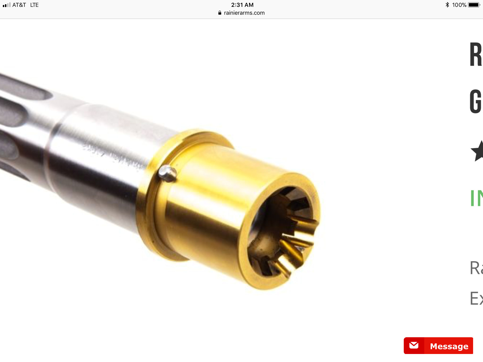

Agreed, for me I have a Rainier ultramatch with a TiN barrel extension so it’s already pretty polished...
The lugs on the right are pretty sharp and do scratch the brass
