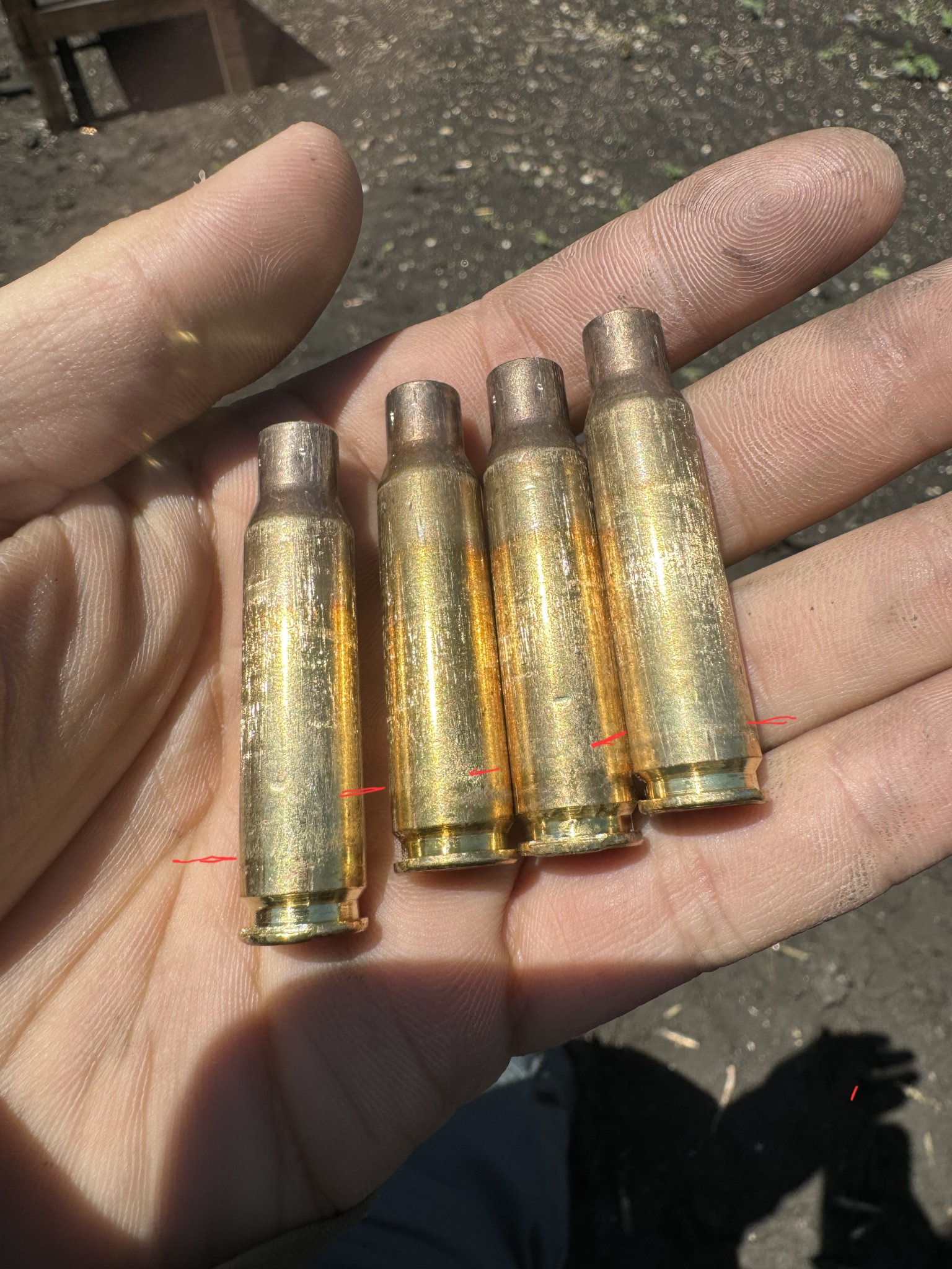

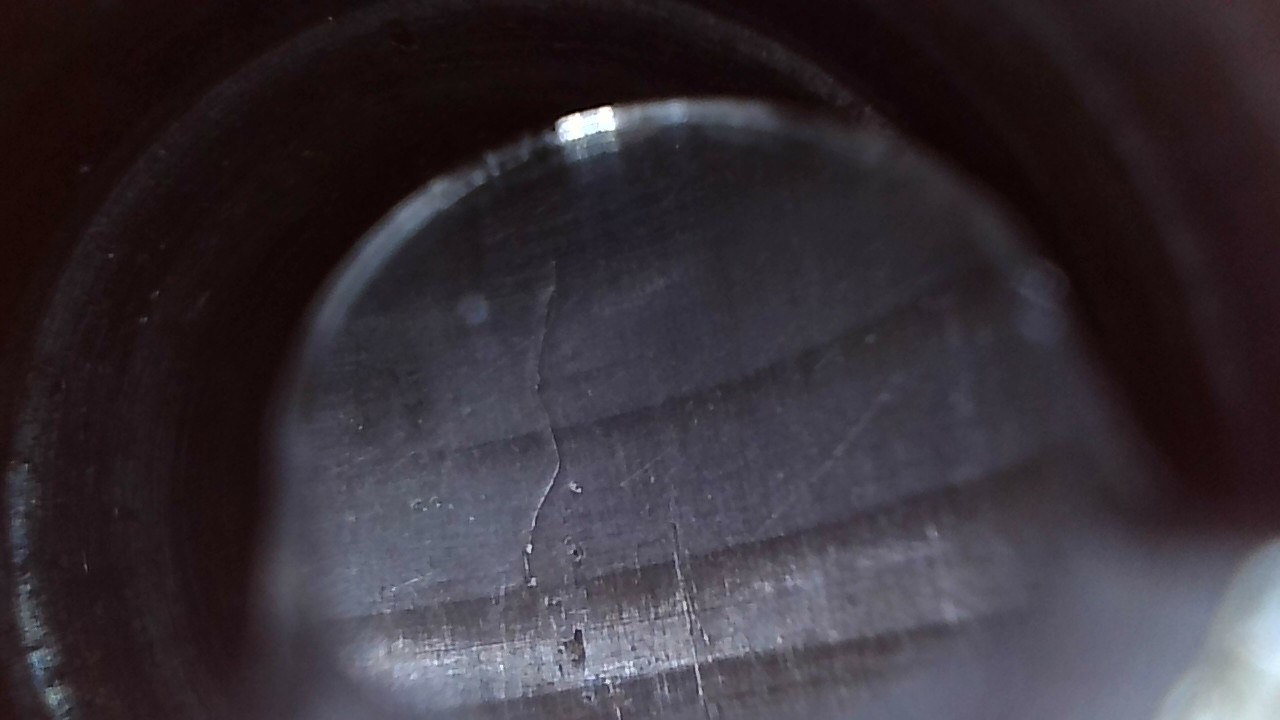

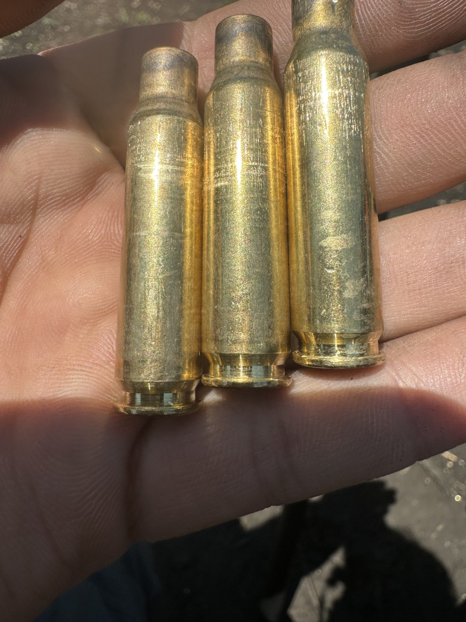

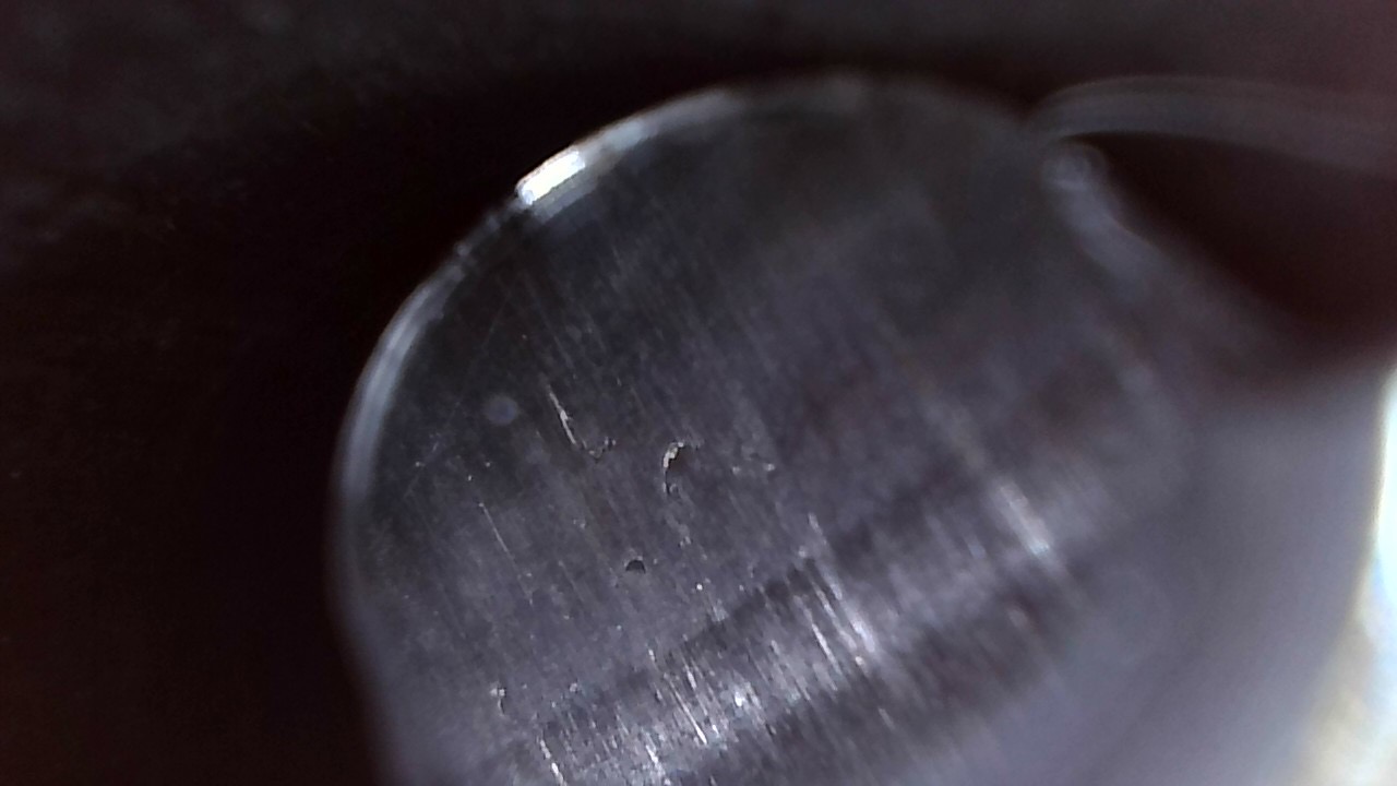

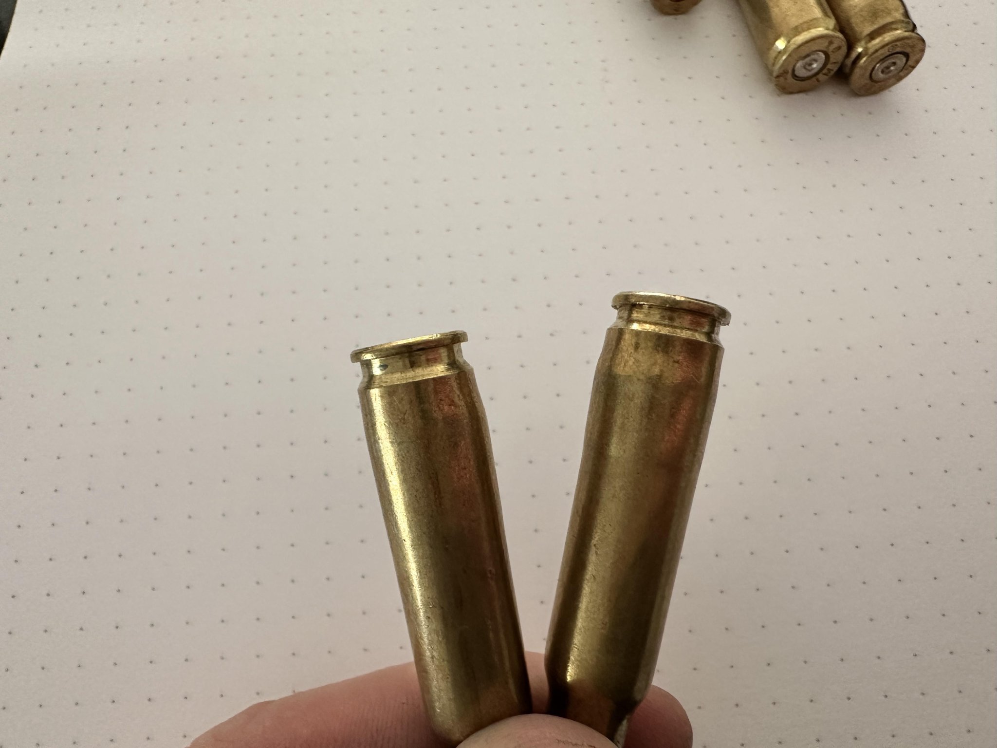

Hi, I am building a M110 clone and is using a Nefarious arms M110 barrel, I am having issues with case stuck in chamber and the case head been ripped off, I see there is a lot of people on here saying they have the same issue but I also have a issue where the case gets marred up really bad by the chamber, just want to see what could cause the marring the red primer is igman which is not a good round I know, it would some times eject and sometimes stuck in the chamber, I also tried Hornady, Hornady ejected fine but also had marring on brass

It might just be a little rough that will eventually smooth out, or it might just need a little polishing/honing by the mfr. Yeah. I know some people who just wrapped steel wool or green scotchbrite around a 45 ACP brush with some oil and "buffed it out, but I would contact the vendor. No sense in paying a smith to do what should have been done in the first place.
I had/have the same issue with a cheaper .308 barrel chambered in .308. It only does it with 7.62x51 ammo though; similar, but not the same specs.
That barrel seems to eat all .308 ammo without issue, so I suspect it’s mostly a matter of tolerance stacking in the throat and chamber.

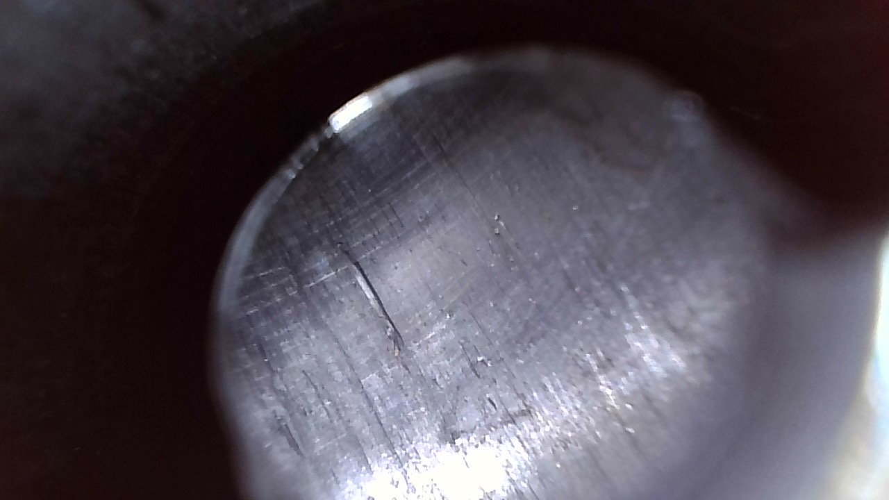

Your chamber is rough but not the issue you have. The gun is WAY out of time. The bolts is ripping the rim off as the case is still under pressure as it is trying to extract. Get a adjustable gas block and screw it all the way in so no gas gets to the bolt. Then start by turning it out a 1/2 turn at a time till you get extraction. Then a 1/4 turn after that should be good.
Likely overgassed as said above (super common in 308 ARs), but you'll want to fix that rough chamber first. There are a couple ways to do that; easiest is a ball hone for the 308 chamber that a gunsmith should have, but you can buy yourself for $40-$50. Keep it wet with a solvent or light oil; laquer thinner, mineral spirits, even WD40 all work fine, and spin it in a cordless drill while moving slightly in and out along the chamber. If it leaves a cross-hatch pattern you did it right. I like to come back with extra fine #0000 steel wool wrapped tightly around a brush for a tight fit in the chamber, again wet with WD40 or similar, to burnish the honed finish. That'll leave a smooth chamber finish that extracts easily and does not mark brass.
Once that's done, definitely tune the gas system. Keep in mind that commercial 308 is generally hotter than mil 7.62, but if you tune it to just work reliably with 7.62 it should be able to put up with being a little overgassed for most 308 loads. Some like Hornady Superformance do better with the gas tuned just for those loads though.

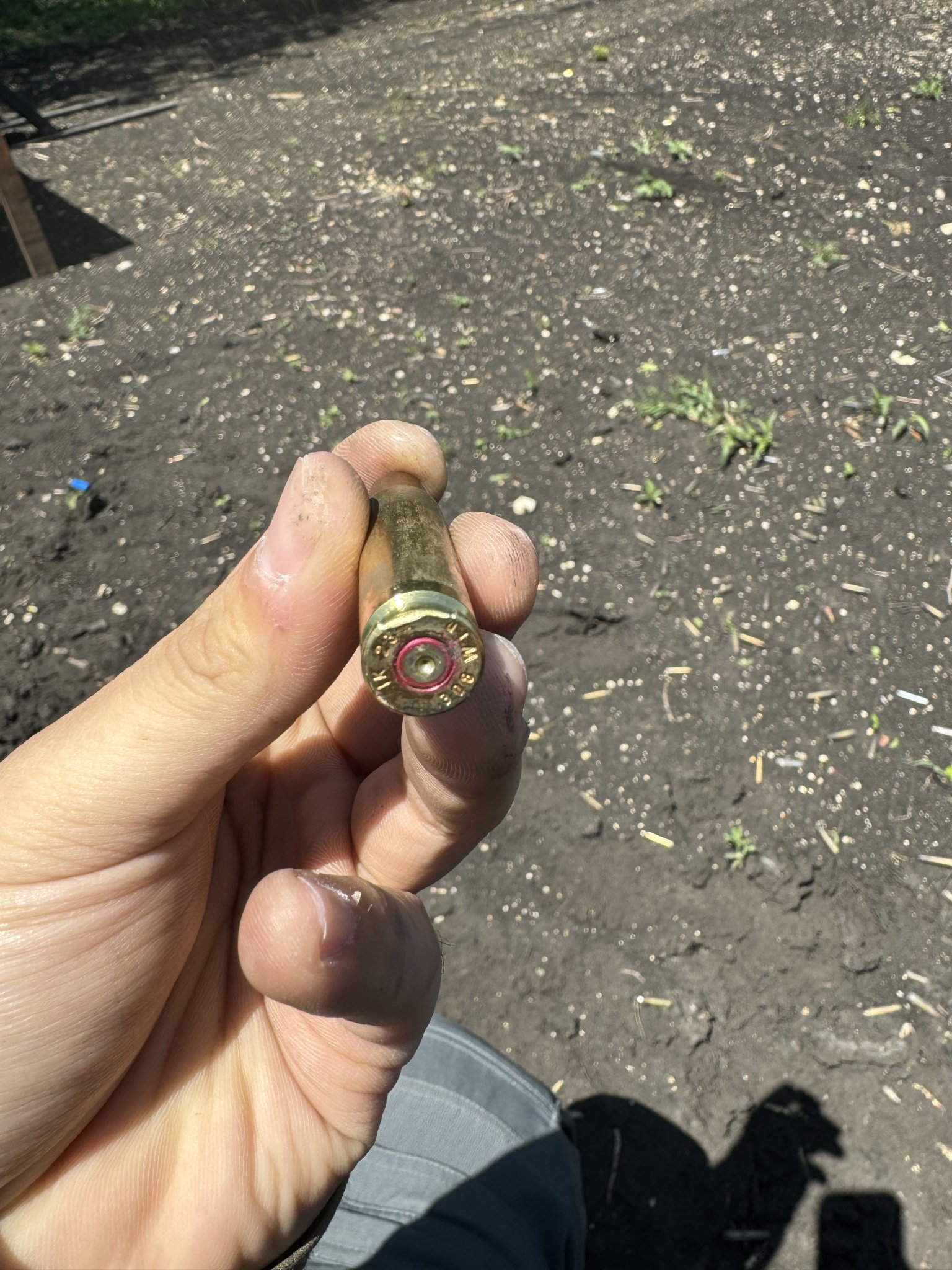

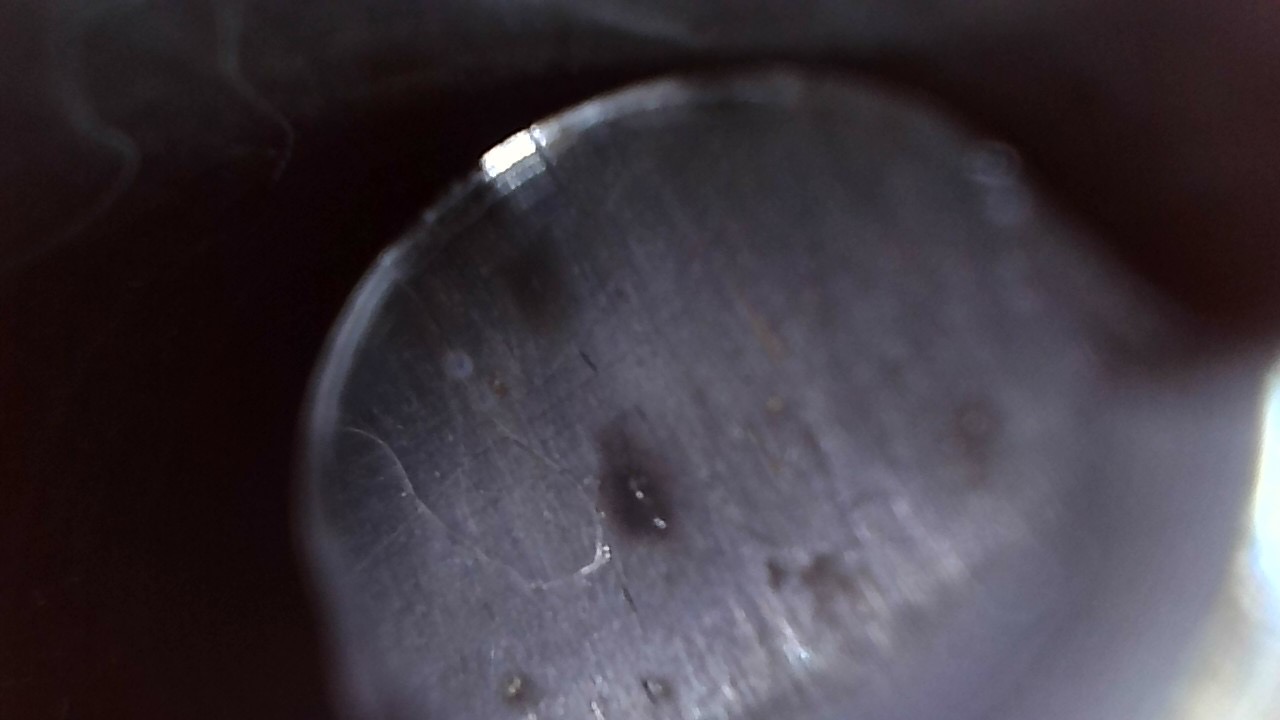

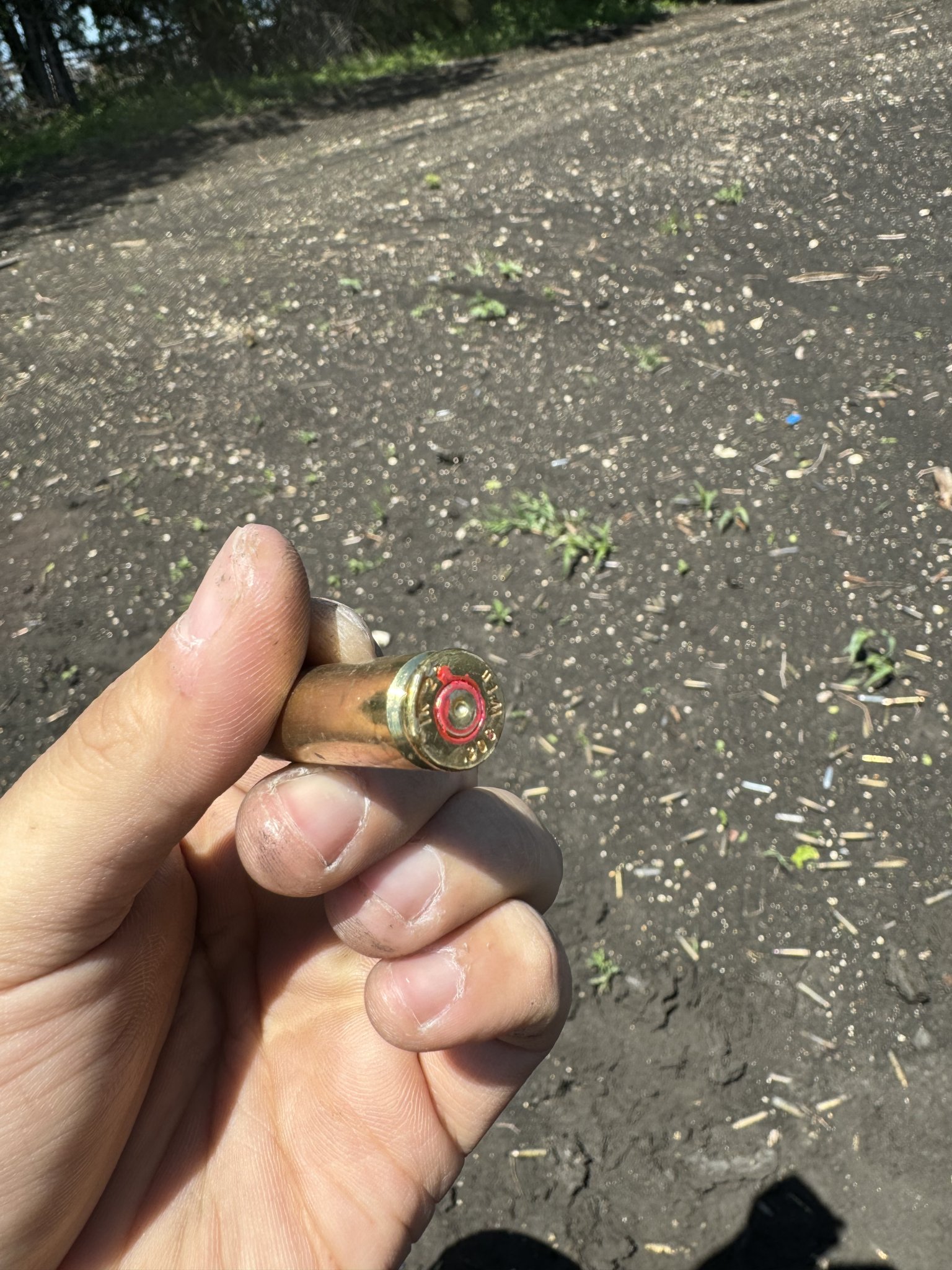

Thanks to everybody who gave me solutions, I have not tried polishing the chamber yet but I took a bore scope to the chamber and took some pictures. Here is what they look like. What could have caused this issue? Manufacturer’s problem? I did have the gun cerakoted. Will polishing the chamber fix these issues?

that does not look safe to fire
Pull out the BCG and drop a round into the chamber by hand. Does it drop in freely or stick? I'm wondering if the chamber was cut undersize.
Other possibility, as already mentioned, is the timing. It's trying to unlock the bolt too quickly during the firing cycle. I couldn't find specs on Nefarious' website, so just guessing your barrel is 20" with rifle length gas? What buffer? Standard weight BCG? Adjustable gas block?
If the chamber checks out, I'd start by turning down the gas and going up on BCG or buffer weight to slow the cycle down. I had to use a SA gas block, H3 buffer, and an increased-strength spring on my AR-10 build to get it to stop pulling case rims.

The very first pic shows the cause of the issue, but it's not the darker longitudinal scratches you're probably looking at, it's the circumferential rings in the chamber (most visible near the upper left of that pic) that were caused by a rough chambering job and not honed out. You can see evidence of this on the brass in the pics in your original post as well, that's why I said it's a rough chamber; I've dealt with this exact issue before and it's clear that's a problem here. Based on the appearance of your brass, you will need to address both this and the overgassing issue to make the rifle reliable.
IME this is usually caused by a manufacturer trying to save costs by cutting down on production times (pushing the reamer too fast/hard) and using reamers past the point where they should be resharpened. Not at all uncommon with lower cost barrels.
You need to hone the chamber or have someone do it for you. This is the correct tool, and I offered some tips on using it in my previous post in this thread. (Get the 400 grit 308 or 7.62x51 if the link doesn't take you straight to it.)

ALSO - looking back at your first pics of the brass, they're showing similar longitudinal scratches to the chamber; were you shooting this in really sandy conditions by any chance? Or was the ammo sandy/dirty? Honing will fix it, but whatever happened there it did damage the chamber.
There's nothing unsafe to shoot in those pics though. No idea what that one guy thinks he saw but you don't need to worry about that.

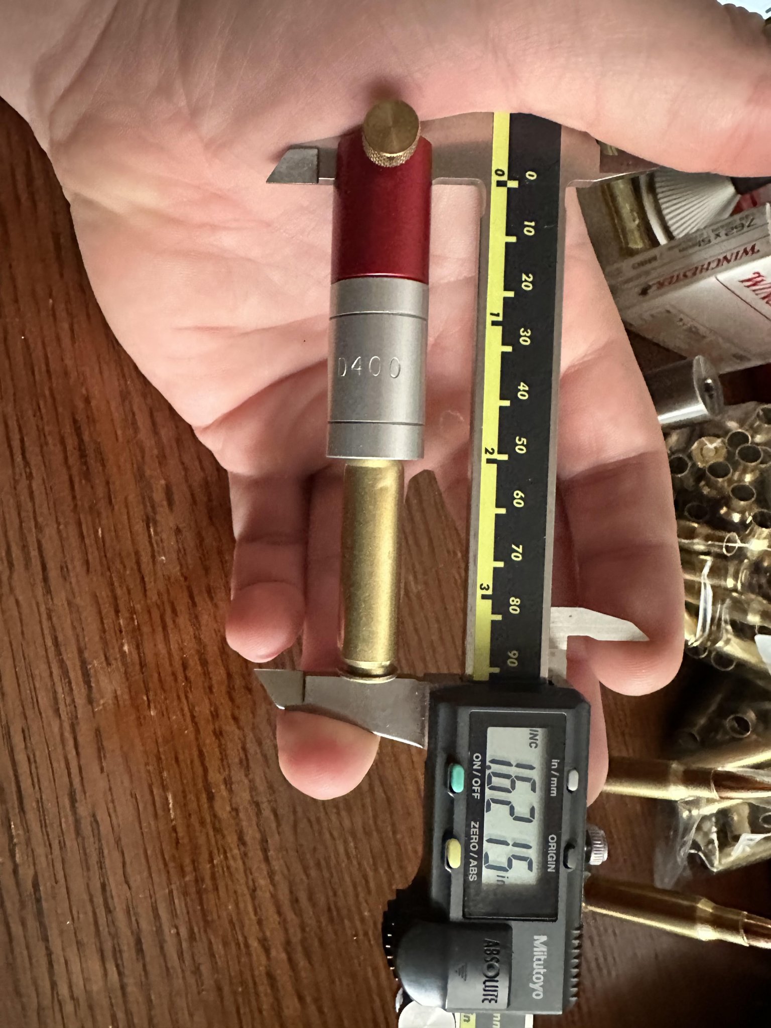

Get a hornady comparator gauge and put it on your calipers... actually measure what you are doing.

Do you have a Hornady headspace comparator set?
What are your web ODs between factory ammo vs your re-sized cases?
I’m talking about dimension C from this diagram:
Deleted image from quote. Reloads are 0.468" to 0 0.470", same as some new ones.

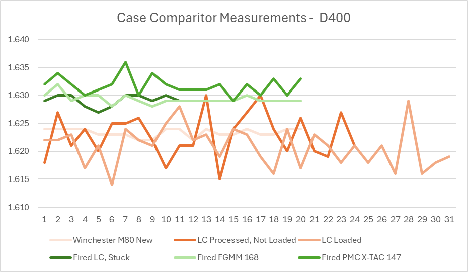

Thanks for all the replies. This is a long post.
Did some measuring and not sure I'm convinced that my die is setup incorrectly - see comparison chart of new Winchester M80 vs sized vs fired below. Couple of outliers on the processed brass, but the vast majority are at least 0.005" less than the fired cases.
Winchester M80 NewLC Processed, Not LoadedLC LoadedFired LC, StuckFired FGMM 168Fired PMC X-TAC 147
1.6241.6181.6221.6291.6301.632
1.6241.6271.6221.6301.6321.634
1.6241.6211.6231.6301.6291.632
1.6241.6241.6171.6281.6301.630
1.6231.6201.6211.6271.6301.631
1.6231.6251.6141.6281.6281.632
1.6231.6251.6241.6301.6301.636
1.6221.6261.6221.6301.6291.630
1.6221.6221.6211.6291.6281.634
1.6241.6171.6251.6301.6291.632
1.6241.6211.6281.6291.6291.631
1.6221.6211.6221.6291.6291.631
1.6241.6301.6231.6291.631
1.6231.6151.6191.6291.632
1.6231.6241.6241.6291.629
1.6241.6271.6231.6301.632
1.6231.6301.6191.6291.630

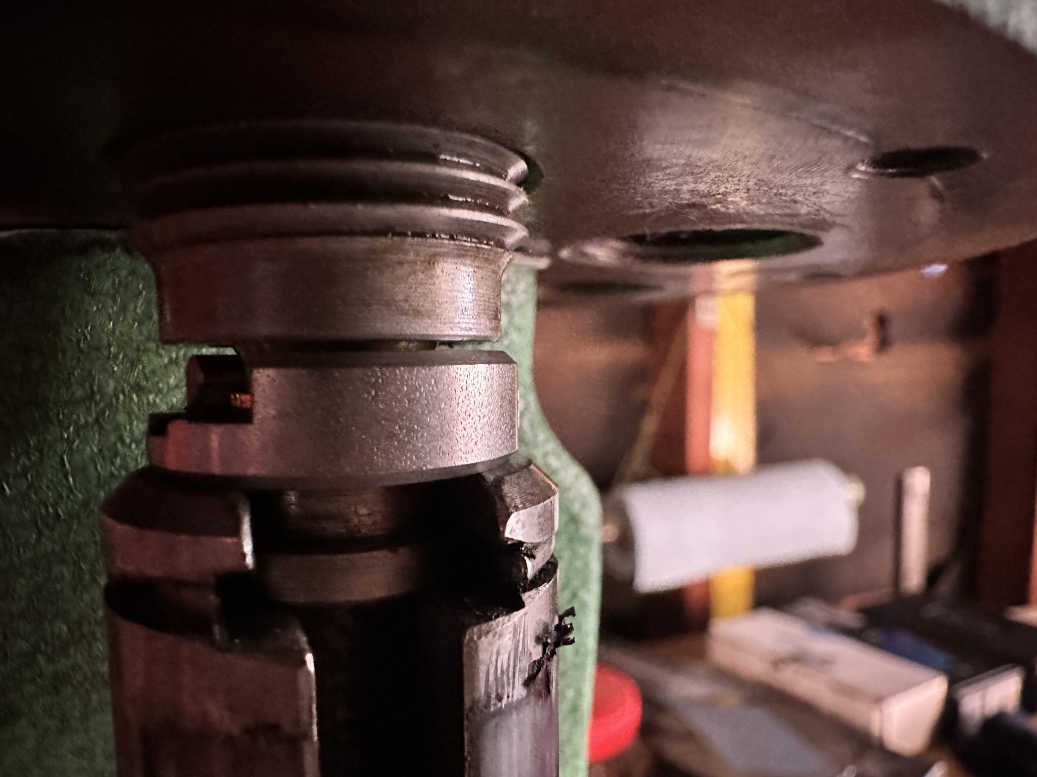

Pic below of shell holder die gap - yields 1.620" on the headspace comparator. This is threading die in til touches shell plate plus 1/8 - 1/4 or so of a turn.

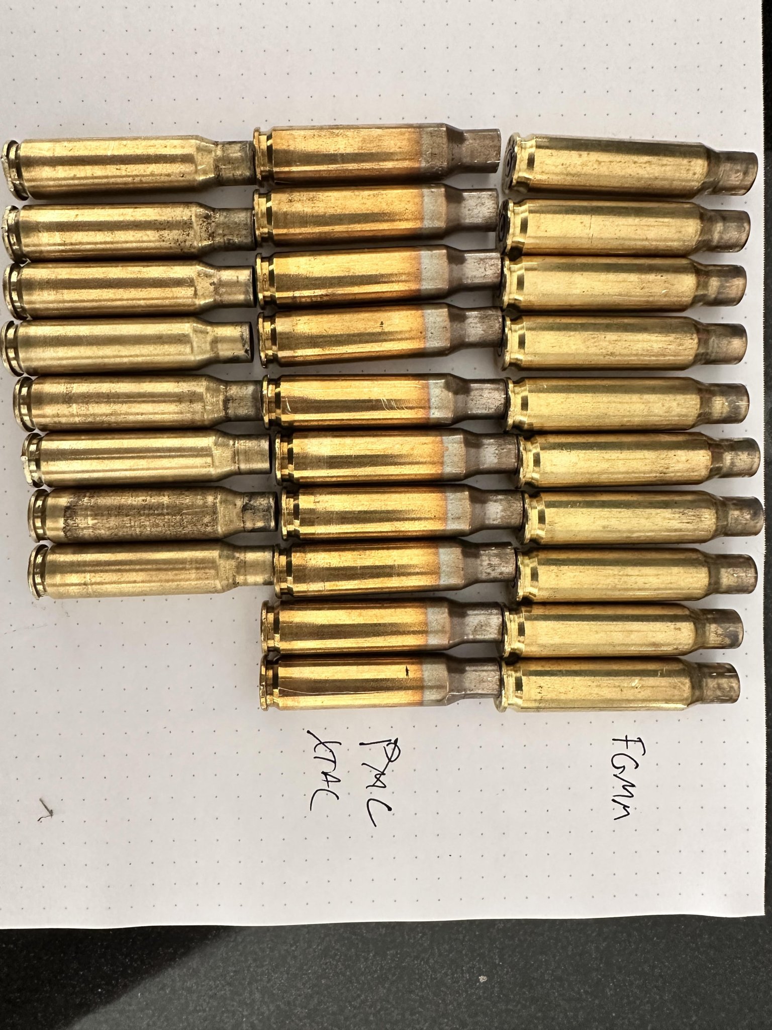

Pics of fired cases - reloads that stuck are on the left.

if the brass is not sized enough, that pic of your shell holder and die is what I am talking about. You have too much flex in your press. There is a gap between the two.

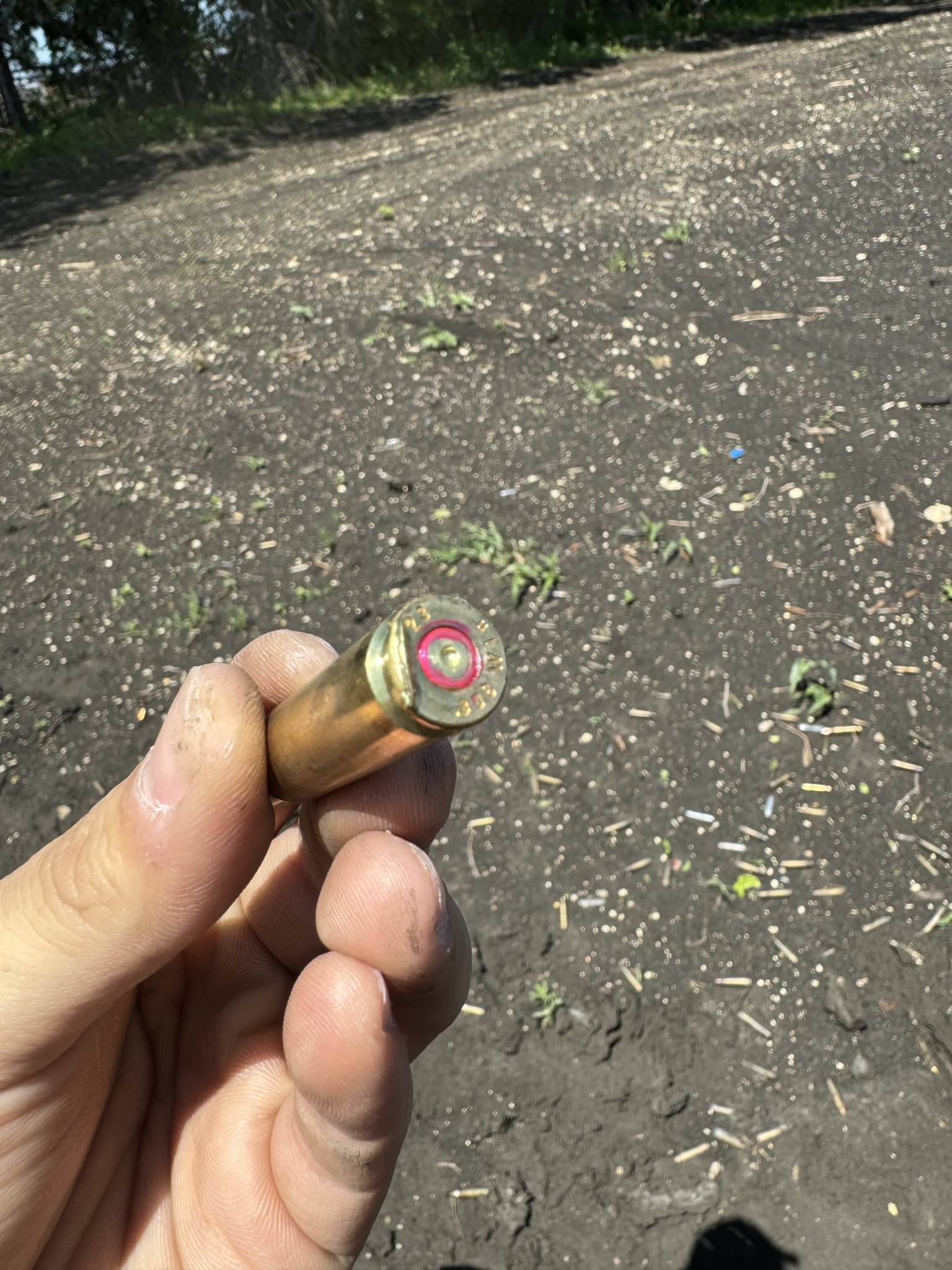

Also it looks like you have a pressure/ignition issue on some of the cases on the left. But it is a low pressure and carbon is getting in around the case. THAT also can cause extraction issues on rounds fired after all that carbon is deposited into the chamber. It happens with brass as well as steel cases and the carbon build up in the chamber is the reason for sticking. Which leads to WHY???? My guess is weak ignition with the ball powder. Or the brass needs annealed to make it soft to seal the chamber.

Good pic. The right shows slight carbon down the brass, which to me indicates premature movement of the bcg. Could be gas or buffer weight or both.
Left same thing but even more so.
Center rounds looked the best.

txsailor, first, you have a rough chamber, period. That needs to be fixed.
Second, brass doesn't stick in the chamber because of a gassing issue. It sticks because your sizing is super inconsistent and some cases are too big, and/or the chamber is too rough. You also need to learn to use the comparator correctly to compare to fired brass from that same chamber, not to factory ammo.
You have two obvious issues to fix here:
1 - The chamber is too rough. Have a good gunsmith hone the roughness out of it. This will completely fix one of your two problems.

If the rifle were that badly overgassed, with a chamber that rough, you'd have the extractor pulling rims off until it broke. Your assumptions of what's happening here are incorrect. The case is NOT being pulled out under high pressure to be considered "unsupported"; nothing like that is happeing here and if it were, it'd look a lot different than the pics show.
2 - Your sizing is inconsistent. Two primary solutions to that are to start annealing your brass (this is the main cause - overworked brass gets springy and won't size down as much) and maybe use a better sizing lube as well.
If you do those two things, and set the die to bump shoulders back .003"-.004" compared to fired/deprimed brass from that chamber, you'll eliminate the issues you've described here. It really is that simple.
A small base die should not be needed, and I've rarely seen a situation where a SB die "fixed" a sticking chamber issue where the owner understood how to correctly use a comparator to set up their FL die. If they had, in most cases the SB die wouldn't have been needed.
It looks exactly like like what's happening. If the rifle wasn't over gassed the rims would be intact, the only thing doing that to brass is gas pressure. That's a pic from the OP.
The marks on the brass aren't from the "rough" chamber they are pull marks in the very obvious direction inline with extraction.
Sure he can polish the chamber some but that is not the primary cause, and after that is "fixed" OP will continue to have timing issues caused by over gas.
Lastly, I can create this issue in several AR10s by increasing the gas pressure and flow to a point the that system can barely handle it(several ways), and begins to rip rims off, and deform the lower base area to the point the brass is hard to size, and makes the same pull marks on the brass that the OP provided images of.
If the case is pulled out early and under pressure because of over gas; the point it's pulled, the brass almost immediately gains clearance from the wall of the chamber, and while under pressure that allows abnormal expansion of the brass. It's pretty simple.
Overgassed, yes, as I said earlier. Overgassed to the point of extracting while still under high pressure to bulge cases - no, these rifles won't do that. They rip the rims off first. And the cases shown in those pics aren't bulged there anyway.
You're pointing to a particular spot on the cases and saying they're extracted that far and unsupported at high pressure, but you're just guessing without sound reasoning and experience to back it up. That point you indicated on the cases is where the case web stops, that's why it looks different; it has nothing to do with your theory of extracting cases to that point. If it were actually extracting under high pressure as you're claiming, the case web area would be bulged a LOT. You need to see some actual bulged cases to see the difference; it's not even remotely like what's been shown in this thread.
Beyond that, even being overgassed that rifle still is leaving signs of a rough chamber on the brass. If your rifles make brass look like that, then they have crappy rough chambers too. Hone the chambers out, and even overgassed they won't leave marks like that. No guessing here, speaking from first hand experience.

I'm not pointing to just any one spot on the case, I am observing the big picture in totality.
Why is that very distinct line at the base?
Why are the lines from the "rough chamber" directional from the top to the bottom of the brass?
When chambers are cut, are they cut radially or some other direction?
How do you know my experience?
Can the case web area bulge a lot or just the amount it's allowed to by the wall of the chamber based on the position it's in during the event of premature extraction?
Is this gun one particular example?
Can this gun be on the edge of this described issue or is the result definite like you say?
Is the rough chamber the main cause of these issues the op is having?
If the pressure went up or down in this example rifle what would be the results in your opinion, please explain both?
