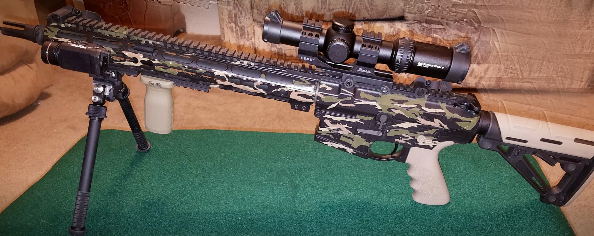

Putting a Primary Arms Platinum 1-8x scope on a .308 AR10. I have a set of 34mm 1" high Badger Ordnance Rings on hand but they are just a tad too low. Need an minimum of an additional 1/4 inch of height. This is a battle rifle (for now anyway) but not interested in a half-assed solution to this problem. Is a riser a viable option? If so are there brands I should or should not consider?
Thx!
AZ
PRI makes a quality "AR10" length riser in flat and sloped version. I have two.
There might be better but not by much and the price is reasonable.
Most risers add 0.5-6" and standard AR optic height is around 1.5" so a riser and low rings will get you right around that height.
A riser with high rings might need a taller comb for good cheek weld.

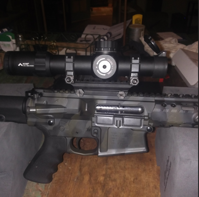

After rooting around in the shop, found what appears to be 1" riser. Brand unknown. Slapped on there and it appears to line up quite well, with no need to crank up my PRS cheek riser. I think I understated how much more height I needed. Since my cost is ZERO, I'll give this setup at try.

Went with a YHM riser:
YHM AR-15 Scope Riser 5.25" Long 1/2" Tall
YHM-227A
$39.25 including shipping from Cheaper Than Dirt. I've moved this optic to my M4 due to weight concerns on the AR10.
