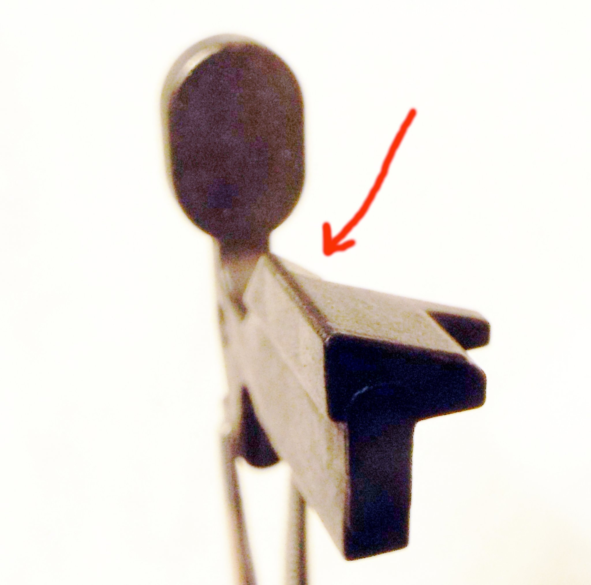

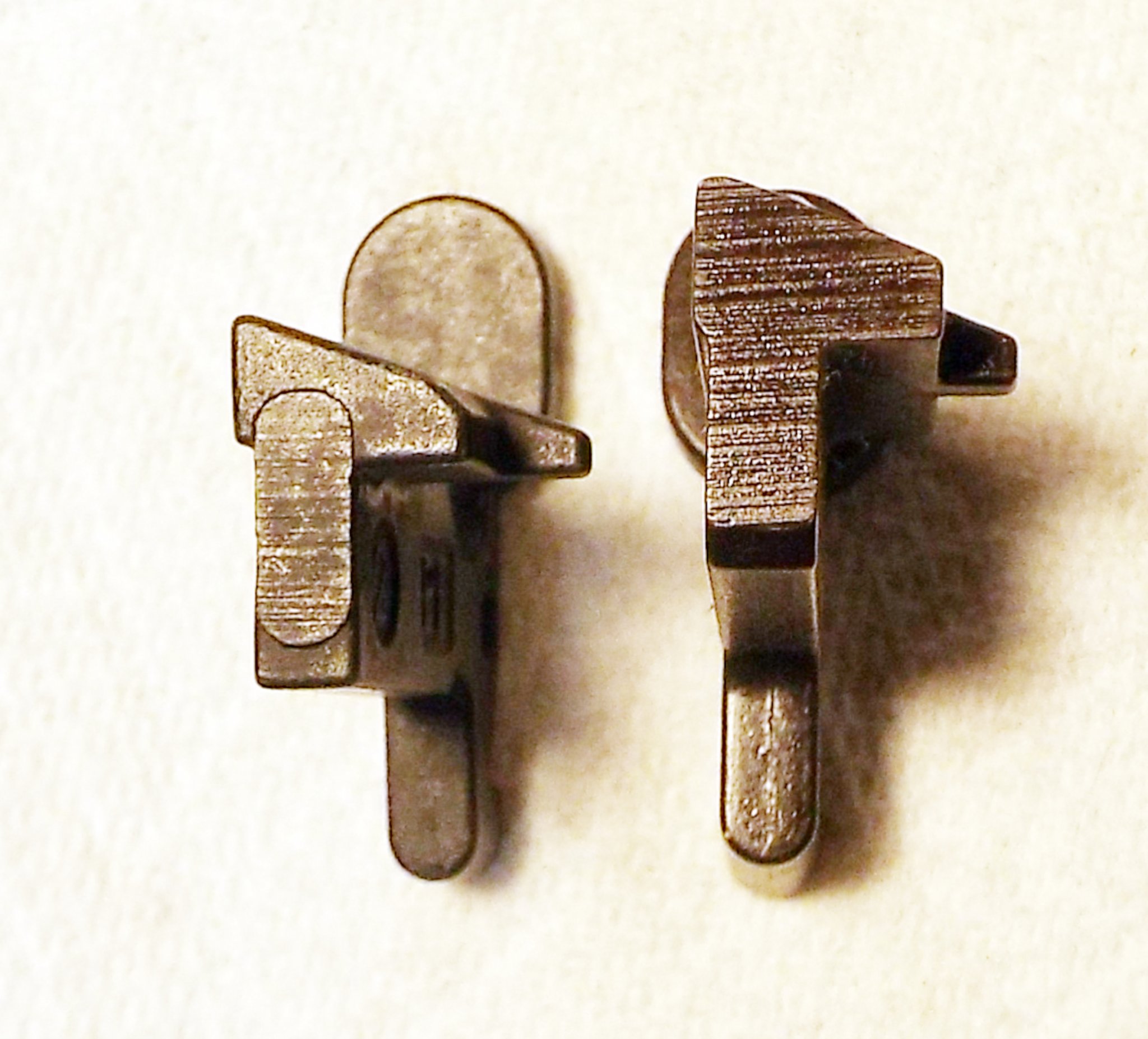

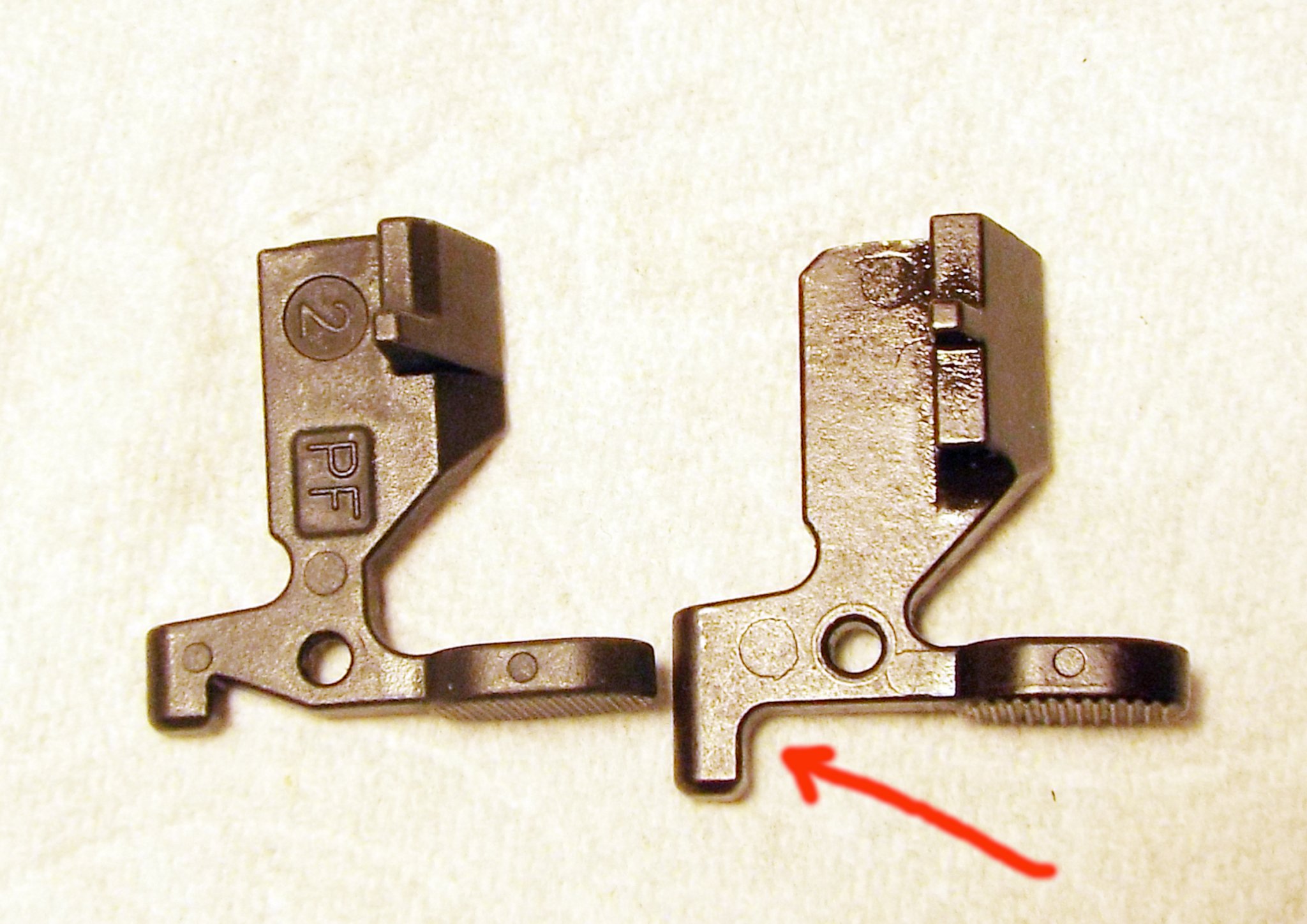

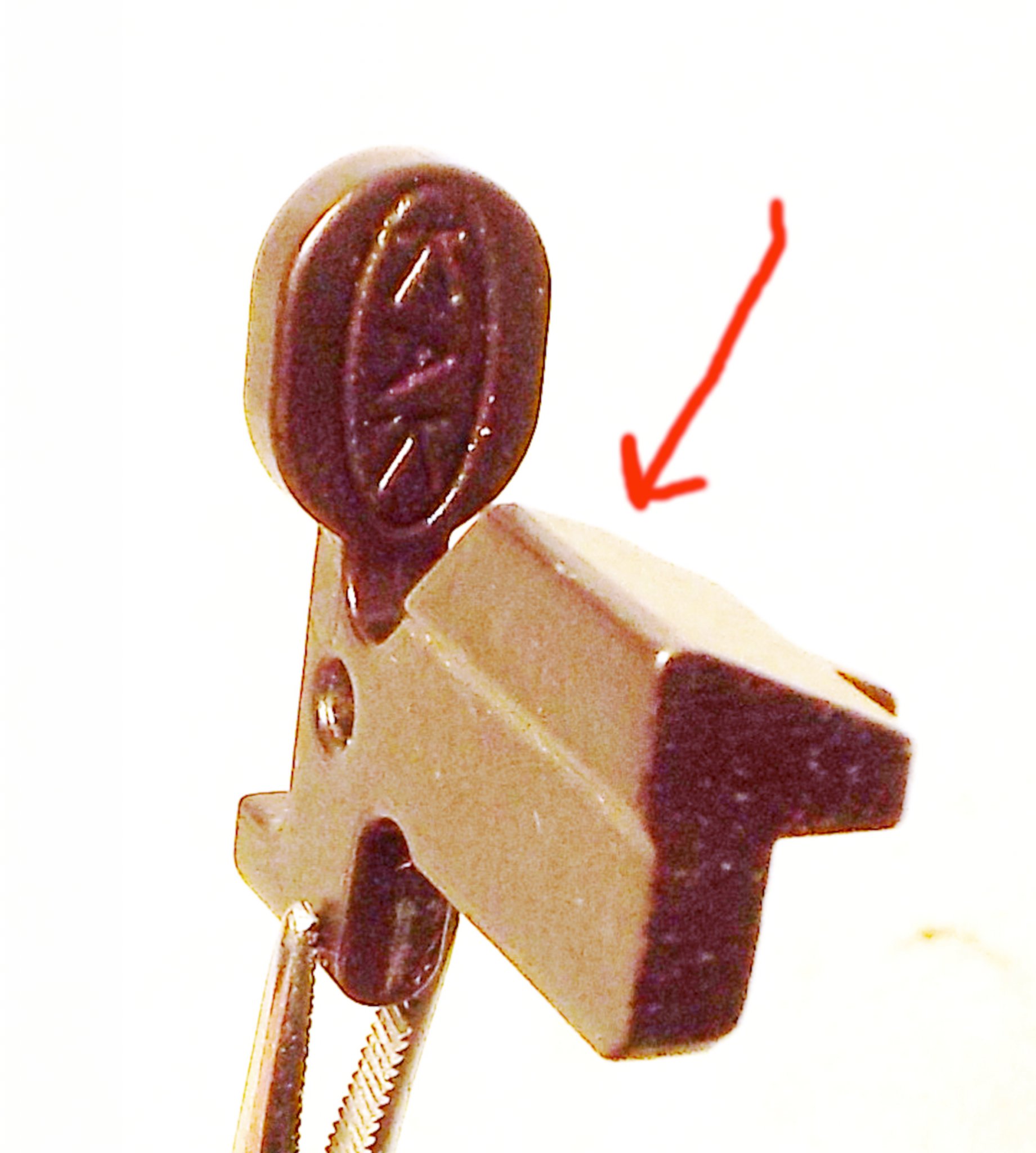

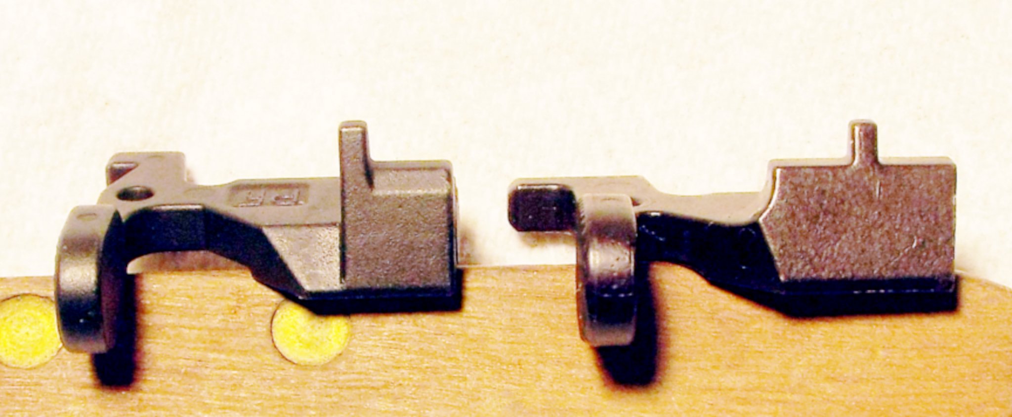

I removed the BHO from the rifle and took close up photos of the two devices and you can see the KAK latch edge is clearly "rounded-off"more that the original AR15 type.
The original AR15 latch has a much more acute edge which grabs the milled portion of the bolt. The bolt has a really nice "stop" edge machined into it.
Both upper and lower receivers are a very nice tight fit together. No slop.
AR15 original
KAK Enhanced

Original on left,
Original on left.
KAK on right has extended manual portion for the thicker AR10 type receiver. A really nice feature.

What specific brand lower do you have ?
And ,as you might know, there is no MilSpec guideline for LFAR's , so your model lower helps decide which bolt catch.
And the side you would like to file down, ( In your photo ) isn't where I would file... I would file the slight angle on the other / upper edge directly above your red arrow.
