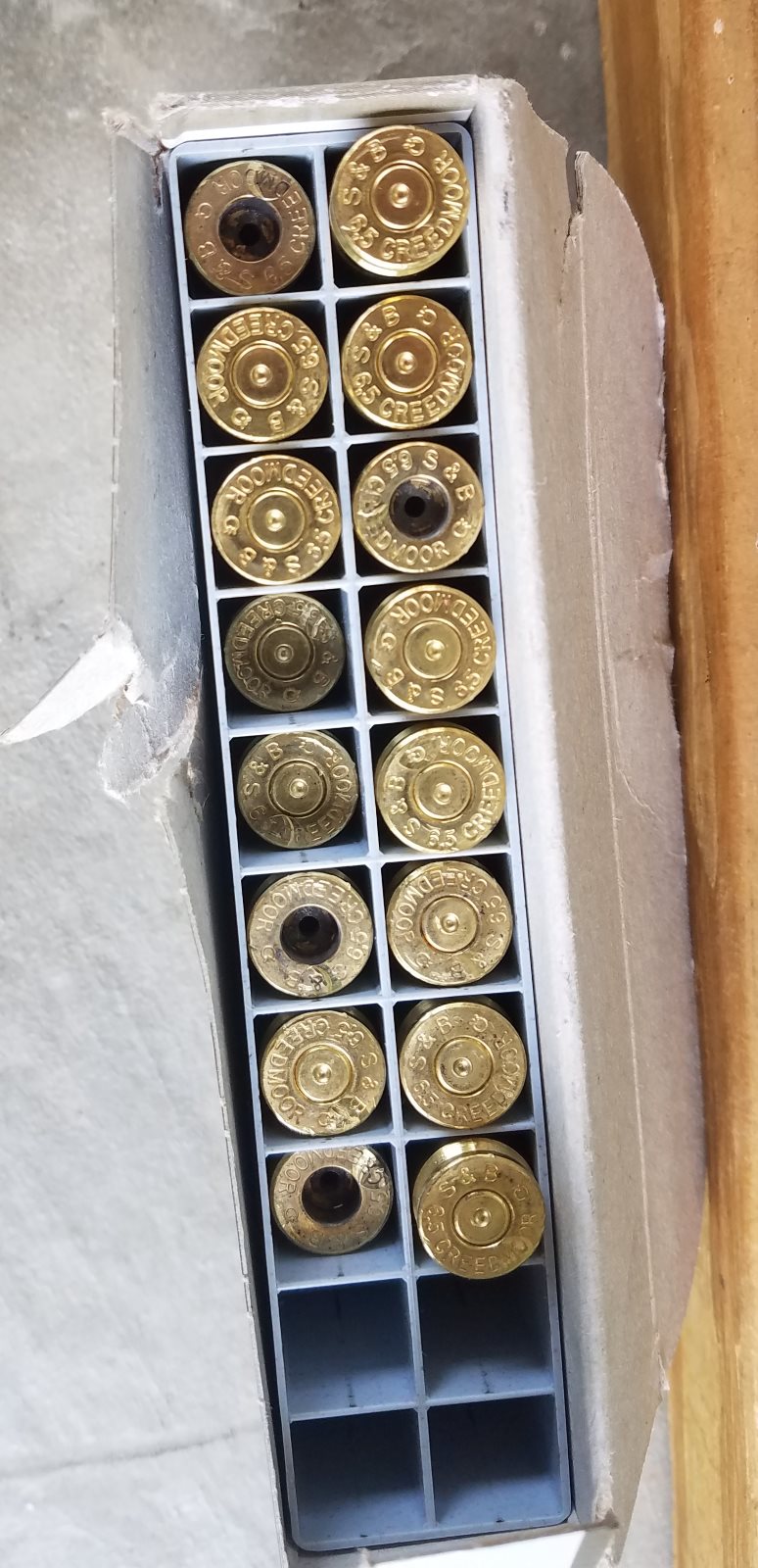

Hello All
Having some concerns about signs of over pressure with my AR10 6.5 upper
This AR10 was a factory build Aero Precision in 308 with a 16" barrell
I then built up an Aero upper with a Ballistics Advantage 22" ultra match barrel and Aero BCG in 6.5 CM
I do not reload (just have not gotten there yet) so I am using all off the shelf ammo
Hornady ELD match 140 gr seems to shoot the best in this gun, but I tried a box of Sellier & Bellot 140gr and actually had primers blowing out of the back of the brass case and flying everywhere.
The gun has a fixed gas block, but I did put in an Armaspec AR-10 Stealth Recoil Spring and that seemed to help, but it is still doing it.

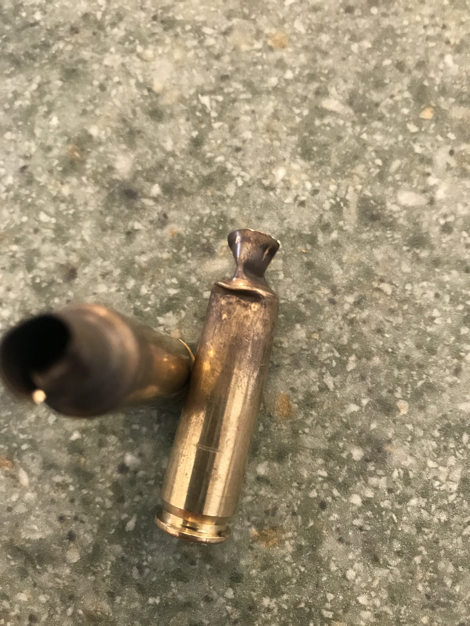

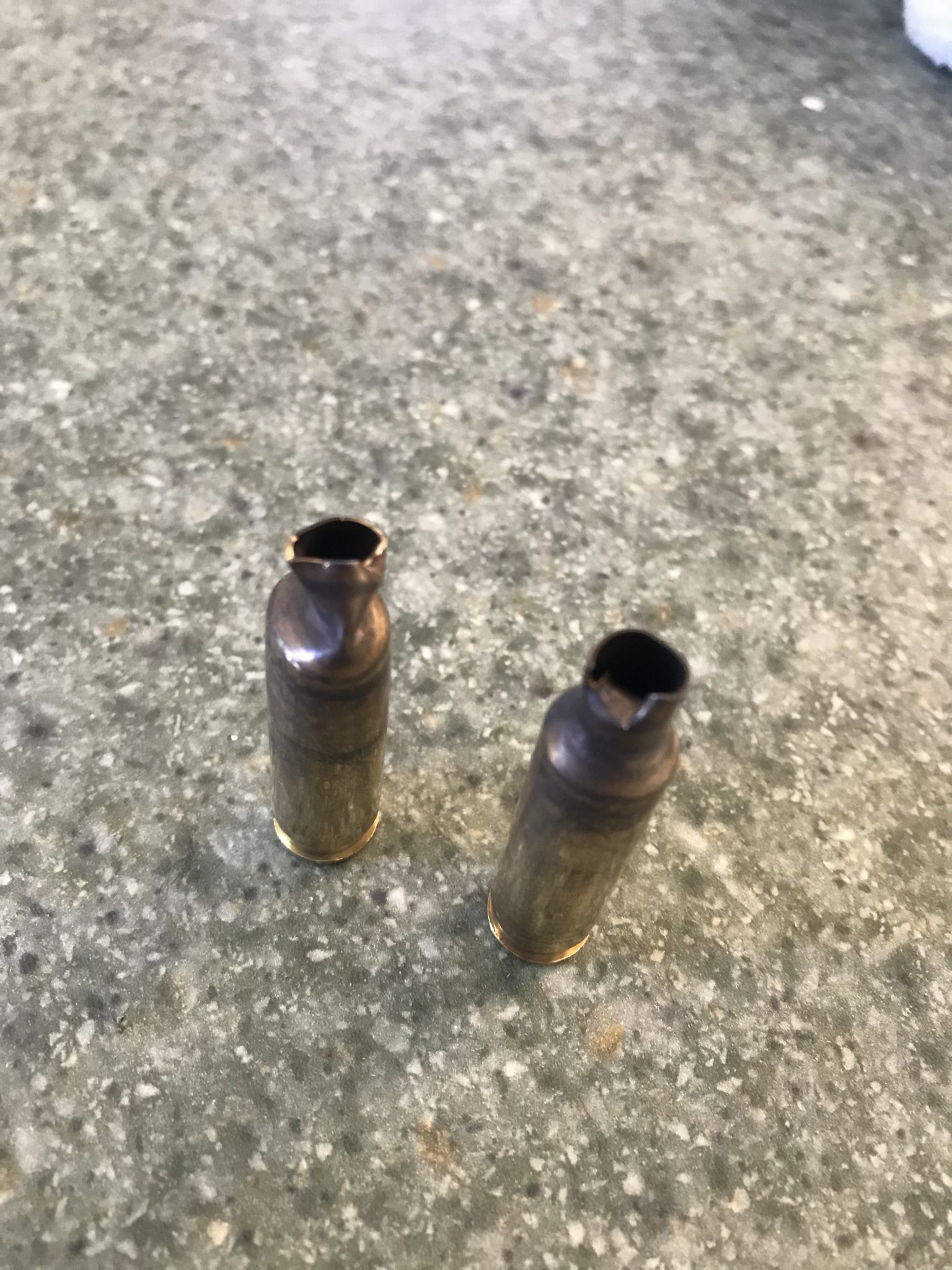

Here’s a good example of an overgassed 6.5CM semi.
WTF? I don't even know what to say about those photos.
JFR
That was my 6.5CM set with the adjustable block fully open, a +2 gas system, full weight BCG, Tubb spring and H1 buffer. 140 eld over 41.8 H4350 loaded 2.231 BTO. BCG would come back so fast, the spent case would do a 180 in the upper and get smashed by the BCG. Made block adjustments and the brass looks unscathed and ejects at 3-4 o’clock. That’s what I call overgassed. ?
I guess S&B isn't going to work in my gun. I got everything dialed in for the lightest loads I shoot, the Winchester 120gr
I shot a box of the Winchester and it worked perfectly
I shot about 10 Hornady ELD 140s and they worked perfectly
I shot 3 S&B 140s and stopped as the 3rd one blew the primer completely out of the case
(the first two showed some rough ejector marks)
This is so strange as I shot 2 boxes of S&B in this same gun and didn't have any issues at all. I really think now there is something wrong with the S&B ammo I bought in the second round (these new ones are a different lot number)
Anyway, the first two boxes of S&B I had actually grouped well at 600 yards. I guess I need to give up on it at this point. If I want a cheaper ammo to shoot at 100 yards I will stick with the winchester

I just sent an email to Sellier & Bellot US Customer service. I am curious what they have to say
I included the lot # 6.5 Creedmoor 140 Gr FMJ BT LOT 28/89
This lot of ammo came from Sportmans Guide
The previous couple of boxes I bought early this year came from Outdoor Limited, but I have nothing remaining with the lot # on them.

some back and forth with S&B on this issue, going to agree it is just my gun that does not like this ammo. Shoots fine in their guns, so I will stick to Hornady match in my ar10, it seems to love this ammo, just unfortunate for me the price difference :)
S&B made good on an ammo exchange for a different caliber, and I am still a very happy customer just will not be shooting their 6.5 in my AR10 :)
Reactions: Blaster7Romeo
Depends on the throat. If I throated a gun specifically for 140 AMAX, S&B would not workie..
