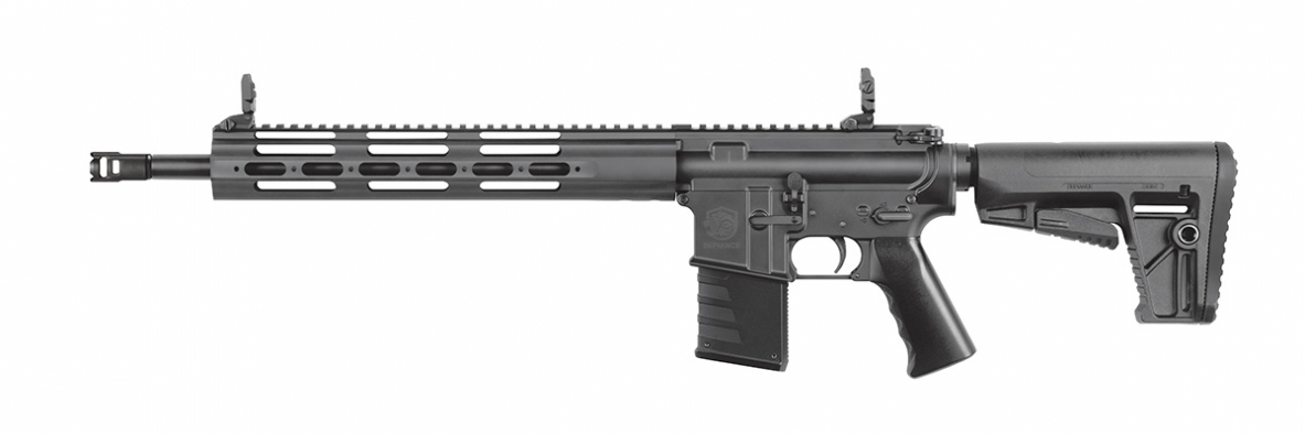

Kriss Defiance .22 (https://kriss-usa.com/rifles/rimfire/dmk22) is available for under $600 at a particular on-line seller. Yeah, you've already got a lower to use but for $600, you've got a complete rifle so no having to swap stuff back and forth.
I've only put CCI standard velocity through mine but it appears to be reliable, even with an Elftmann replacement trigger.
I've looked at the Rainier Arms as well but with the Kriss, you'll have (reliable) last round hold-open when using Kriss or S&W 15-22 magazines.
