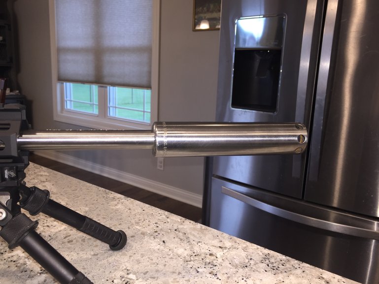

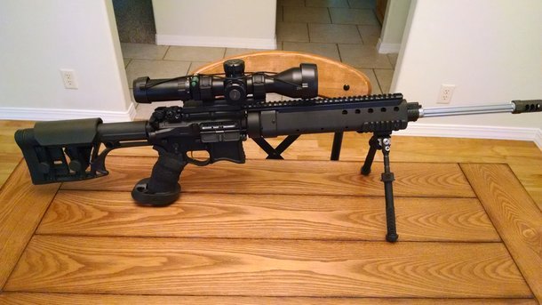

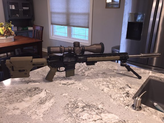

(6mm Grendel)2700 FPS even with 27.5 of 8208 pushing 105 hybrids out of a 20" tube. I run a rifle length gas tube with a superlative adjustable gas block. Runs great...
