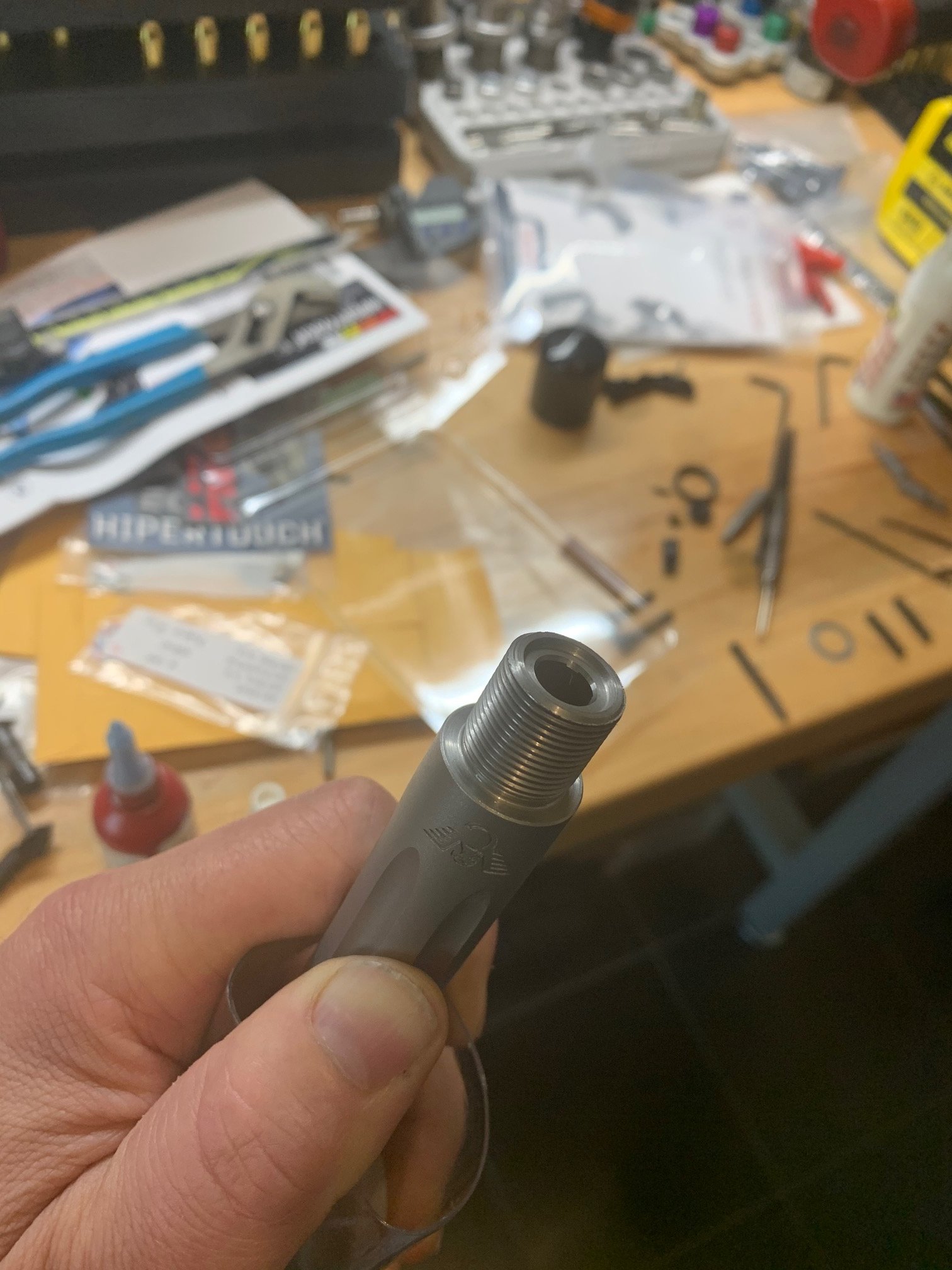

What kind of crown does that barrel have? Some time in the last few years Wilson started making their own barrels, their new barrels do not have 11* crowns. They have a flat crown with a 45* chamfer at the bore.
This is a recent Wilson Combat 20" SS 308. Not sure what there 223's look like?

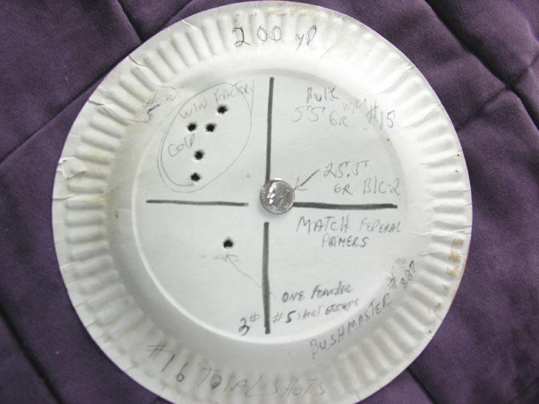

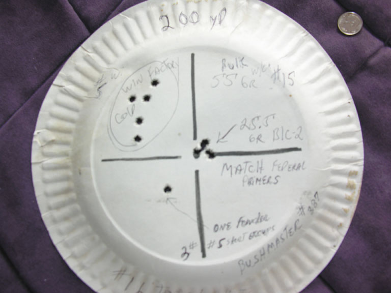

Faxon 5R , DD . Go ahead and laugh but I'd opt for Old Bushmaster aka Windham Weaponry CR bore . Winchester white junk left stringing ,one fouler followed by #15 using BLC-2 charge with Bulk 55 grain pills . better than #2 decades back now . Someone was misinformed about cr bores Not being accurate .
#15 under the dime at 200 yd.
