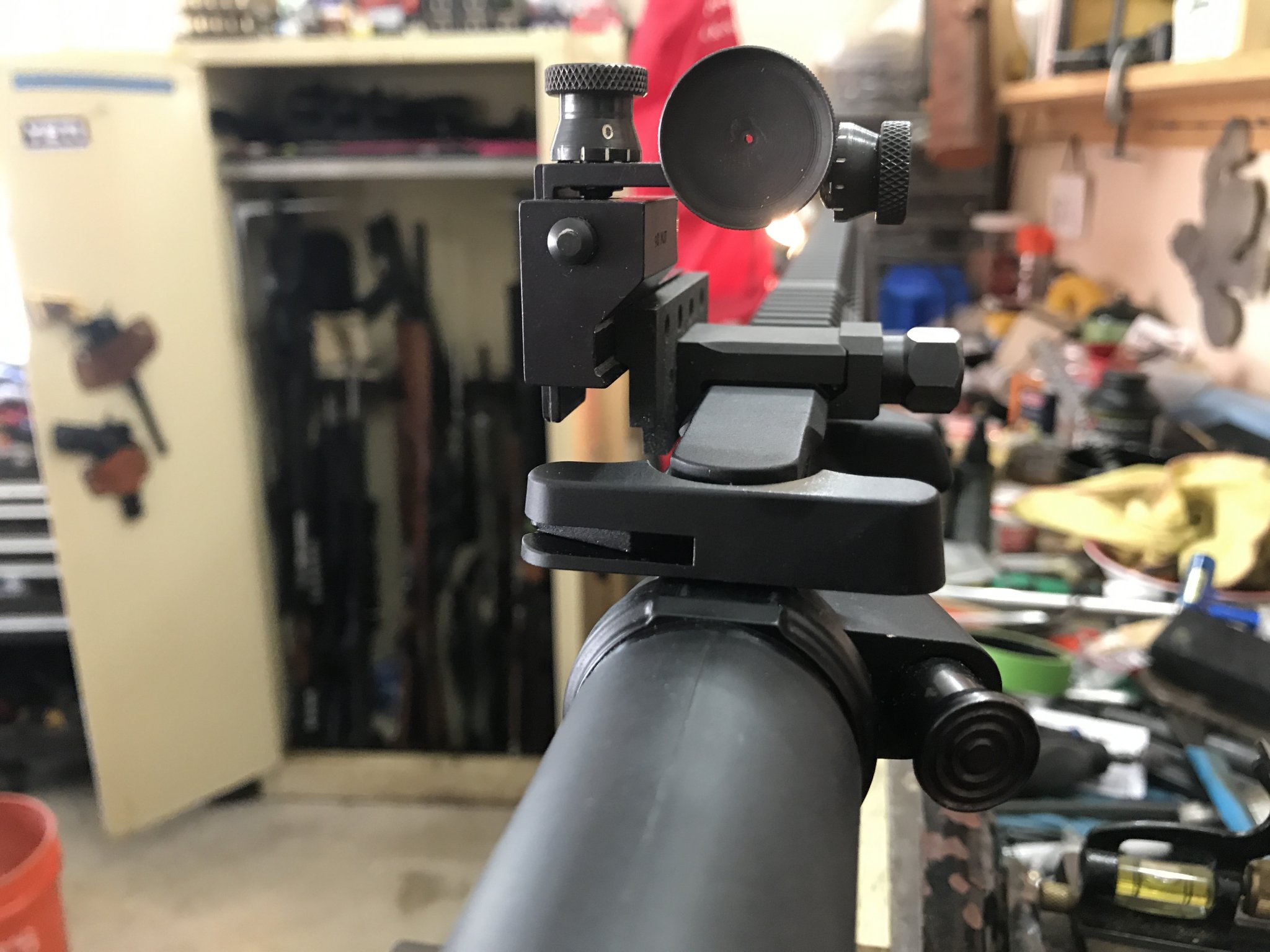

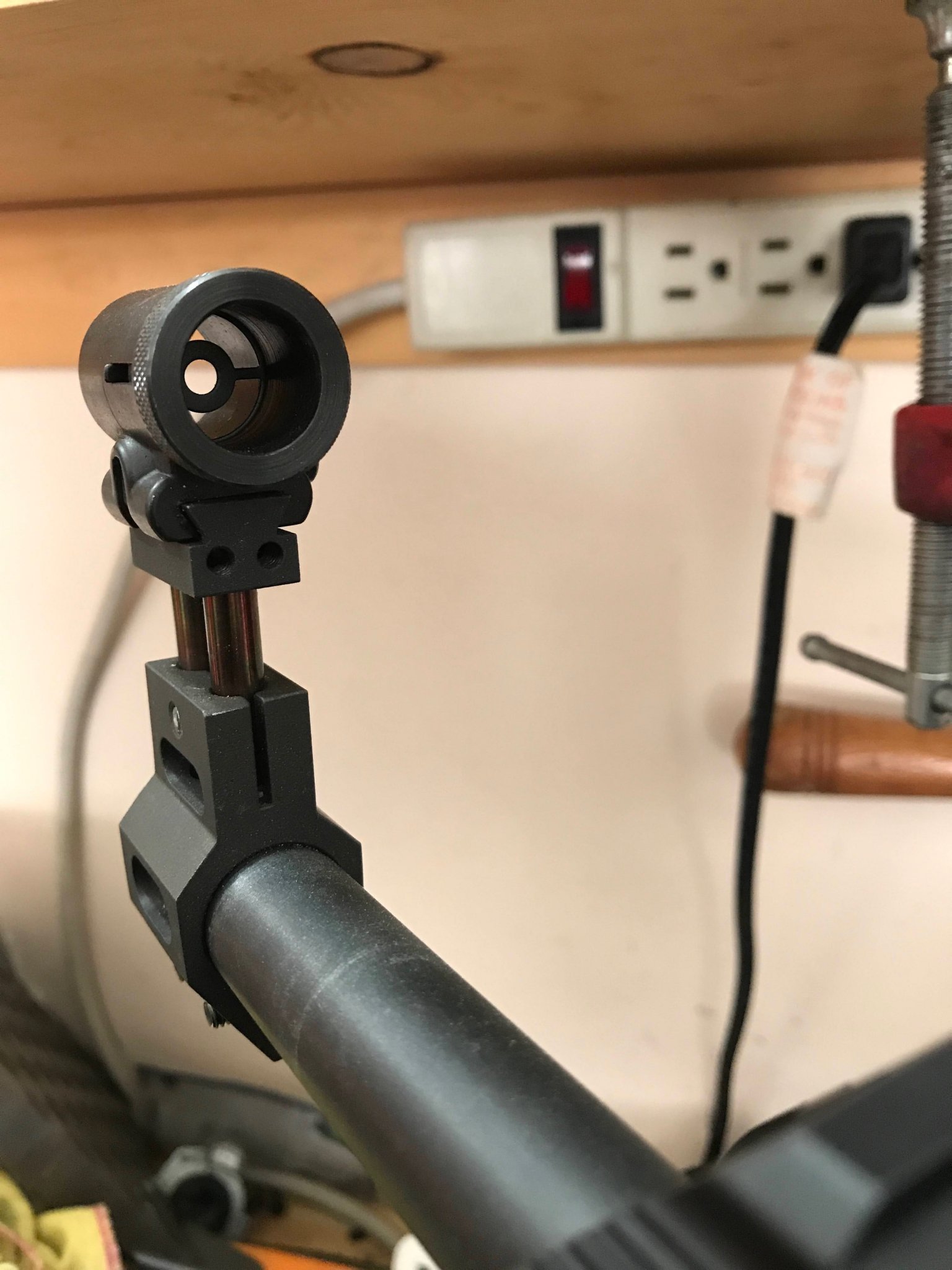

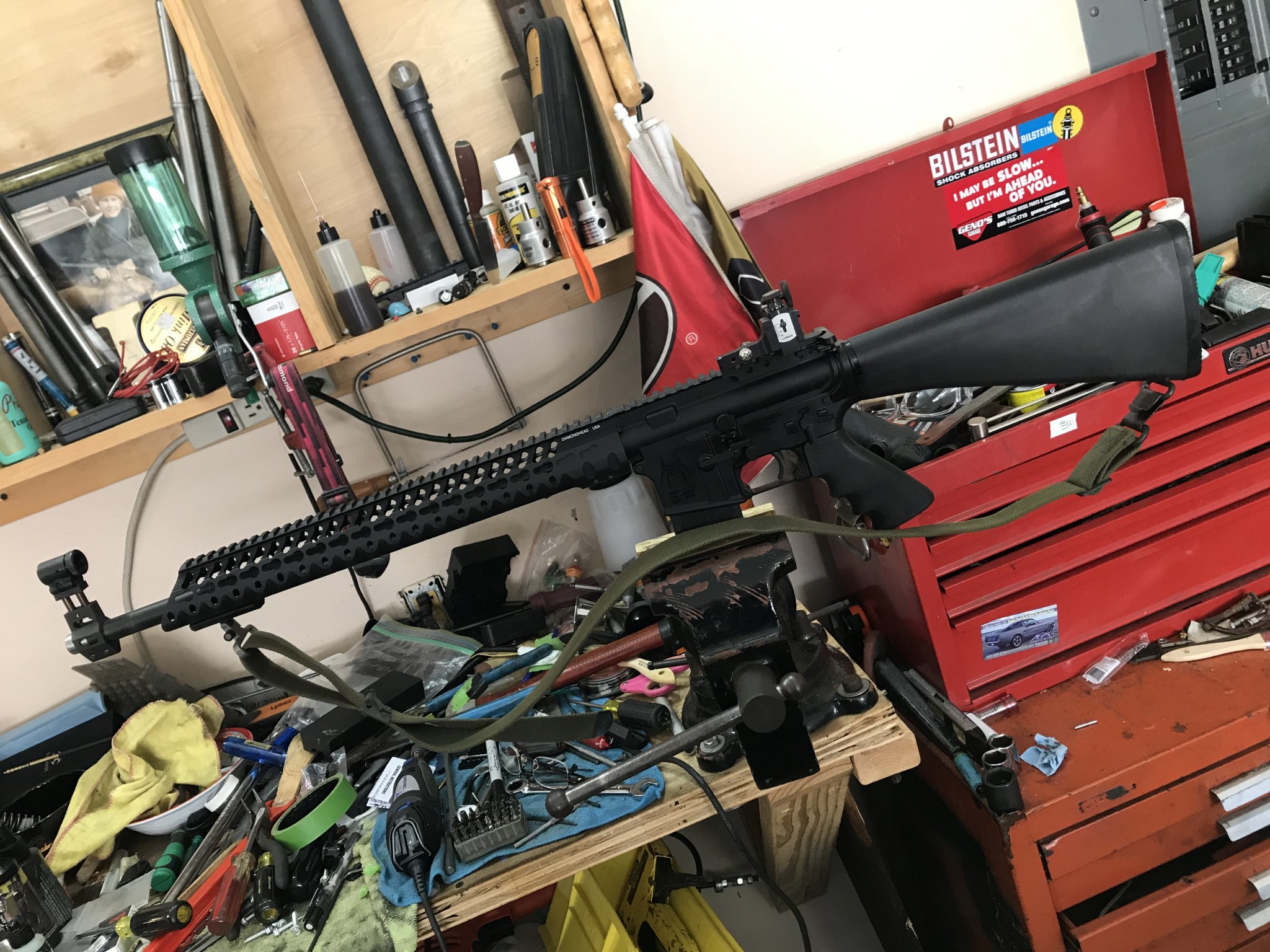

I purchased the front Ultradyne sight with muzzle brake. I can't recall the size of the aperture on the front post but it wasn't large enough. I found that it pretty much blocked out the target. I modified a standard A2 front post to work in the ultradyne sight. I prefer that much better. The reason I went with the ultradyne was because I liked pushing the sight out all the way to the end of the barrel. Max sight radius.
On another note, I did source some Lipski sight bases and mounted the Lyman target sights on a 20" CMMG Rimfire AR. I haven't done this on a CF AR but I love the sight picture this setup makes. I did purchase the Medesha Sight bases (front and rear). They'll work with this kind of set up too. Here's the front base with an A2 carry handle on another AR22.

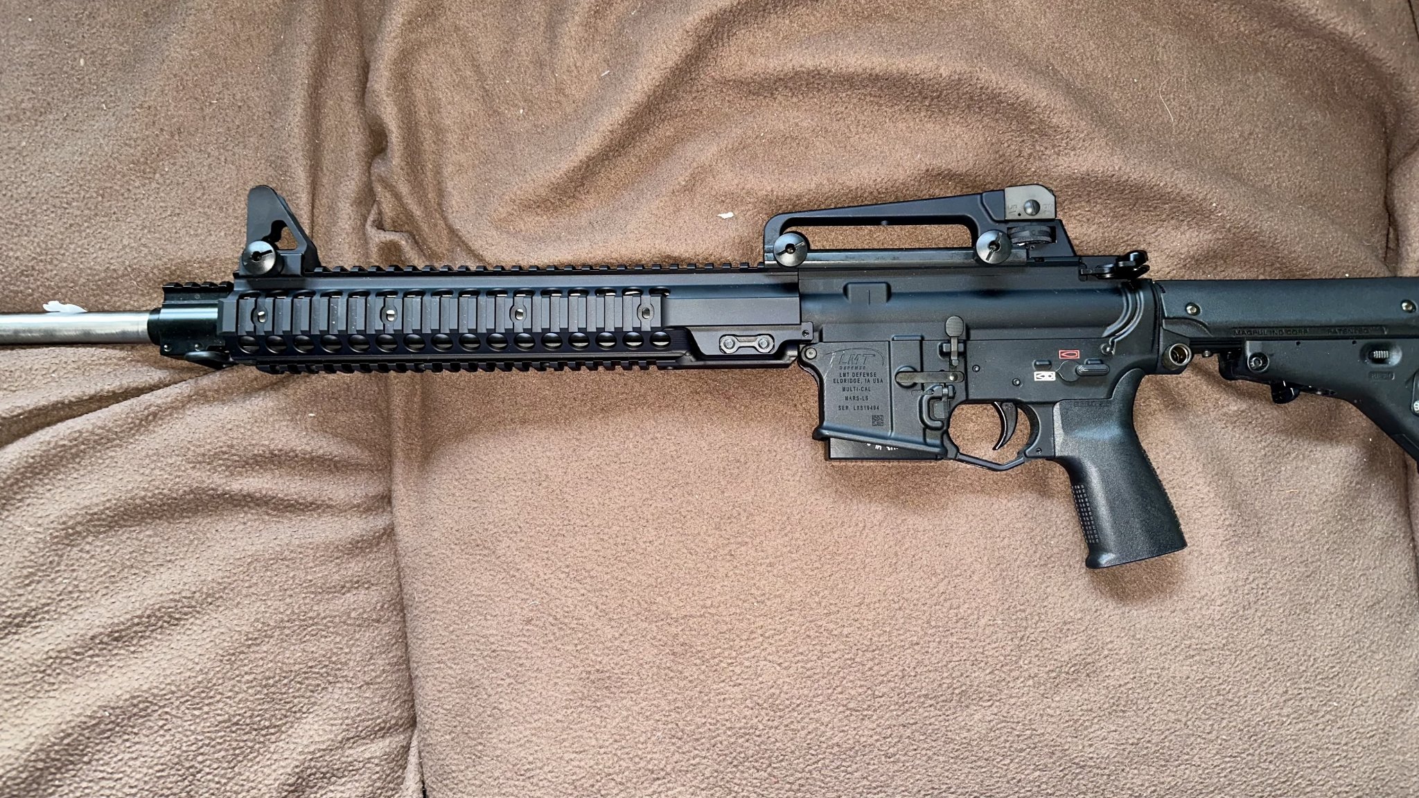

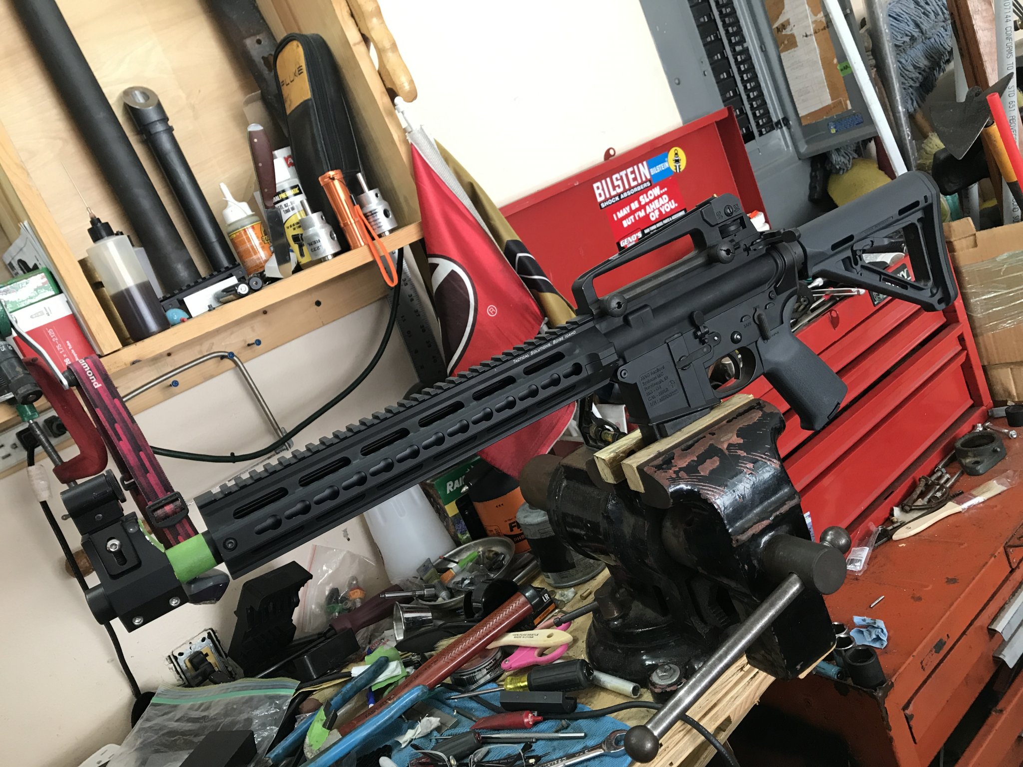

Went with Service Rifle type sights.
I purchased an ’F’ Type front with 0.074 square Post and modified 1/4MOA carry handle rear with fixed long hood from Compass Lake.
Initially mounted the front on the rail but now moved to the gas block for elevation.

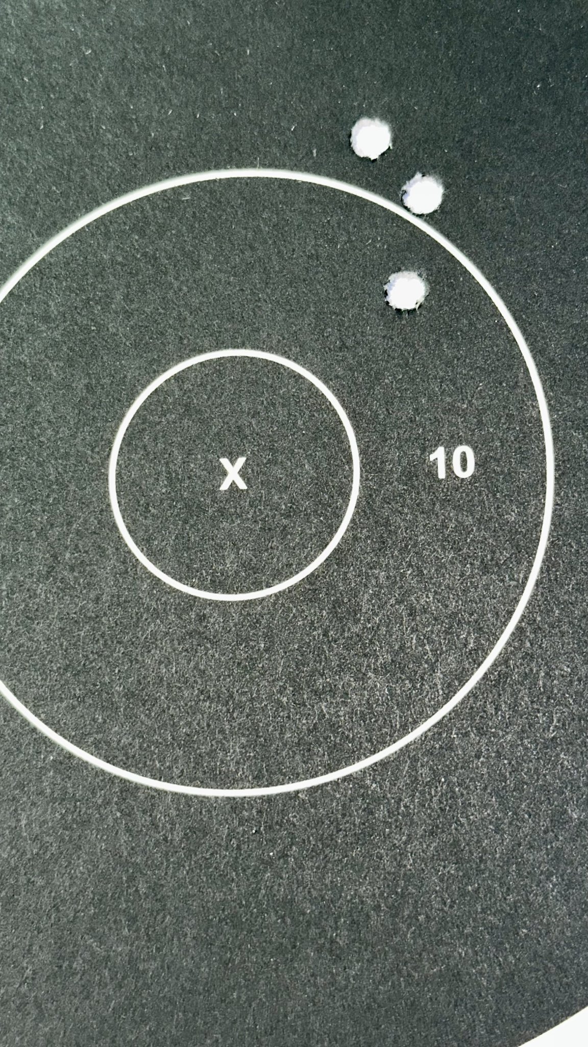

100 yd group with M193 shown.
My son shot this group with his second, third and fourth shots with these sights, so no ‘best’ group.
Only problem is that the rear elevation adjustment is CW or different from most US sold CCW scope adjustment. But have a NOS made by Hillenger of White Oak coming with CCW rear elevation.
White Oak does not sell these anymore and was sourced from helpful National Match shooter.
-Richard
-Richard
Iron sights and scope reticles moving opposite of each other ruined many scores early after scopes went into Service Rifle. Have fun, I think you'll enjoy that set up.
