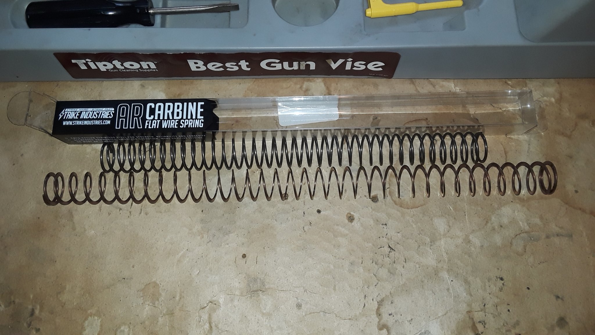

Im running this for a 6.5g 20 inch and 5.56 carbine.
An h2 buffer and flat wire spring.
Both uppers have agb.
