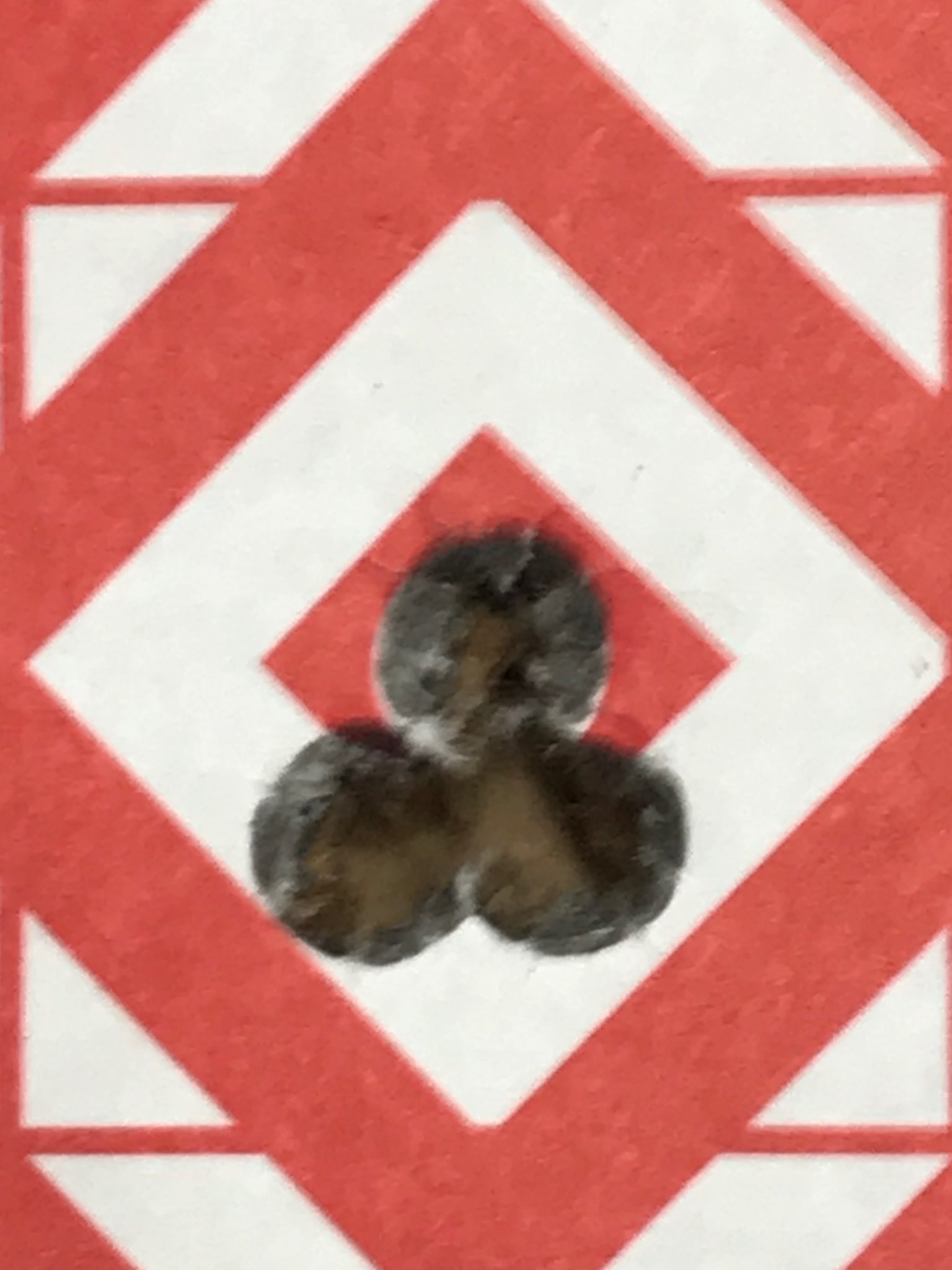

This system seems to have no negative effect. Here's my last group at 100 with Prime 130. I would have shot two more, but I was pretty sure I'd choke.

The DFC - You are correct.
The clamp that secures the scope mount base to the upper receiver, on the left side of the gun (not shown), does not bear on the forend.
Yeah-I've done that before and have never seen a negative effect either. It's the end of the world to some though o_O
