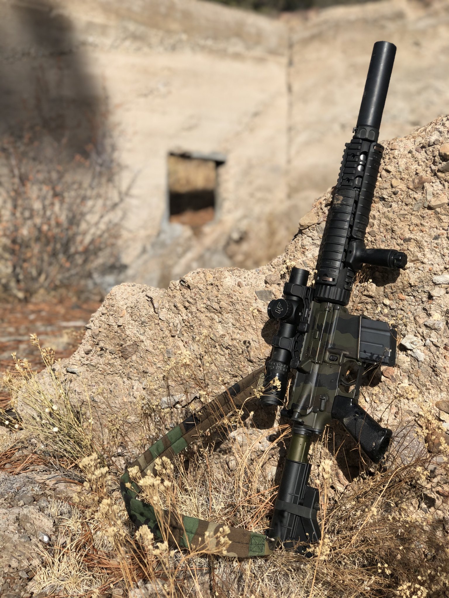

I run a 30 cal on my 5.56 gas gun. It does good and I’m happy with it. The can is a YHM Phantom, so I don’t/can’t speak on direct threads for it since I use the QD version. I do use a SA adjustable gas block on the gas gun. I have used that can for almost 10 years now. I’m sure there are better cans and some will argue to use a 223 can on a 223 gun. This is just my two cents and what has worked for me so far.

Old or not, I’m really happy with my RC2. The complete system with the suppressor, bootleg carrier and PRI gas buster really tames the gas and the poi shift was only 1.4 Mils straight down. Definitely not “quiet” on an 11.3” 5.56, but it does reduce the sound, flash and blast considerably.
