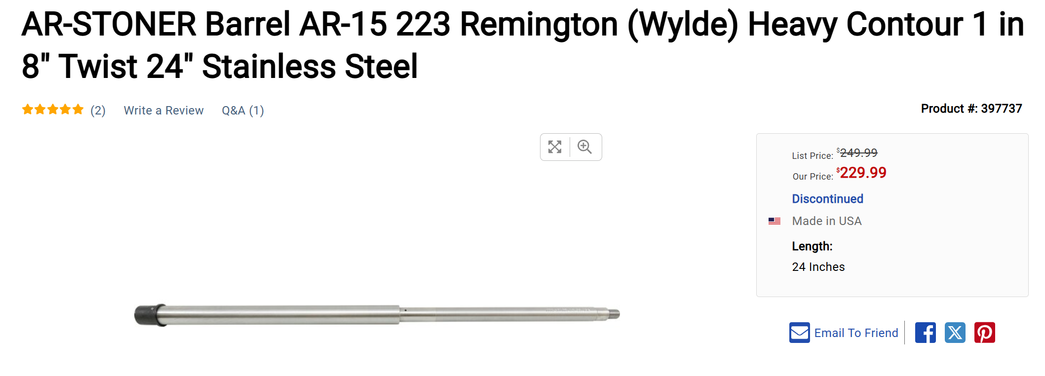

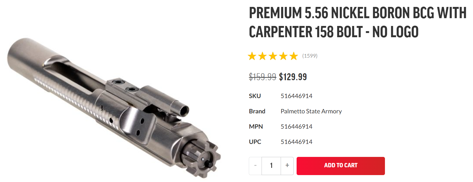

1. Not necessarily unusual. My $99 AR-Stoner Barrel (MidwayUSA budget bin) + $99 Palmetto State Armory Bolt Carrier Group (also a Saturday Sale item) have a headspace at exactly SAAMI maximum. The sheer volume of these parts being thrust into circulation also results in a sheer volume of inconsistencies and variation - and in my case, one of these barrels paired with one of these BCGs just so happens to have the tightest headspace in all my rifles. For context, my Tikka bolt action rifle has a headspace of SAAMI maximum + 0.001".
Yes, both items were on sale at $99 each, once upon a time - I have three of the first, and a bunch of the latter :ROFLMAO:
