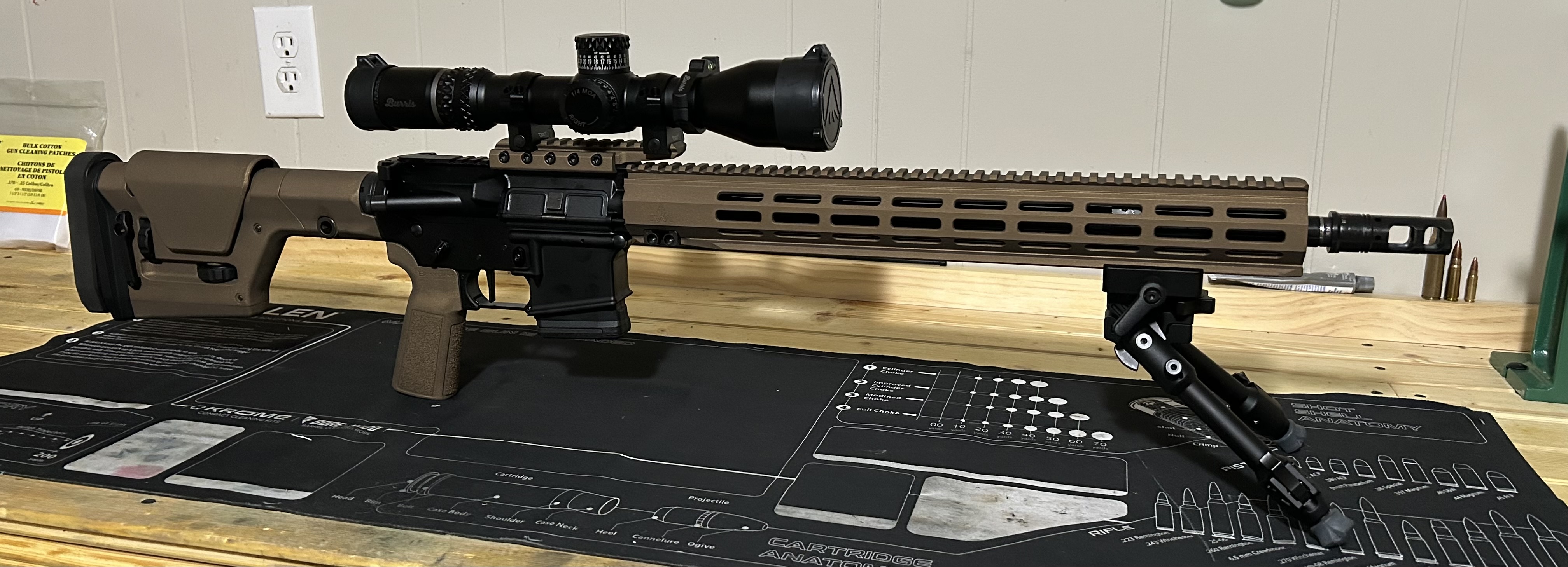

Hey guys, starting to get in to long range AR platforms…… so I went with the IWI Zion SPR… for $1,200 it seemed like a great rifle. My suppressor will be home soon……I upgraded a couple things anticipating suppressor use…. Radian Raptor SD charging handle, geisselie super 42 spring & buffer (H2). Rifle already has an adjustable gas block…. Suppressor is a sure fire RC2… any thoughts on this set up, good start? Any suggestions outside of this setup? Thanks !

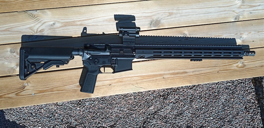

Me and a friend did a test on the IWI spr this summer. We found it to be a nice rifle and it sounds like you have it figured out with the parts selection.
I think you will be very happy with it.

I bought this rifle for a monthly local steel challenge match, the range just started a gas gun class last month…. Distances are out to 600y….. thought this would be ideal….. I’m incredibly green when it comes to suppression so I’ll learn all I can, just didn’t want to be an asshole on the firing line, lol
Reactions: VargmatII
Really? What would you say would be the weaknesses, if any?
Yes, really.
It shot very well with 55grain FMJ, but did not seem to care for bullets heavier than 69 grains. We shot Norma GTX, PPU 75 and some Ruag 77 grain.
Other than that, fit and finish was great, trigger is awesome and the rail is very stiff. I am not too happy with the full length arca, as it is not that nice to grab on to. But can make it work and for resting on a barricade bag and similar, it works very well.

One question I have is about scope mounting position….why does everyone seem to mount the rear of the scope even with the charging handle? ….figured it allows better access to the charging handle, however it gives me better eye relief if it’s mounted an inch or so behind the handle…..???
Because that is the position that they get the best eye relief.
I am guessing you probably have your stock adjusted to about one click out from collapsed.
Most people don't shoot with such as short length of pull....but I do.
On this rifle I have a Magpul PRS stock, so it’s not adjustable… otherwise I use the 2nd stock detent on my other ARs… but your saying eye relief trumps charging handle access, I agree, but regardless it seems everyone has their scope mounted even or close to the charging handle

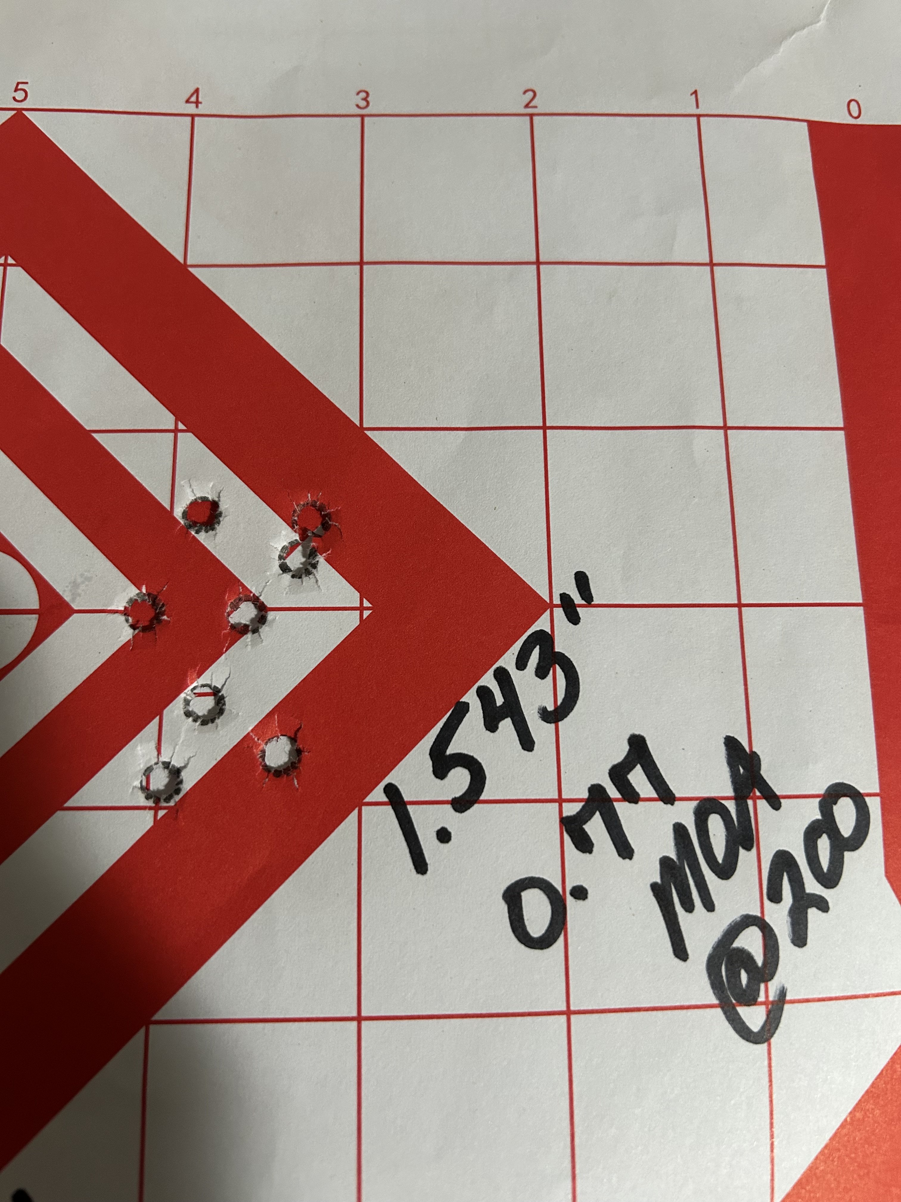

Finally got it out and shot it (without suppressor)….. was very Impressed, moa easily….. was shooting hornady frontier 68gr 223 ….. 10 shot groups with 7-8 rounds in under 1/2”……. Slightly under gassed, ejection was 4- 4:30 ……62gr Aguila shot like shit 3-4 moa….. I’m thinking gas will be pretty close when using can……. Was incredibly pleased with its accuracy today

This is a very late post, I’ve been real busy…. I’ve got bout 400 rounds through this rifle now and man it’s a shooter….. I mostly shoot 68gr hornady frontier 223 due to price and availability. Hard to shoot consistently when it’s hard to find some of the other stuff….. however it’s shooting the frontier very well out to 500y….. wanted to show my last 8 shot group at 200y, I think I’ll keep this rifle around, also did a little cerekote y’all might like….
