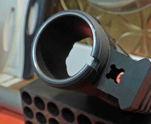

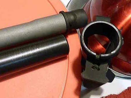

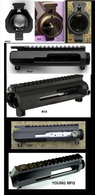

I like the side charger. The Mega IS THICK.
I have 4 BCA side chargers, not quite as thick, not the same quality as the MEGA, but still more metal than normal.
A lot more metal than the threaded nose.

EDIT: The MEGA upper (and it's little brother the BCA side charger :) ) have lots of strength behind the threads.
7075 helps. Big heavy barrels seat against a thin flange at the very front of the receiver.
