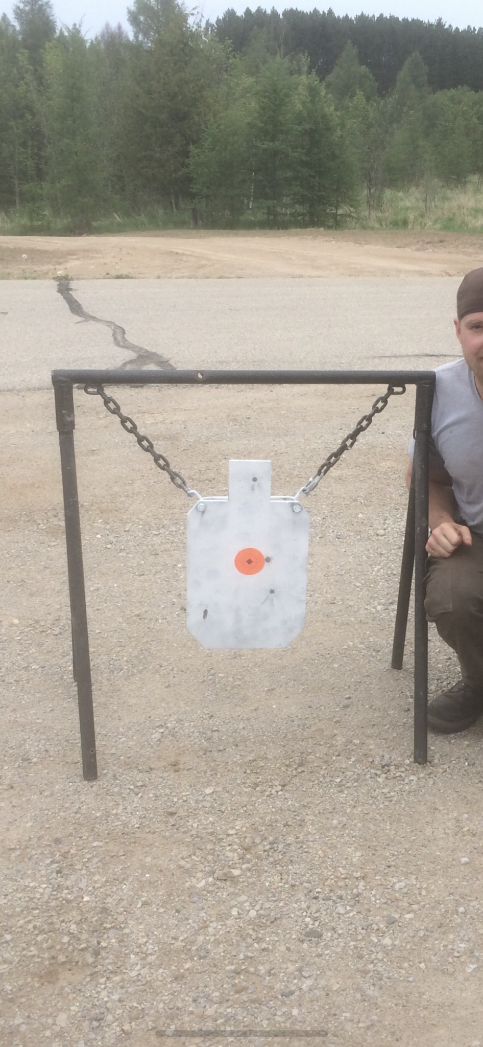

As mentioned above the biggest thing will be how you mount it. Mine angle down slightly so the bullet deflects to the ground vs shrapnel getting sent everywhere. Also hangs on chains from a steel sawhorse designed stand I made
The ability to swing when hit I’m sure helps a lot with the wear on it. I’ve shot this target inside 50 yards with 556 55 gr FMJ without issue

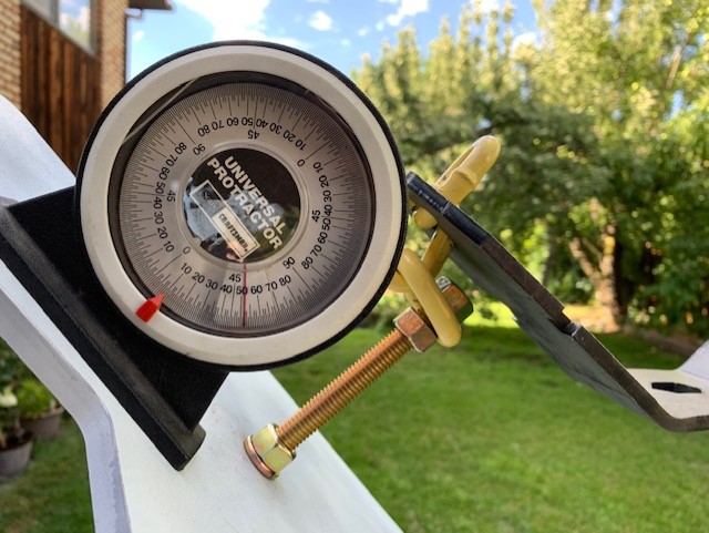

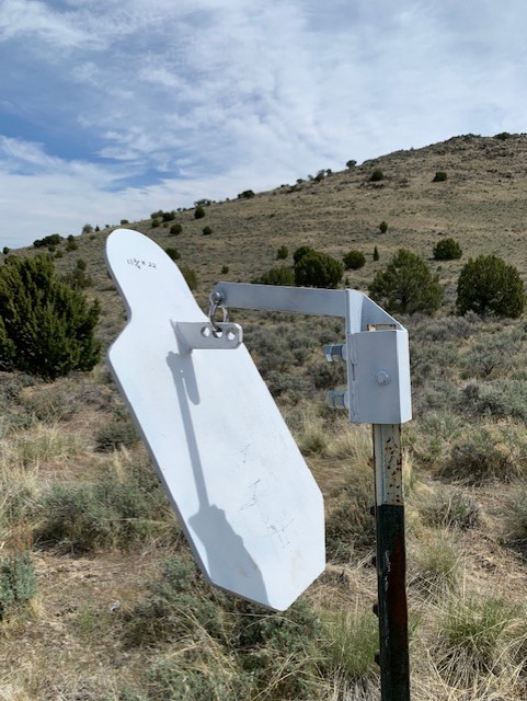

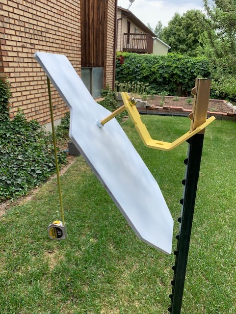

Regardless of how thick the steel is your best option is to find a way to mount the target so it sits at an angle so it deflects part of the energy down into the ground verses the plate absorbing all of the bullet impact. The German's figured this out in the early 1940's with sloped armor on the Panther and Tiger II tanks.
