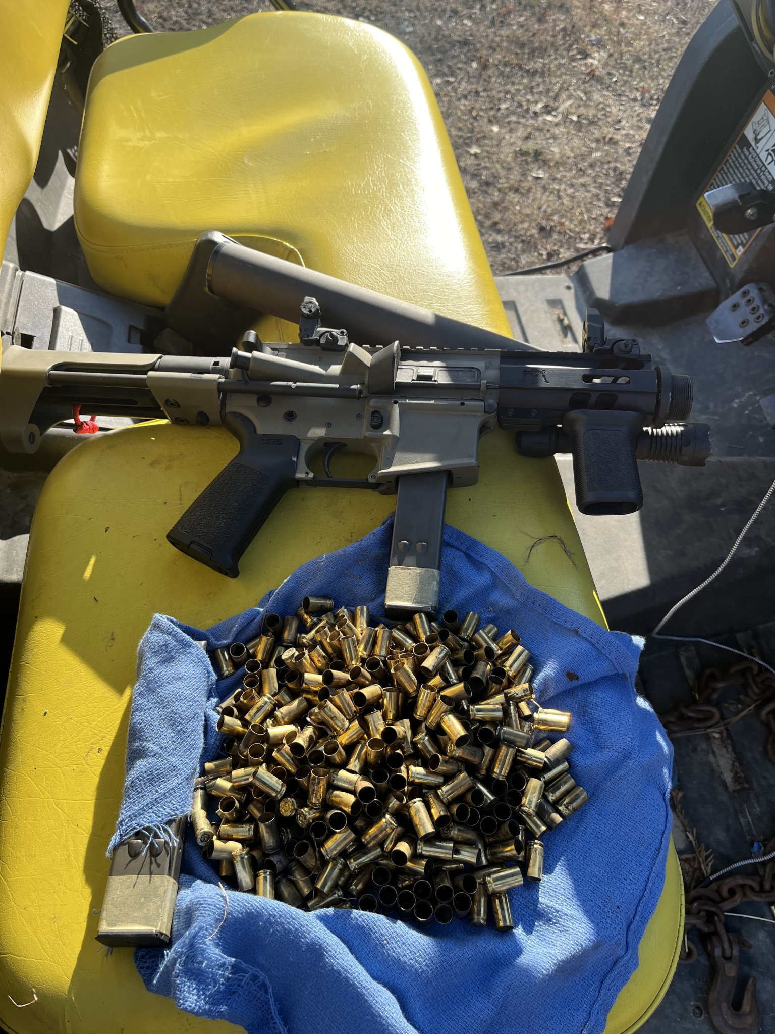

I built an AR9 some years ago using a quarter circle 10 reciever, barrel, and jp bolt. I couldn’t get my favorite Larue MBT triggers to work so it ended up with a milspec from the spare parts bin.
I have put a few hundred rounds through it and it started to burst fire at the range so I pulled it apart and inspected the trigger but didn’t see any issues. I replaced with another milspec and same thing happened.
I see there are PCC specific triggers, is that because normal AR triggers don’t work? Is there something else I need to look into as to why it keeps burst firing?
I have built a handful of ARs without issue so I don’t believe it’s an assembly problem, but anything is possible.

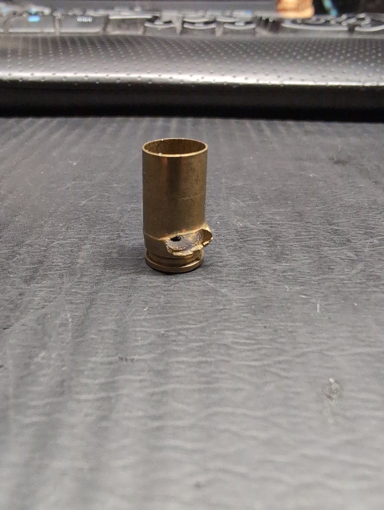

This is from an Olympic Arms upper in 9mm from about 25 years ago.
Is that OOB detonation, or early extraction? Or maybe even a not fully supported chamber?
It was OOB, needed a heavier buffer and the trigger would bounce when the buffer hit the back of the tube hard. Result was hammer following bolt and hitting firing pin when cartridge not fully in.
For those who don't know- on a regular AR with locking bolt a strike on the FP before bolt is locked will not fire a cartridge as the FP is blocked until the bolt rotates.
On these simple blowback pistol caliber guns, the bolt has no safety feature or rotating bolt so the firing pin can strike before bolt is fully closed.
I had two OOB out of thousands of rounds. Once I put in heavy buffer, it was fine

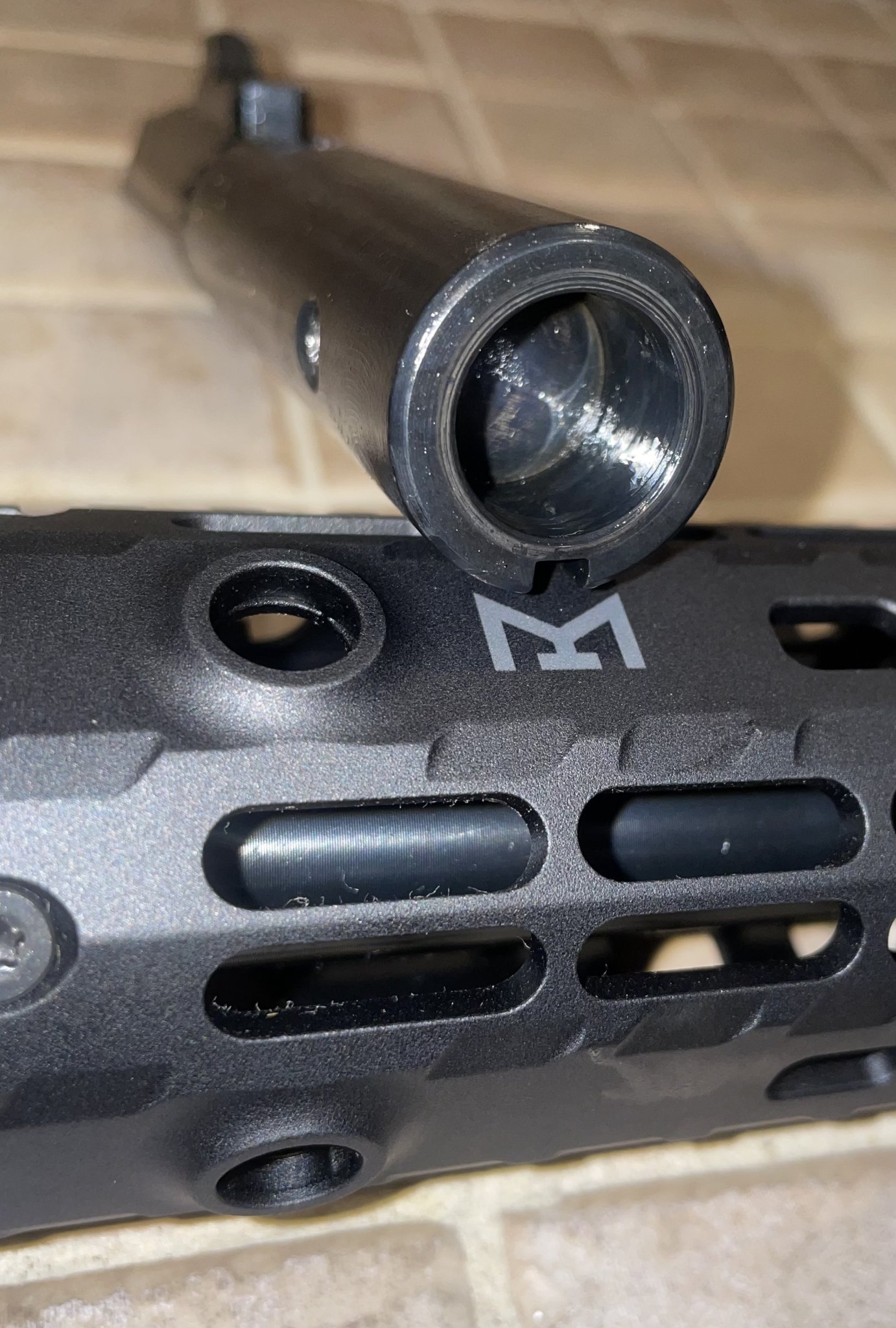

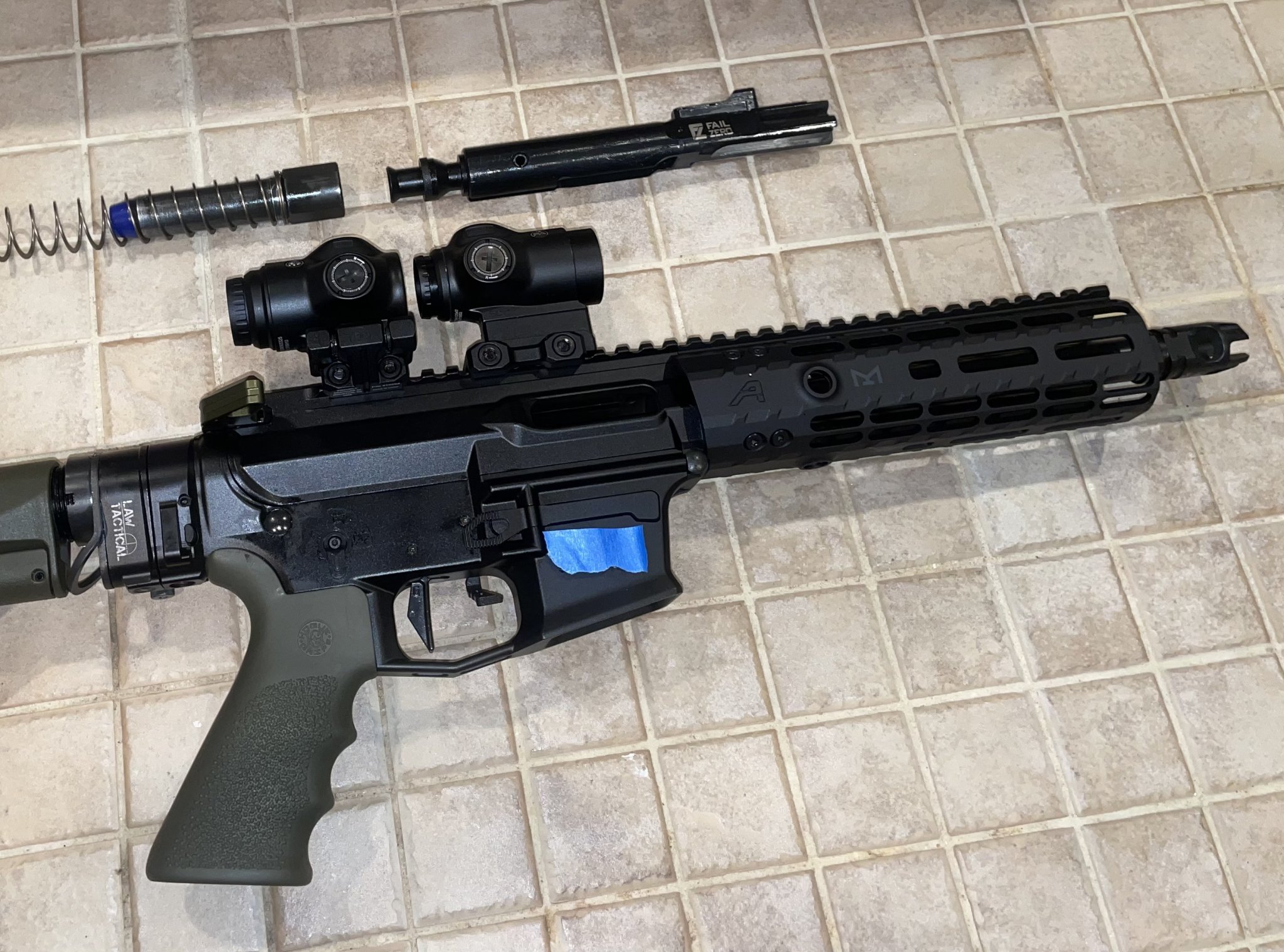

These blowback PCC’s are so popular, but few people actually tune them correctly. Or they just run them the way they came out of the box, which shouldn’t be a problem. Except manufactures are often underestimating the buffer weight.
I highly recommend you increase your buffer weight and slow your cyclic rate. Even with low power factor cheap 115g 9mm ammo (worst case scenario), I have no problem with cycling and locking back on empty with a 8in barrel and using a 10oz buffer, a bolt with an internal weight and the standard Law Folder 2.2oz carrier extension.
Buffer I highly recommend is the Midway USA 9mm extended heavy buffer Midway 9mm buffer.
Website I highly recommend and videos to watch how a 9mm PCC cycles and how to better control dwell/cyclic rate. This will directly relate to solving 9mm ar platform trigger issues.
Blowback 9
In summary, I run a…
flat wire standard strength buffer spring
10.8oz buffer
2.2oz law folder adapter weight
Fail zero 9mm bolt. (Internal weight modified, and compatible with law folder)
Geissele SD3G trigger (not made for blowback, due to some guns having harsh bolt speed/cycling)
Aero EPC platform with 8in barrel.
This combo runs perfectly, always locks open on empty, smooth recoil impulse, cyclic rate is slow and reliable compared to cheap AR9’s with light weight buffers. Proof is that I haven’t broken the Geissele trigger even tho it’s a blow back operation. About 1k rounds down the tube. Since the cycling action has an appropriate amount of weight, it is only about as harsh as a regular ar cycling on the trigger.

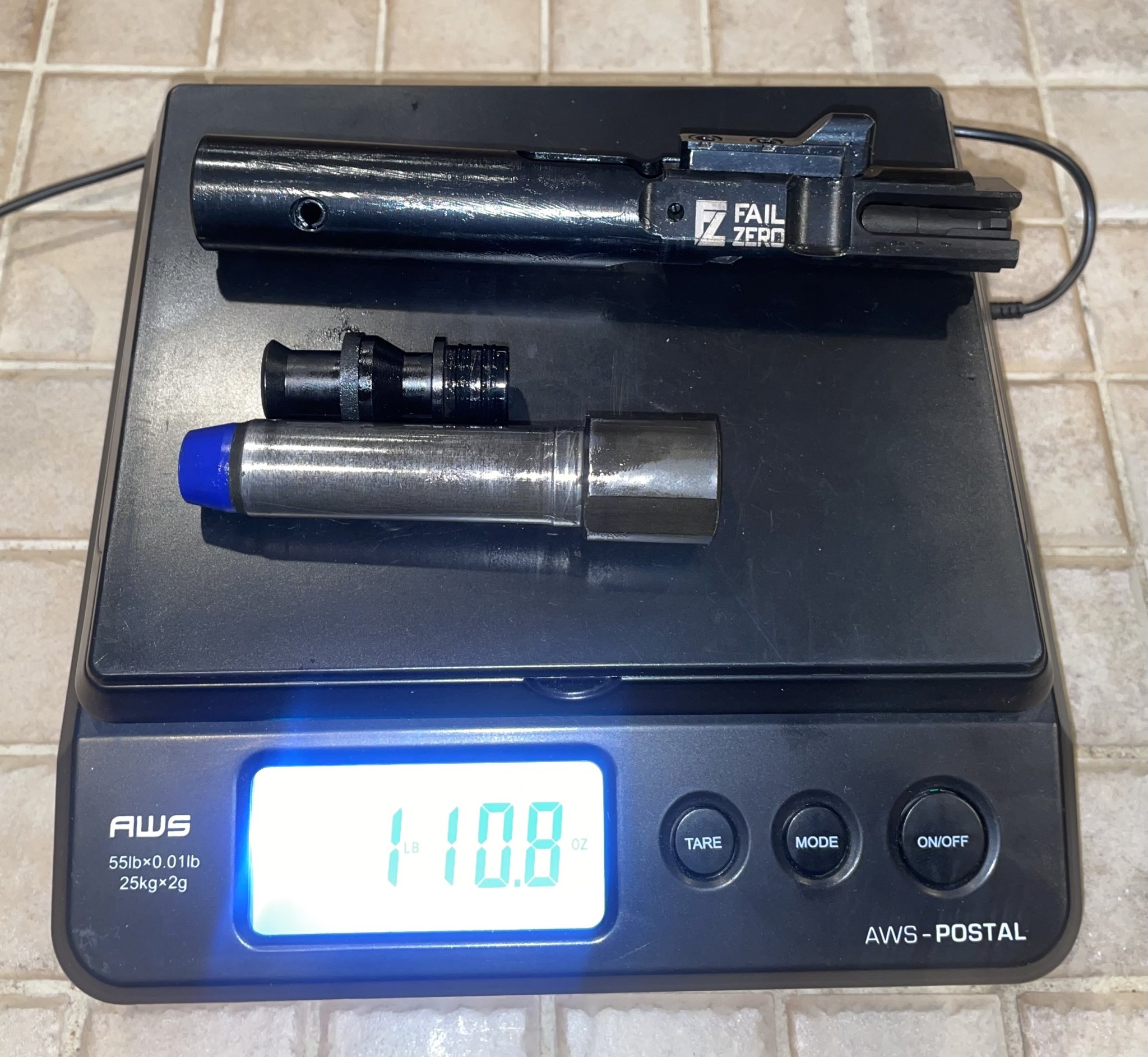

Great info. I will weigh my buffer and bolt tonight. Reading on JP’s website it seems that they have changed their bolt and buffer maybe. I would describe the recoil of mine as harsh, which I was quite surprised at.
It’s a 5” with a suppressor.
I shopped around a good bit and planned on using the JP system. However then I found all the info on Blowback9. If I remember right, the JP was no where near heavy enough.
That makes sense, because mine feels like the bolt is slamming hard into the back of the buffer tube in recoil. I just figured that’s how it was assuming that JP would be perfect using their bolt and recoil system.
I will weight it all tonight.
