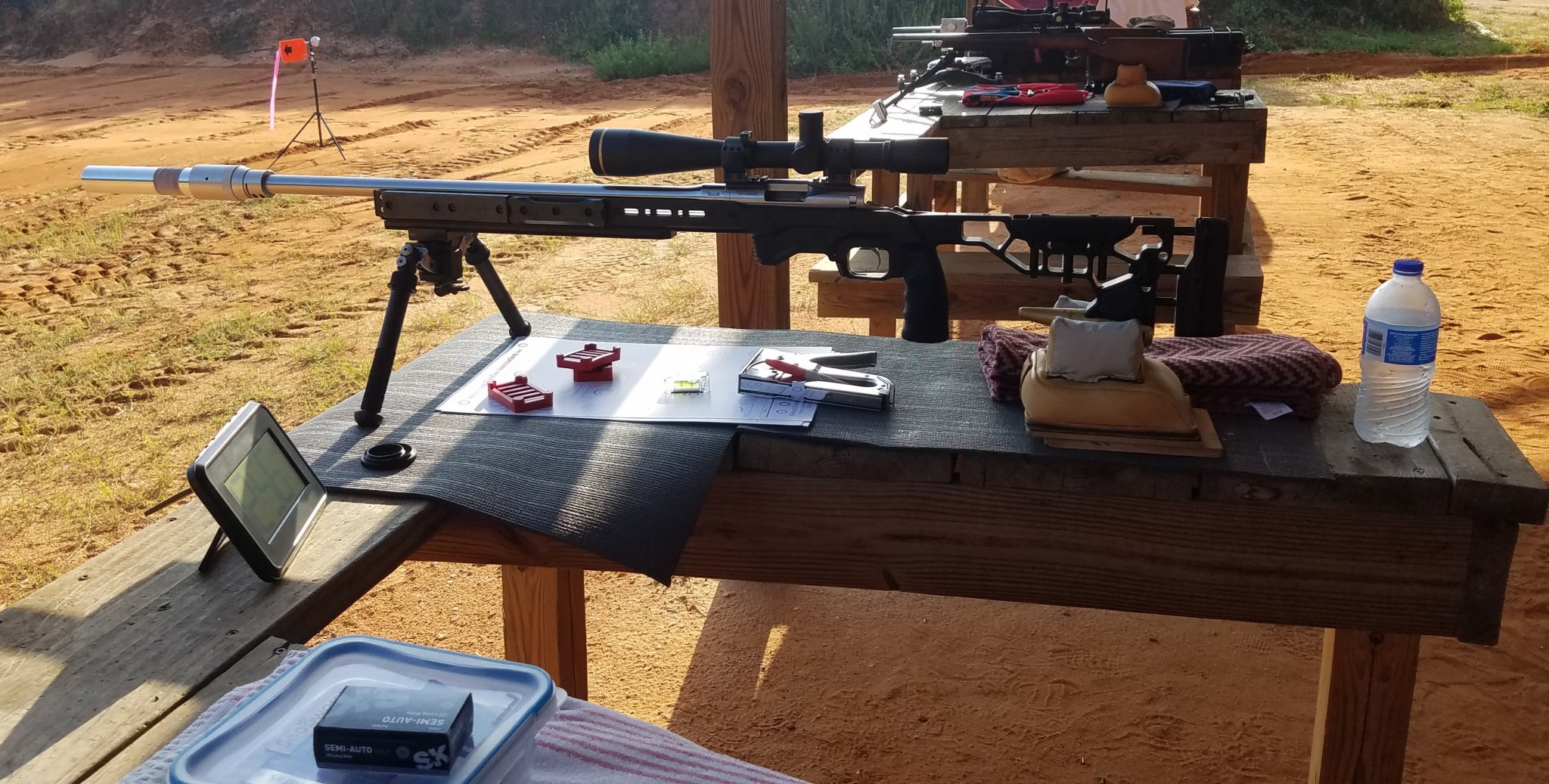

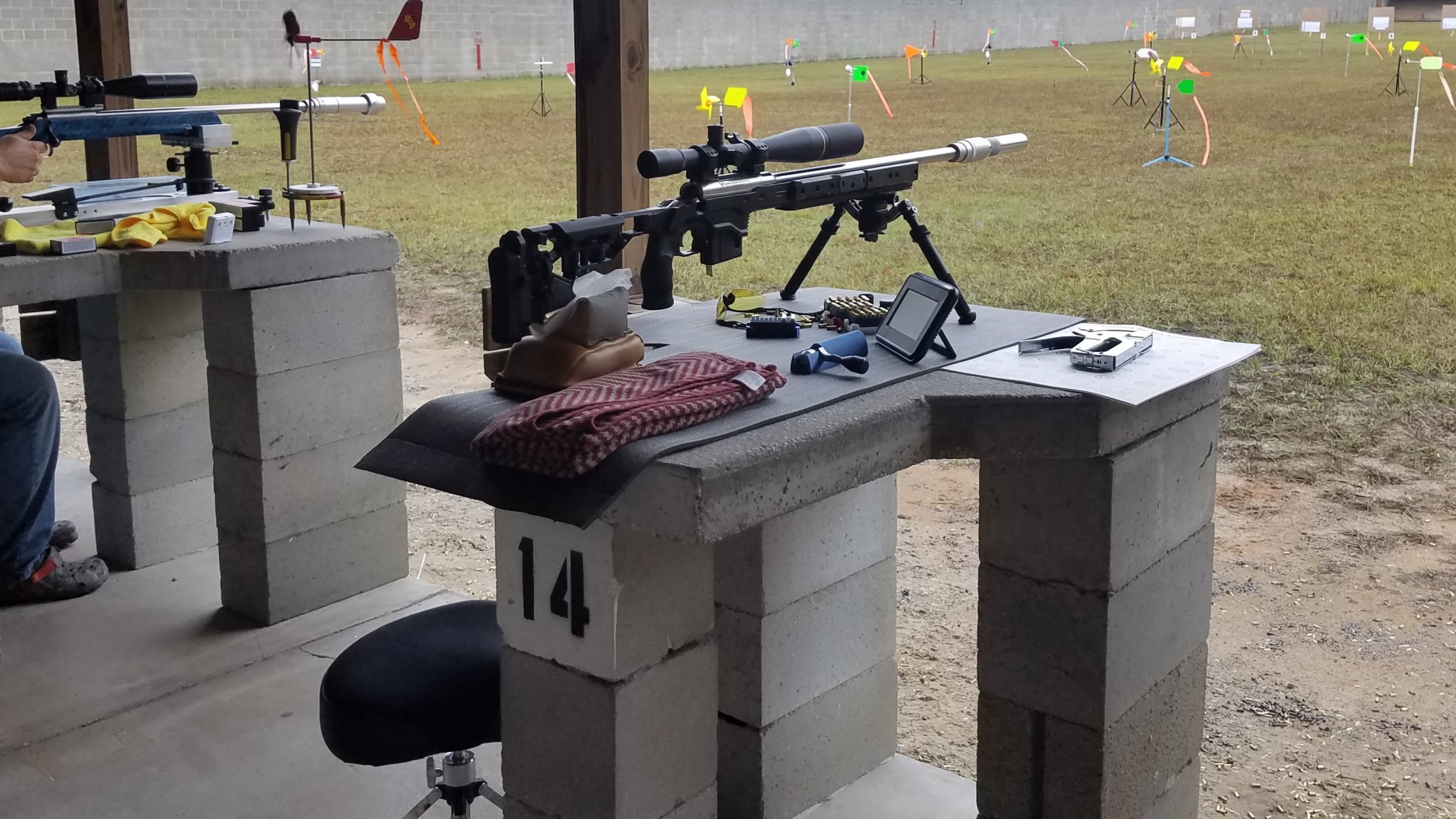

Shot at a new club yesterday, meet a great group of people and had a good read on the conditions. Here are my results.

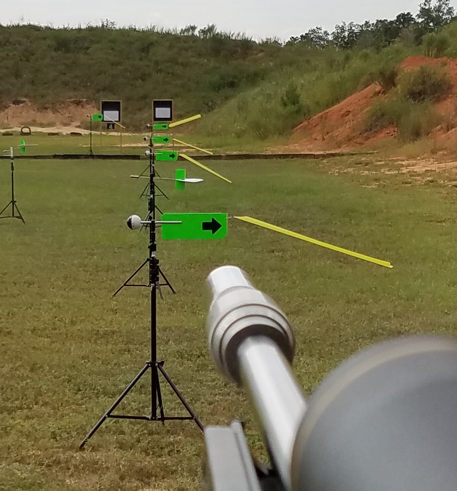

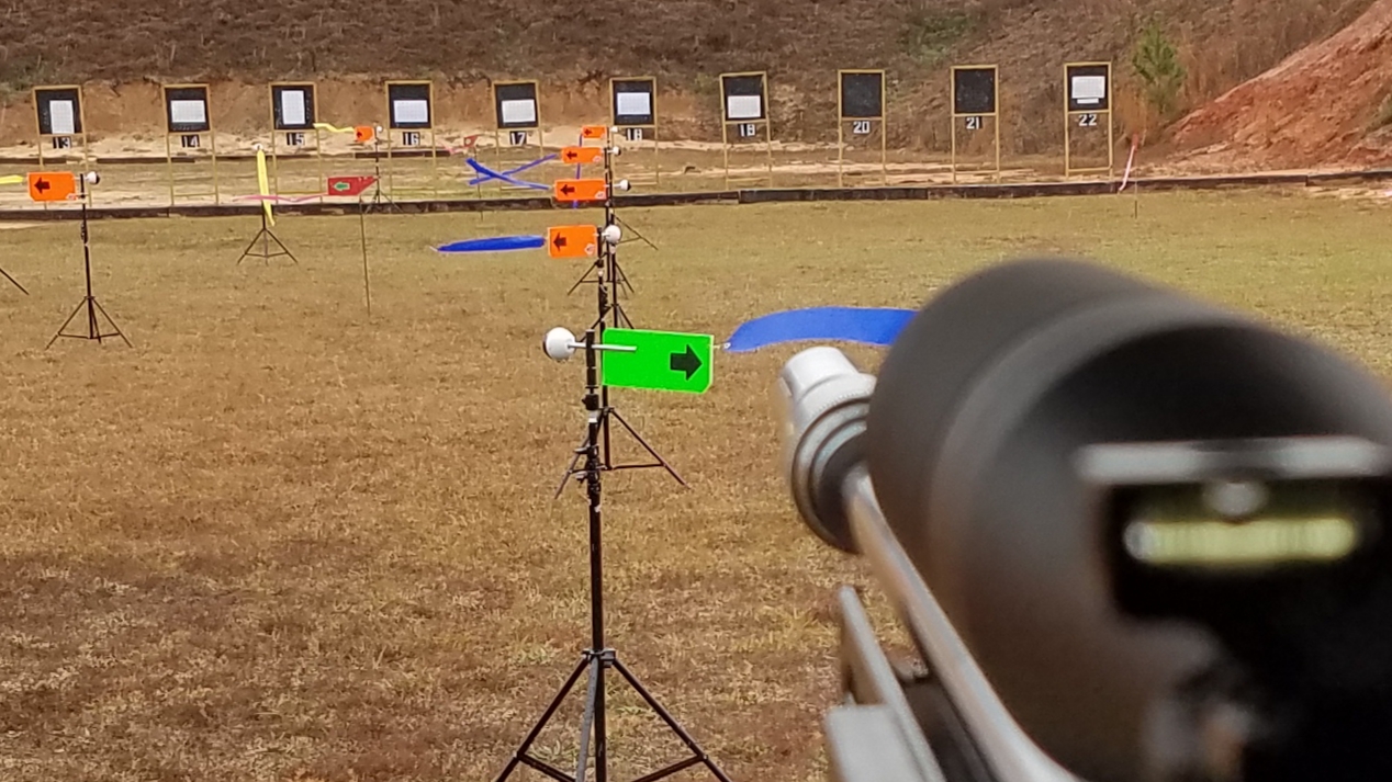

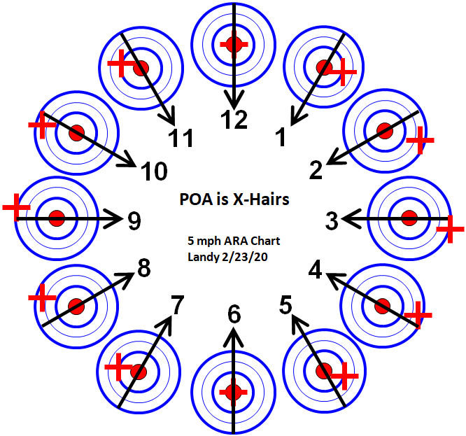

In general a wind from the right will push a bullet left and high. A wind from the left will push a bullet right and low. The harder the wind, the higher or lower the bullet will go relative to the push. Headwinds and tailwinds can make a bullet go high, low, or seem to do nothing. If you don't have flags you're just guessing and that is going to make it worse as it can change fast and you don't realize it. On top of that, all of your windflags will not show the same condition, you will have to determine what flags seem to be telling you the most. Most of us run 5 or 6 flags.
There are wind charts out there depicting this, but I think new shooters rely on these a bit too much as they take them as gospel. It doesn't always do what you think it will or what the chart says.
The best advice is to shoot sighters and see what your flags are telling you for that condition. Try to pick one condition and shoot it. Don't try to adjust all of the time to changing conditions. Sometimes you have to if time is running out, but use all of the time you can. Sail tails are an important aspect that help you determine how hard the wind is actually pushing. Shooting an ARA card at 50 yards for score is very different than shooting an NRL target even at 200 yards.

Do you have a reference for wind holds? I know I had read some stuff on an old rimfire site about wind holds.
Yes Sir.........the one Hozzie references to is what I found to work best for me. It's not exact but gives you a good idea what to look for and where to start from.
The more you shoot over flags, the more you will pick up on how the bullet is affected.....just takes some time.
As a side note......I want to say thank you to Mr. Landy for taking the time to make this chart for us.....just in case he sees this post.
This thread on RA may be of help for more info.
Well said Sir!!
I agree, I used this chart as a starting point to reading the wind. It gives you the basics. Again, thanks to Landy.

I put a lot of work and time into designing those charts, as well as attempting to explain how to use them.
I may have slightly failed with some of the explanation part because the comments I've seen over the last few years aren't quite how I envisioned them being best used, and at some point, I may make an addition to the original thread on Rimfire Accuracy with a few thoughts.

I have found your charts to be very helpful. For example, I'll shoot a card using sighters for my holds and then create a composite group using OnTarget (which you also steered me towards). I look for a lobe or grouping that hurt my scores and refer back to your chart to tell me what condition I was missing. Then I watch out for evidence of that previously missed bothersome condition the next time I shoot. Thanks.

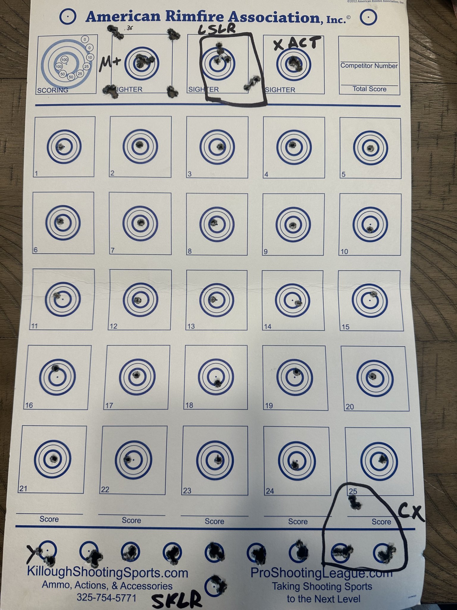

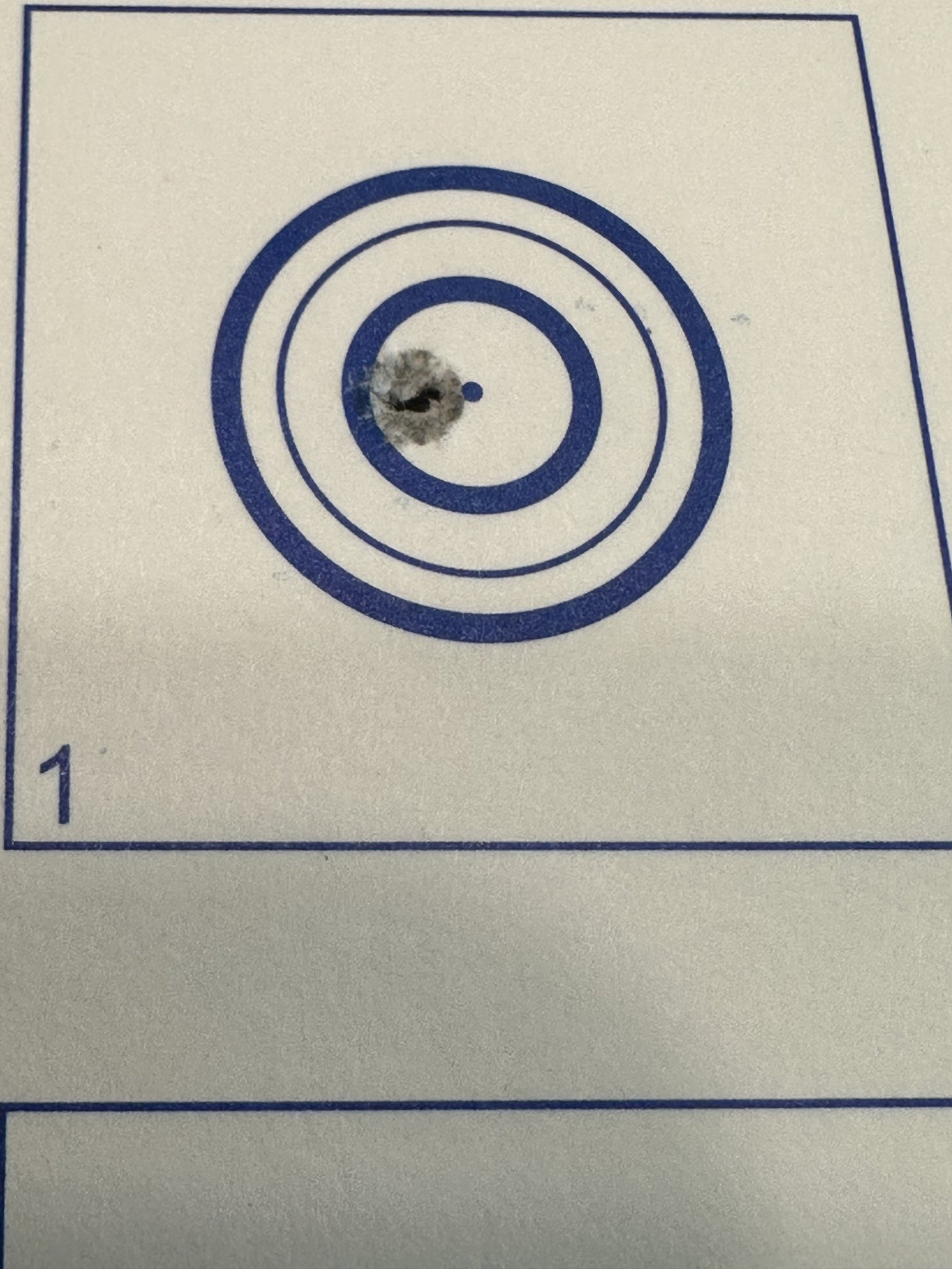

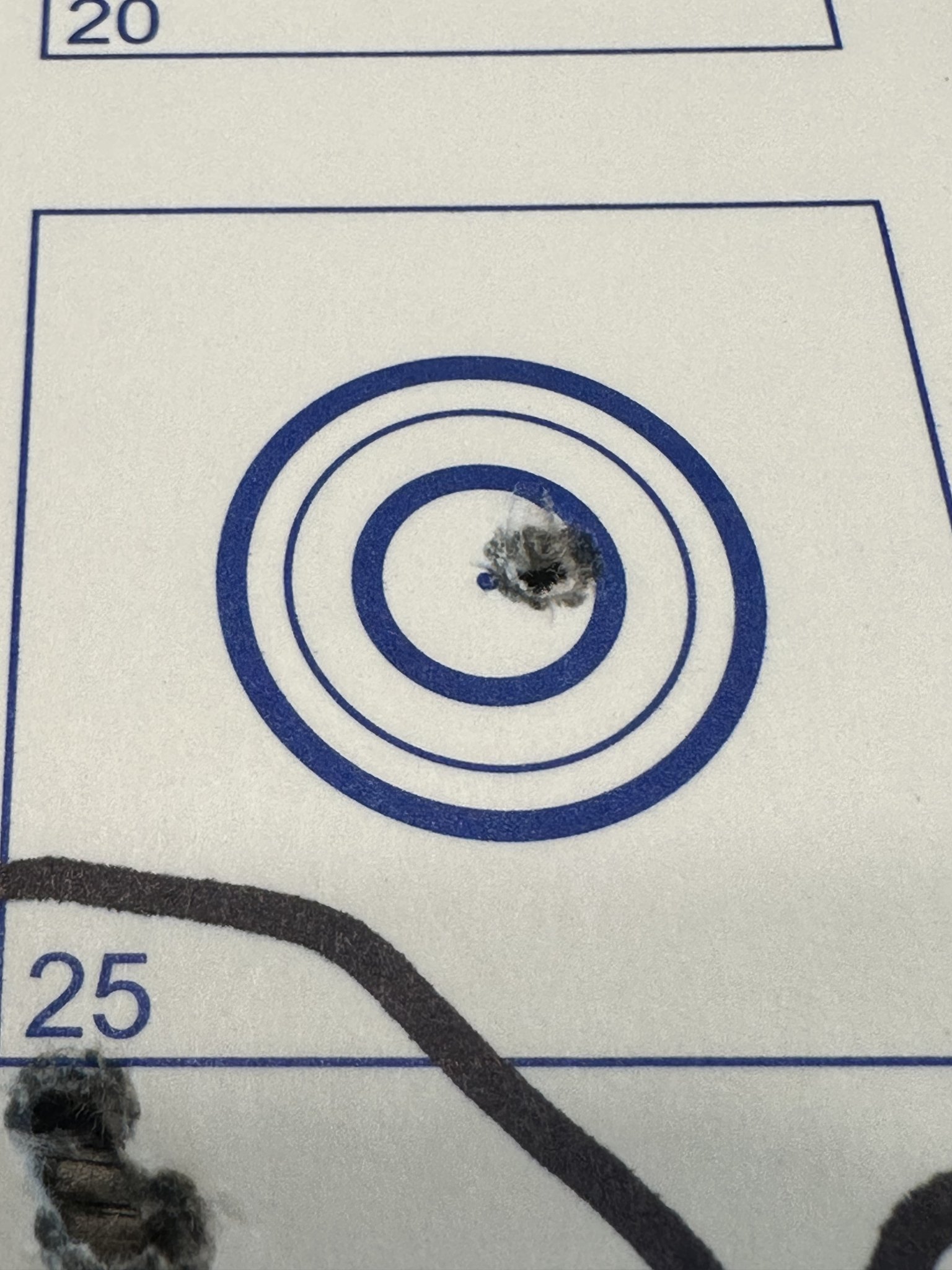

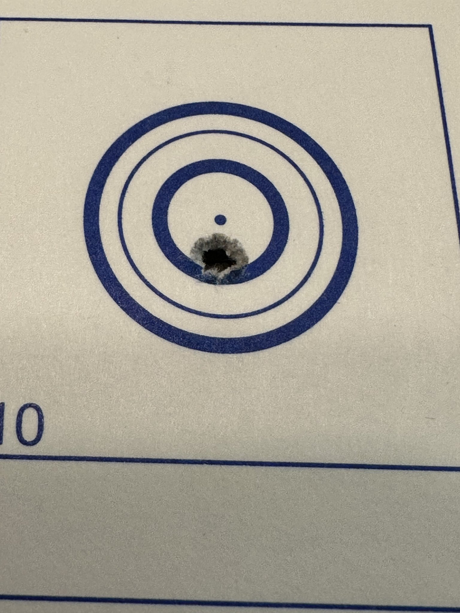

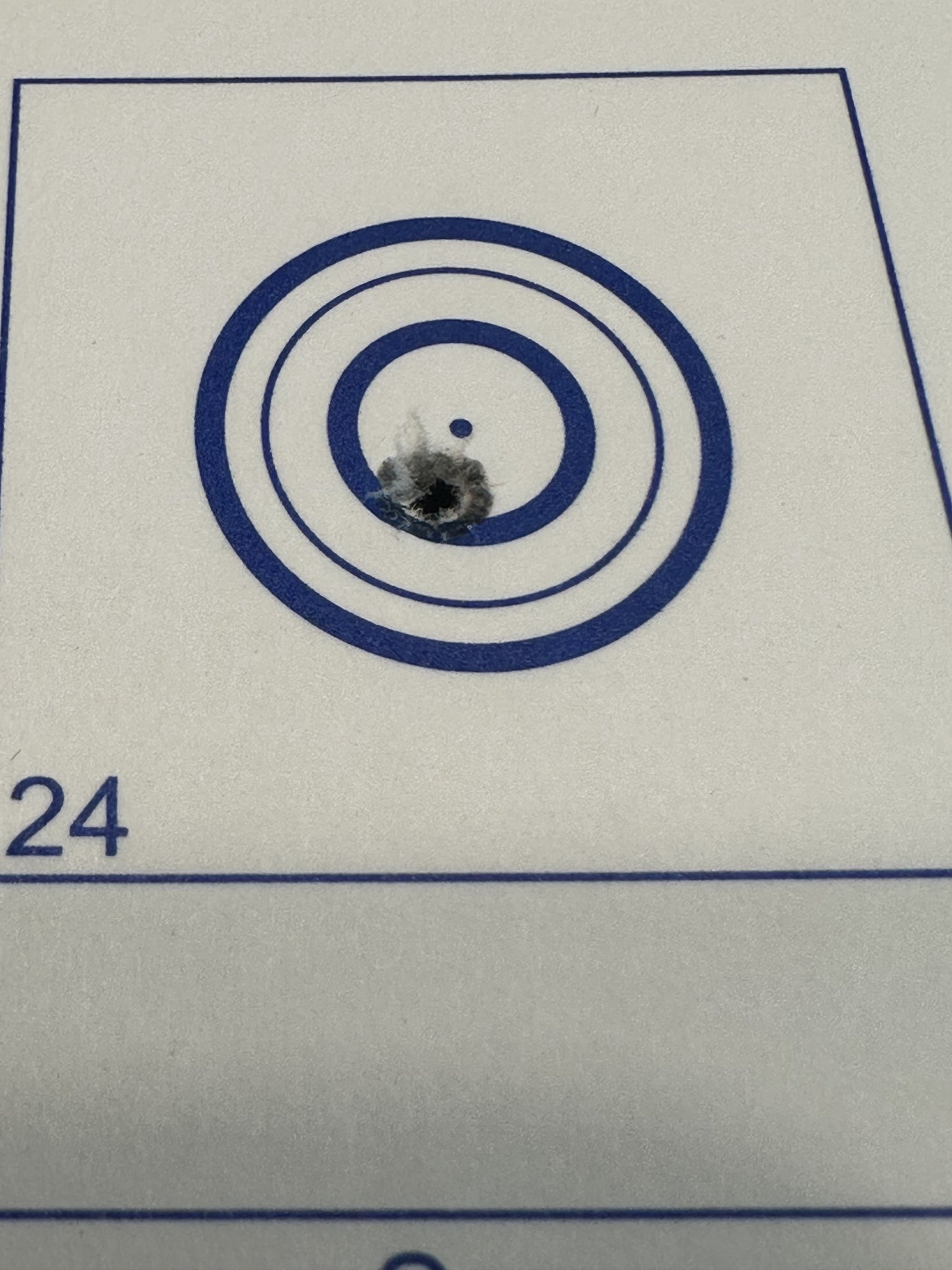

Looking for some scoring help. Posted two targets and some close ups of questionables. I don’t have a plug. Maybe I need to get one. These were shot at 45 yards off a bipod and rear bag. One with tenex that doesn’t seem to shoot great. Has a big es and sd. The other with lapua super long range.

Target #10 is the only almost questionable shot. All the other three I’d call as 100’s. I would plug gauge all of them but #10 is the only one that looks close to breaking the line (ARA uses worst case scoring, if line is broken you get the lower score).
Scoring targets after the match is one of the reasons I gave up being a match director for ARA as it eats up so much time . Even after we switched over to a scanner it still took about 2 minutes per target as opposed to 5 minutes per target when done by hand. And the scanner wasn’t perfect either. It would mis-score about 1 out of 20 cards.
