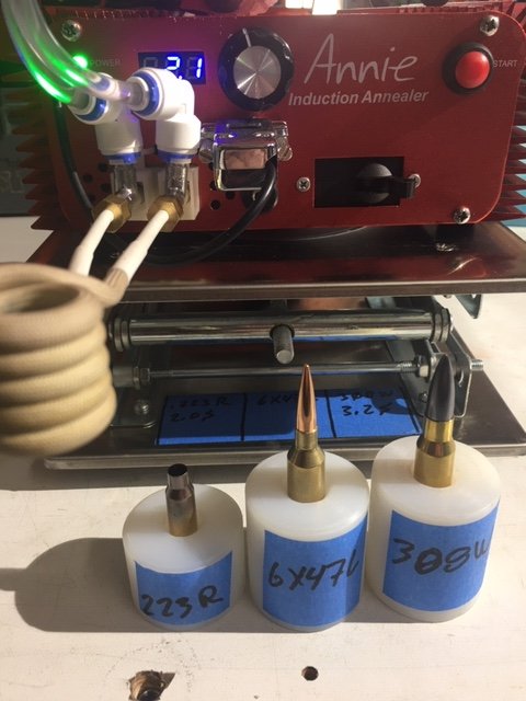

I've had flame type and salt bath annealers in the past and both have their pros and cons. In both of those cases, there are potential safety hazards. The salt bath set up uses a Lee solder pot that rapidly loses temp/heat, the faster you go. So, you have to sit and wait for the temp to come back up to set point.
I only anneal CF brass that I will be using in my bolt guns. Each of those calibers are limited to 50 rounds of active Lapua brass and those rounds live with each rifle. Those pieces of brass will probably be reloaded at least 20 times, minimum. I've made delrin "cups", which are brass holders that place the neck of each case at the proper elevation in the annealing coil. Sounds more complicated than it is, picture below. I'm thinking that I'll be able to anneal 50 rounds in less than 5 minutes using the Annie. The salt bath annealing would require that I wash (stainless pin, wet tumbling) the brass to remove the salt. Then the drying process........wasting more time.
I have had a problem with the circulating pump of the Annie water cooler leaking. I notified Garett @ Fluxeon and he has jumped all over it and is sending me replacement parts ASAP. He didn't dodge or deflect and immediately owned up to the problem and so far, has taken care of me.
So, would would I buy an Annie again ? Yes. Would it still be my purchase of choice for either flame, salt bath or induction annealing ? Again, Yes.
Oh, and BTW.........the loaded rounds in the pic below are simply for illustration, they're NOT going to go through the annealing process......
