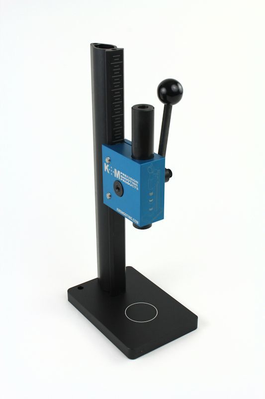

That unit looks a bit sketchy for serious reloading - and it is probably way too big. Rather than buy one of the ridiculously expensive reloading market specific presses, I use a general purpose arbor press purchased from eBay. Works very well at a fraction of the cost.
Just a follow up:
I use this press and bolt it to my reloading table for each use (takes about 1 minute to bolt on or off). For shorter dies I have a metal plate and for longer dies a metal cylinder to provide extra height. Works great.

Having been digging around looks like Rider47's press is identical to a 0.5t Arbor sold by Sealey Tools here in the UK and can be had for £70 ( nearly US$90) which is half the cost of a Sinclair.
