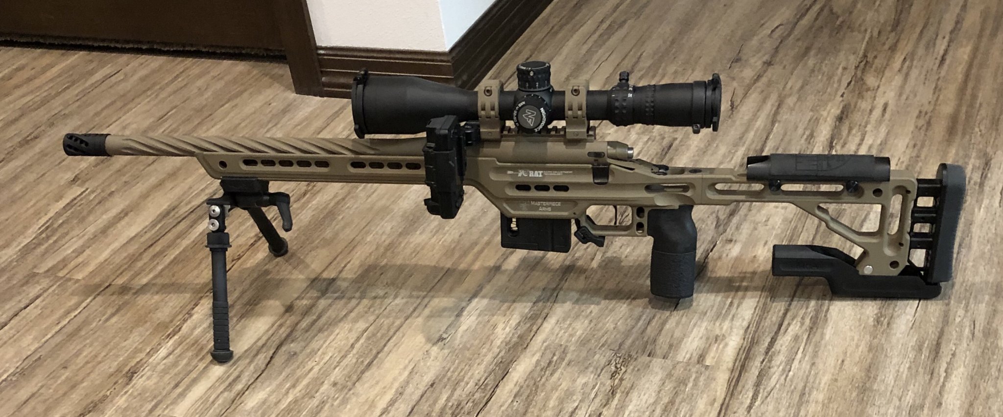

I use them on my Vudoo .22, no slippage 😁

I had NF rings on my 375CT, I kept tightening them more and more and the NXS 5.5-22x56 kept slipping, the tube got slide marks and slight ring indentations, which was so infuriating!! I sold the scope at a huge loss.
I bought ARC rings to replace the NF, the NF are now on my PCP air rifle, no I'm not kidding! The ARC's are the old original double strap wrench style which are awesome! There was absolutely no slipping afterwards on that same rifle. Infact when I sold that scope the tube looked like new.
I still have all the ARC rings I bought which have been used on many rifles and with many scopes. Only problem was a screw got wallowed out which I replaced. That was my fault because I remember the time I didn't put the allen wrench into the screw all the way.
Customer for life!
