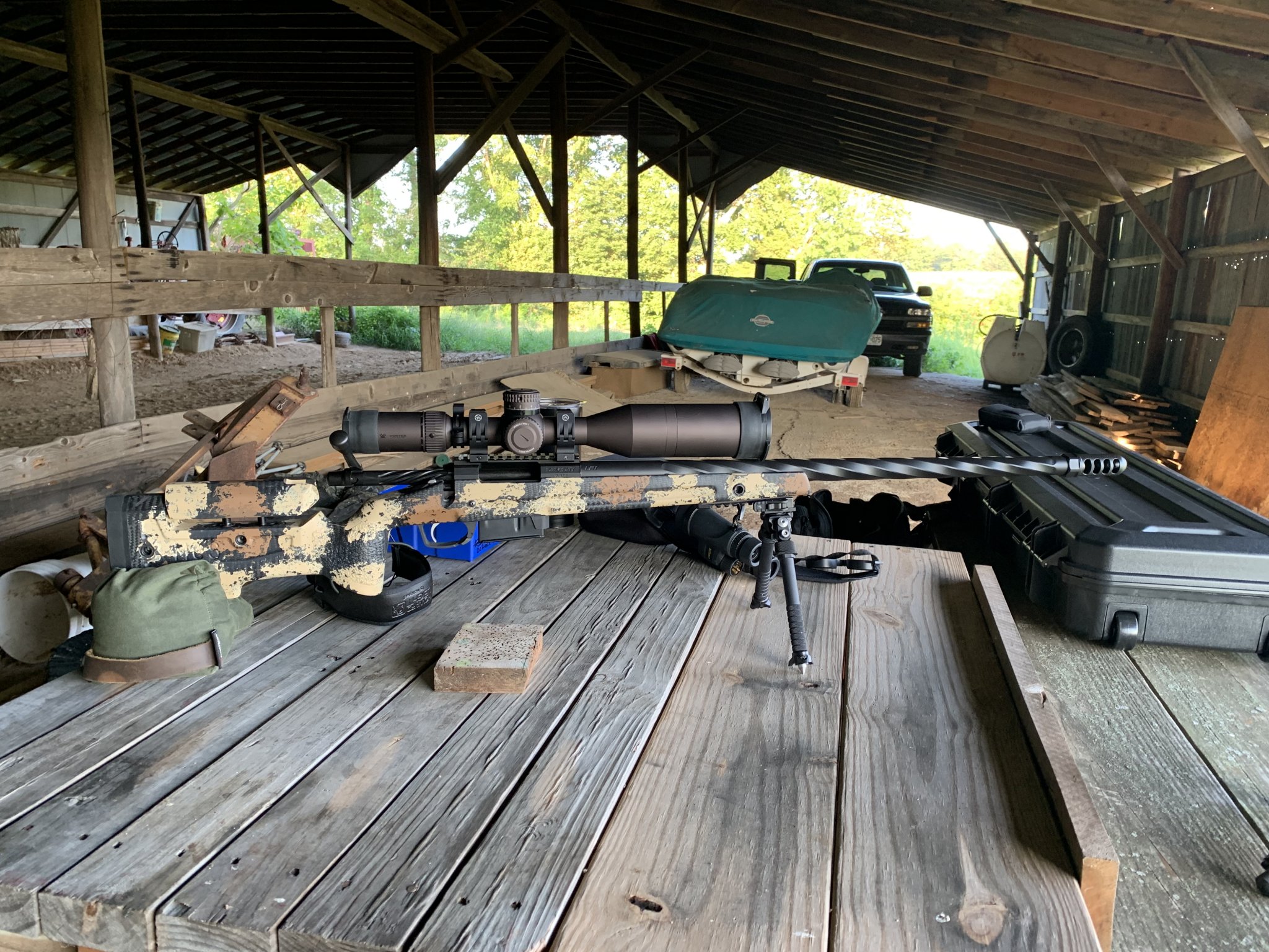

4.5-27x56 on a custom 6.5x47 Lapua with a Marksman contour Barrel and a 20 MOA Bighorn scope base.. Also has vortex defender caps and I stayed at a holiday inn express last night....

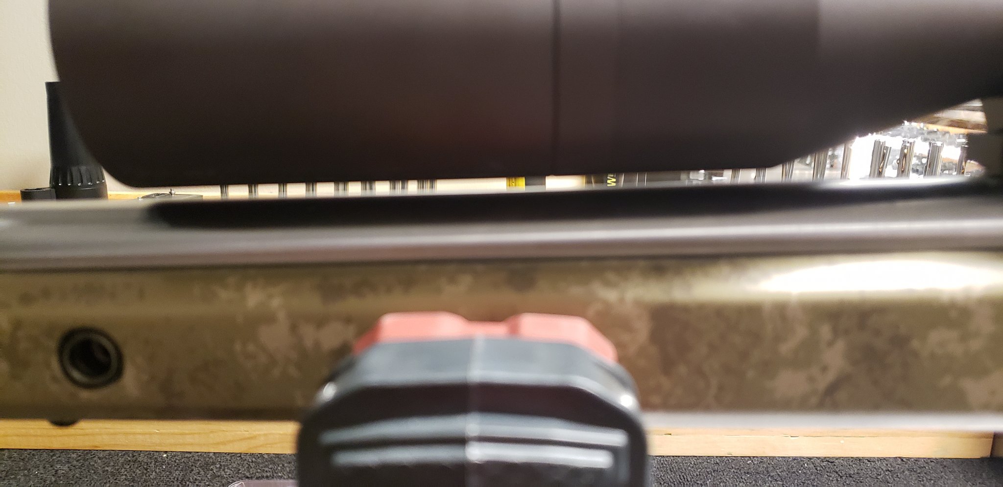

On a Tikka action with 20moa EGW base and Bartlein Heavy Palma, a 4.5-27x56mm will be too close with ARC lows. I could see light between scope bell and barrel but could not squeeze a sheet of paper thru. Went ARC medium and it's perfect with Defenders, even leaving me a bit of room to slide a Game Changer strap underneath, if you're into that sort of thing.

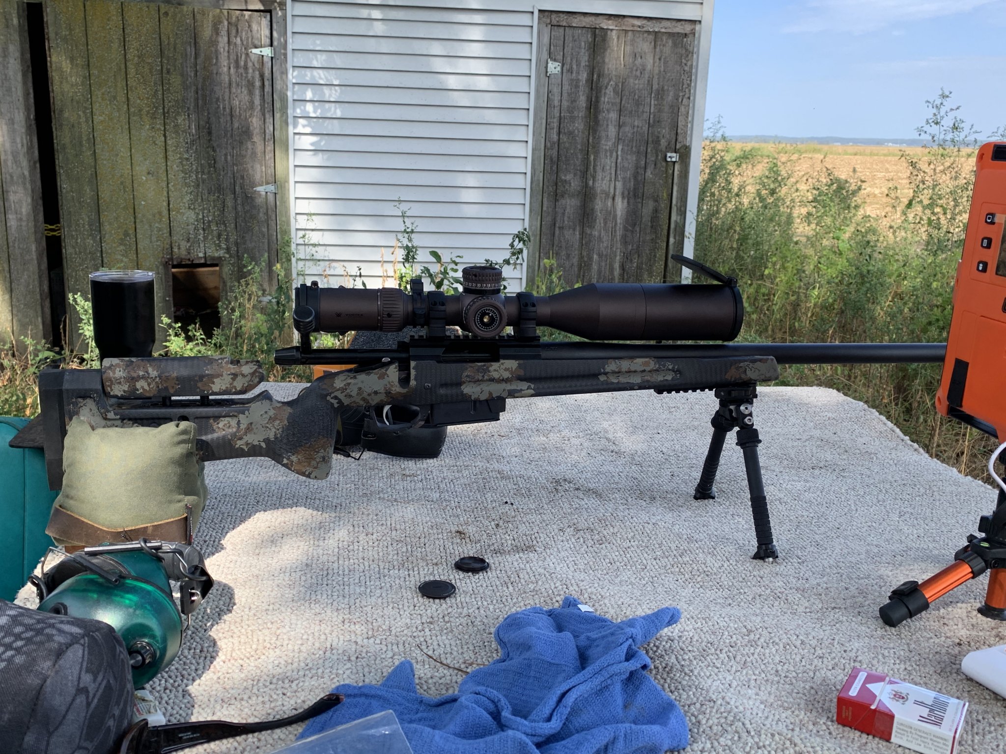

I just mounted a pair of LOW ARC 34mm rings on my SPR with a 20 MOA base and a Kahles 6-24x56 and I have just enough room for the lens cover
