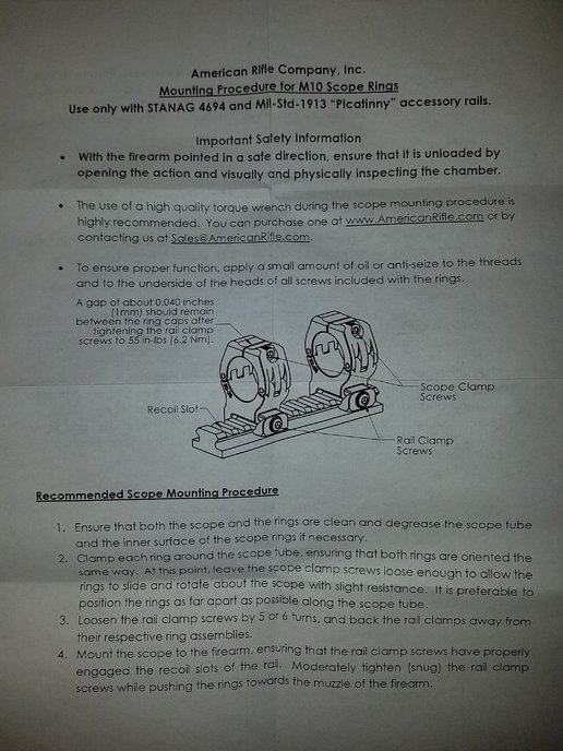

When in doubt, follow the instructions. 14965054200111195918246.jpg1496505454770578366575.jpg

ARC specifies wet torque with either oil or anti seize per the instructions. Conveniently, they also give an approximate torque-angle spec for people who don’t have torque drivers of some kind (which everyone doing any firearms work should).
