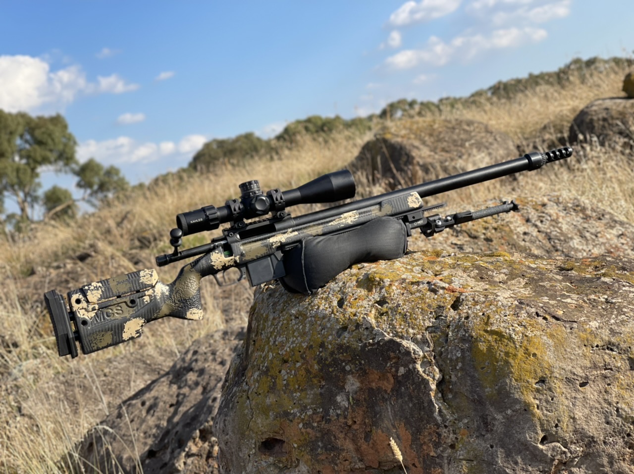

Here’s a medium set on my Nuke with a 45 moa rail and a 56mm Cronus to show as example.
I run mediums which are 1.1 inches high, on a 30 moa rail, with a 1.25 straight barrel and I could get away with the lows which are 0.94 inches high. Got about 1/4 inch clearance at the moment which is a lot but is a great hight with my cheek piece nice and low and a jaw weld for positional shooting.
Yeah I thought the current philosophy is good positional height and good cheek weld for a better npa? Isn't the get the scope as low as possible passe these days?
Reactions: rydah and MarinePMI
Pretty much. I try to have an upright and flexible jaw weld so every position is as similar as possible from low kneeling to standing etc.
Even just prone I find higher rings just more comfortable.
Reactions: rydah
