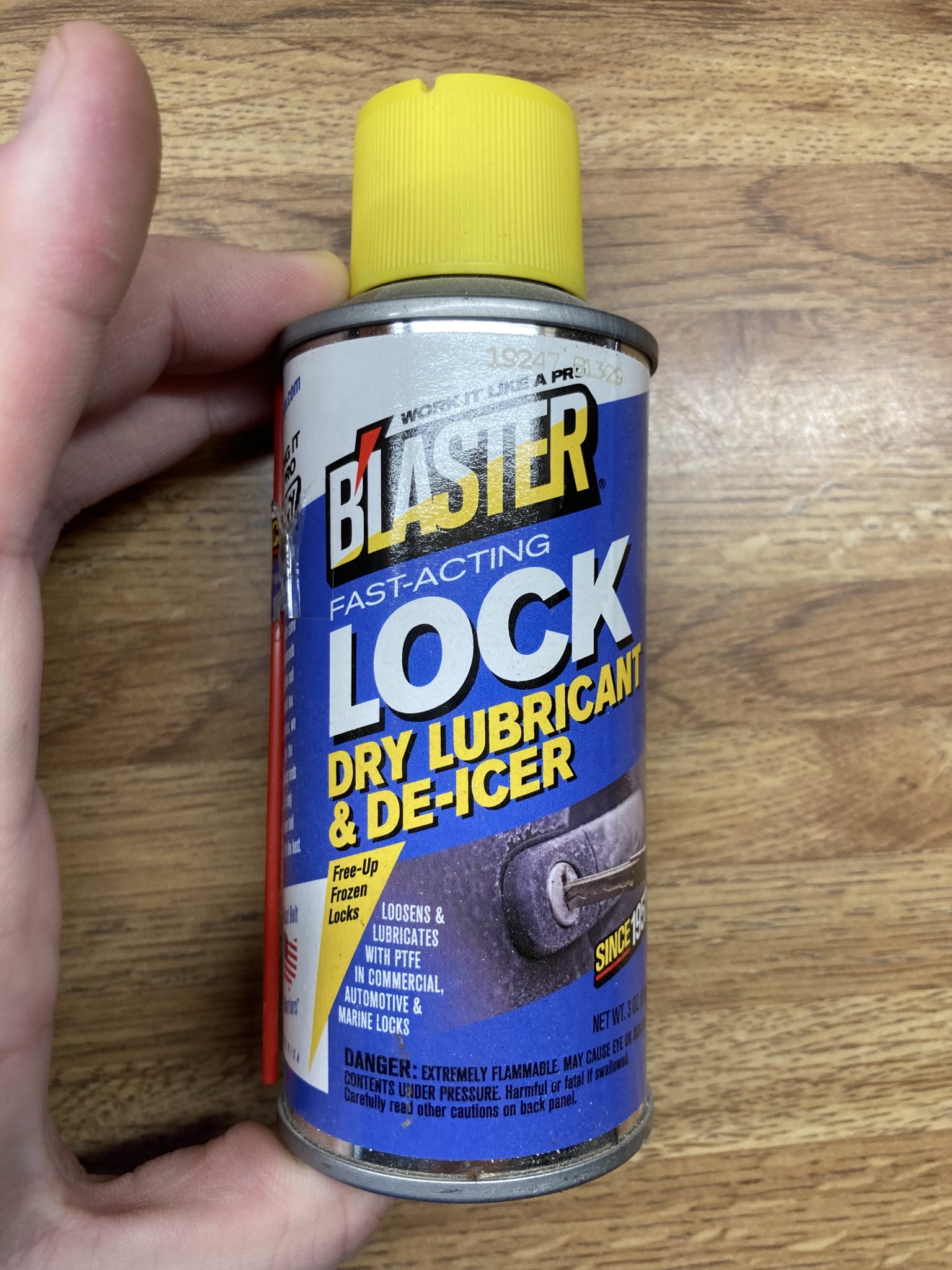

    I figured out that they need to be clean and lubricated to run reliably. I have found that lock lock deicer/lubricant works well to keep the followers moving freely.
