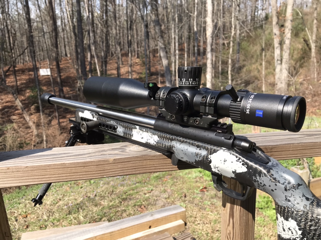

The 1.26” wouldn’t be bad for the mount. Here is a picture of the same scope on a 40 moa base in a 1.125” mount so the mount you are looking at would be about .1” higher than that. Would come down to if you had an adjustable comb stock so you can raise it a little to adjust.

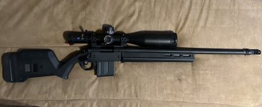

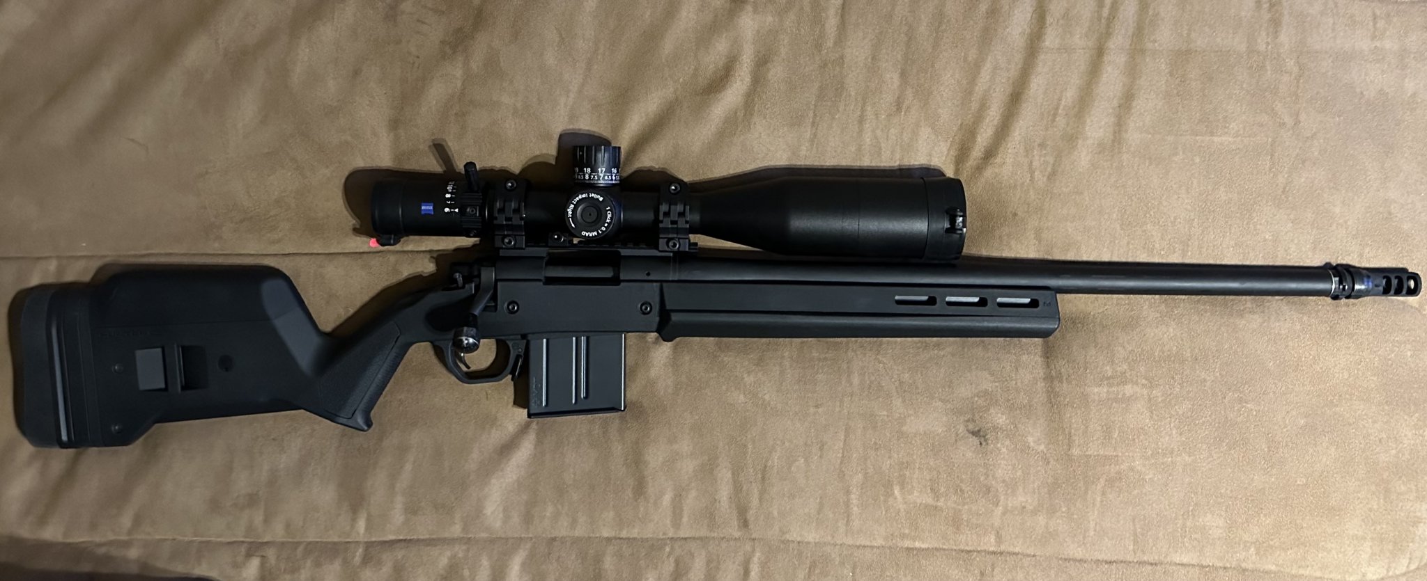

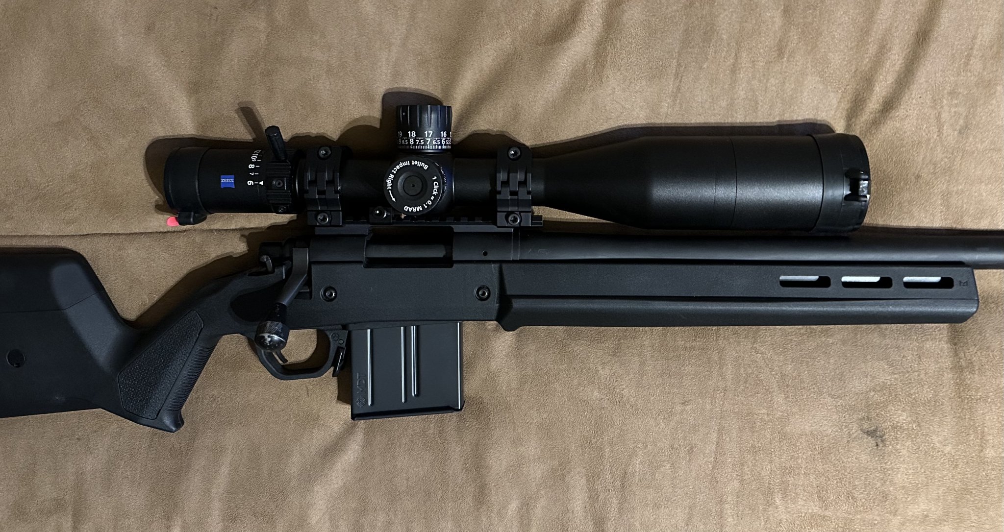

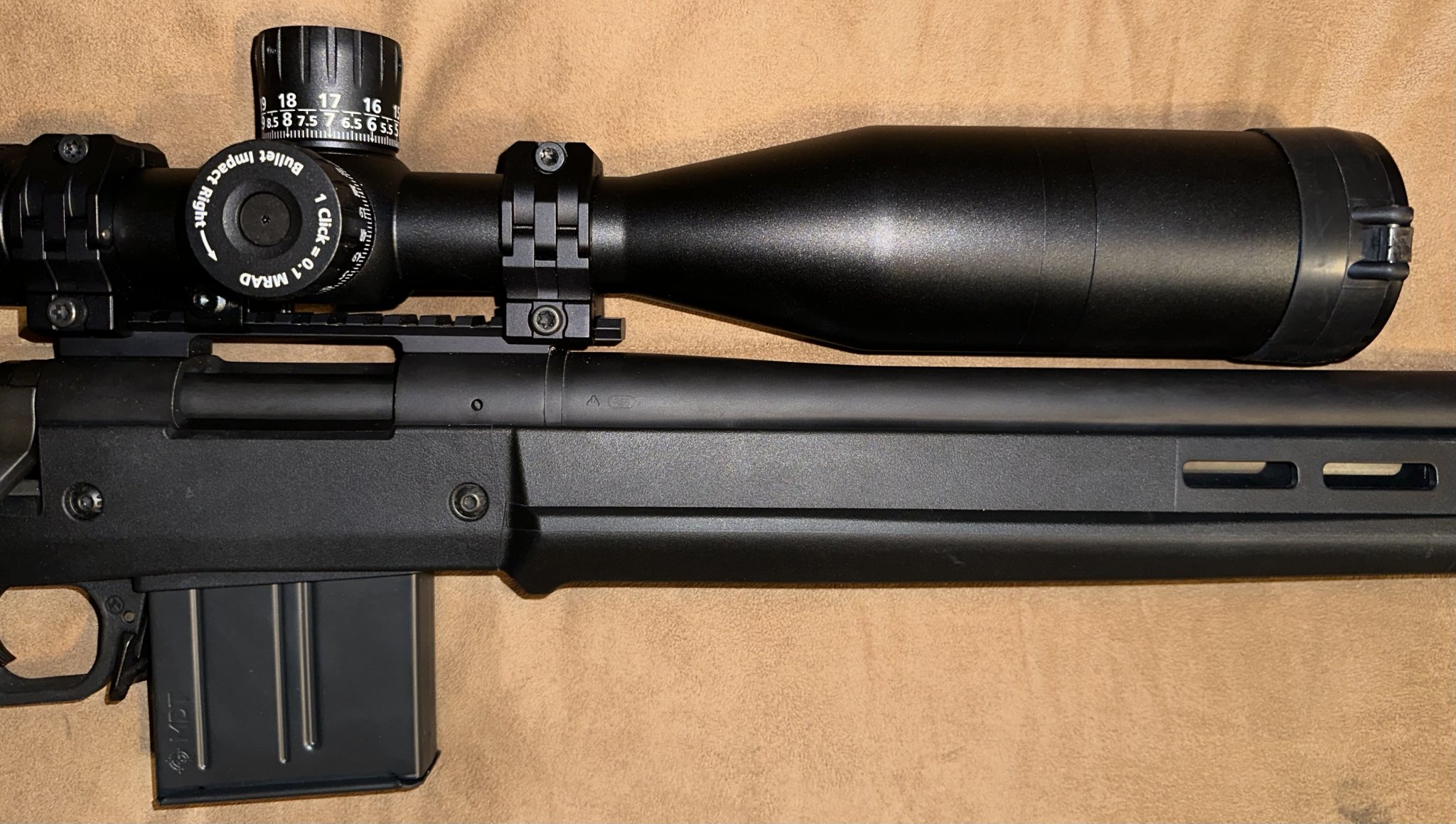

I went with the ARC M-BRACE 34mm rings 1.00" height. Worked perfect on my 700 5R Milspec .260 Rem with a 20MOA base. Plenty of clearance for the scope cap with a sunshade. 👍🏼

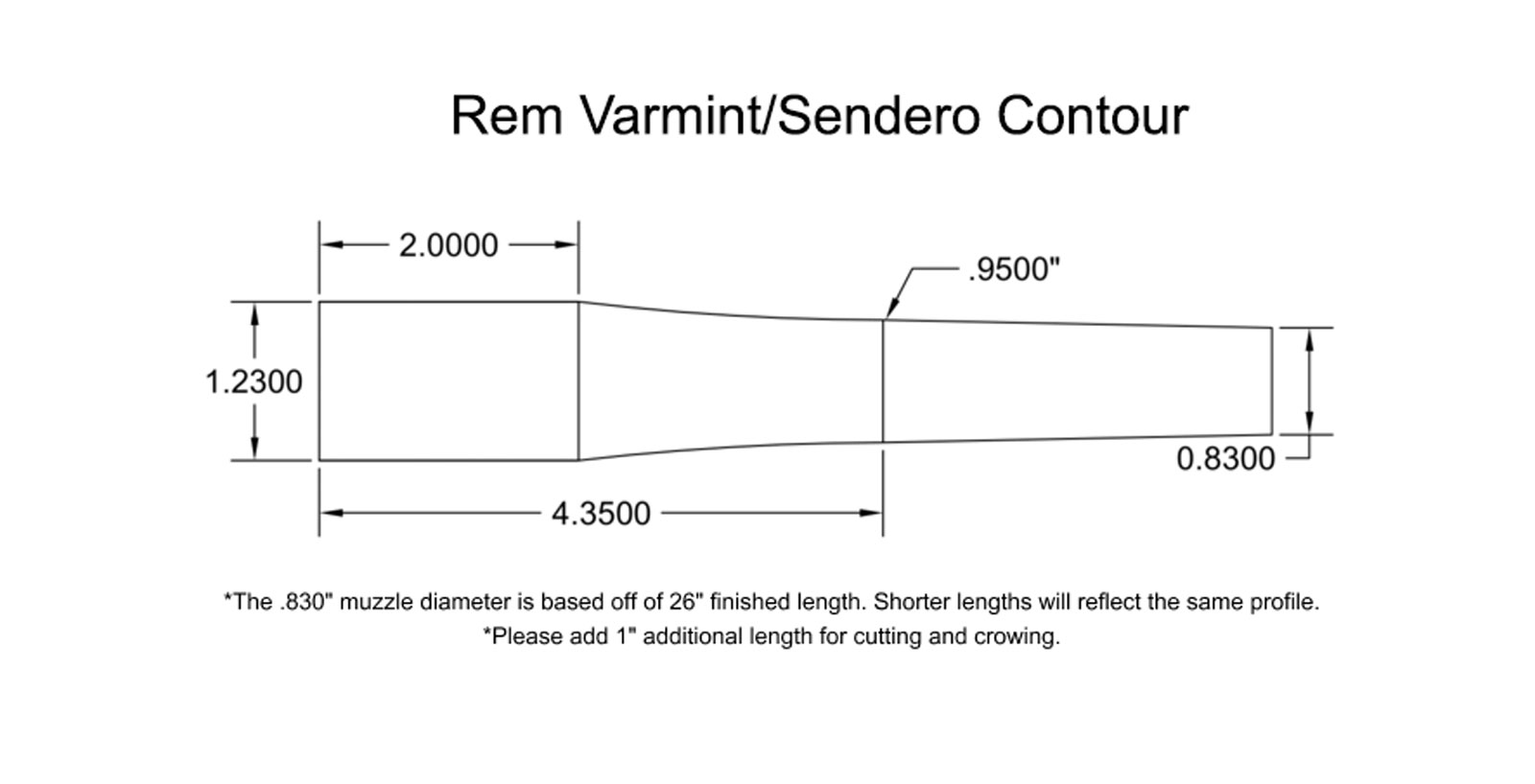

Curious how fat that barrel is. Considering ARC .98 rings with my proof contour barrel just not sure it’ll fit.
