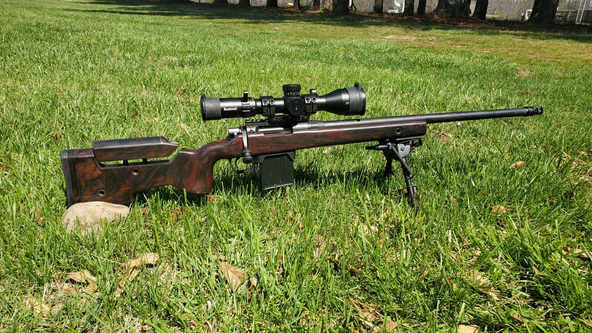

Here's an exodus that was inlet for an impact, not yet modified for Nuke. Only issue was very bottom of bolt handle slot and port cut. Slot was deepened, slightly, to provide enough clearance for a postcard to slide under it. Used a wood dowel and emery cloth. Ill see if I can get a pic of port after I opened it up, as is in pic didn't interfere with ejection. I'm back to running it in an mpa chassis. I should post this in px sometime.
pro tip: don't use a dremel, I see plenty of buggered up stocks in px here. "Modified for lower bolt release"....... looks like the dremel got away and dug into corners and wallowed out. How to make a 1000.00 used stock into 750.00 tops....
