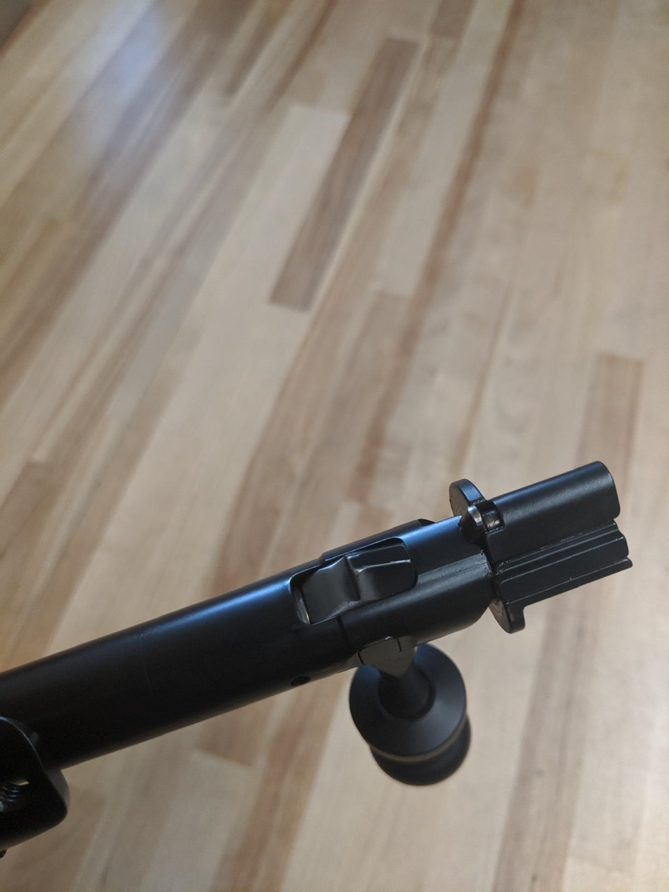

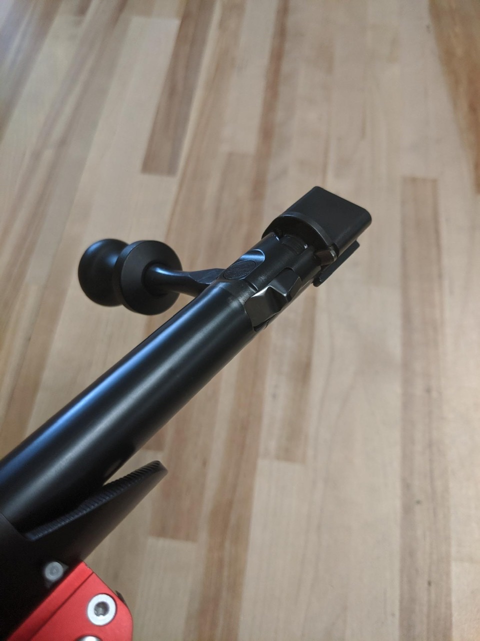

I did indeed bevel the plungers. On one of them it wasn’t bad and only hitched up when I tried. The other one was much worse and hitched up cycling regular speed.
Once I beveled them, the problem went away.
