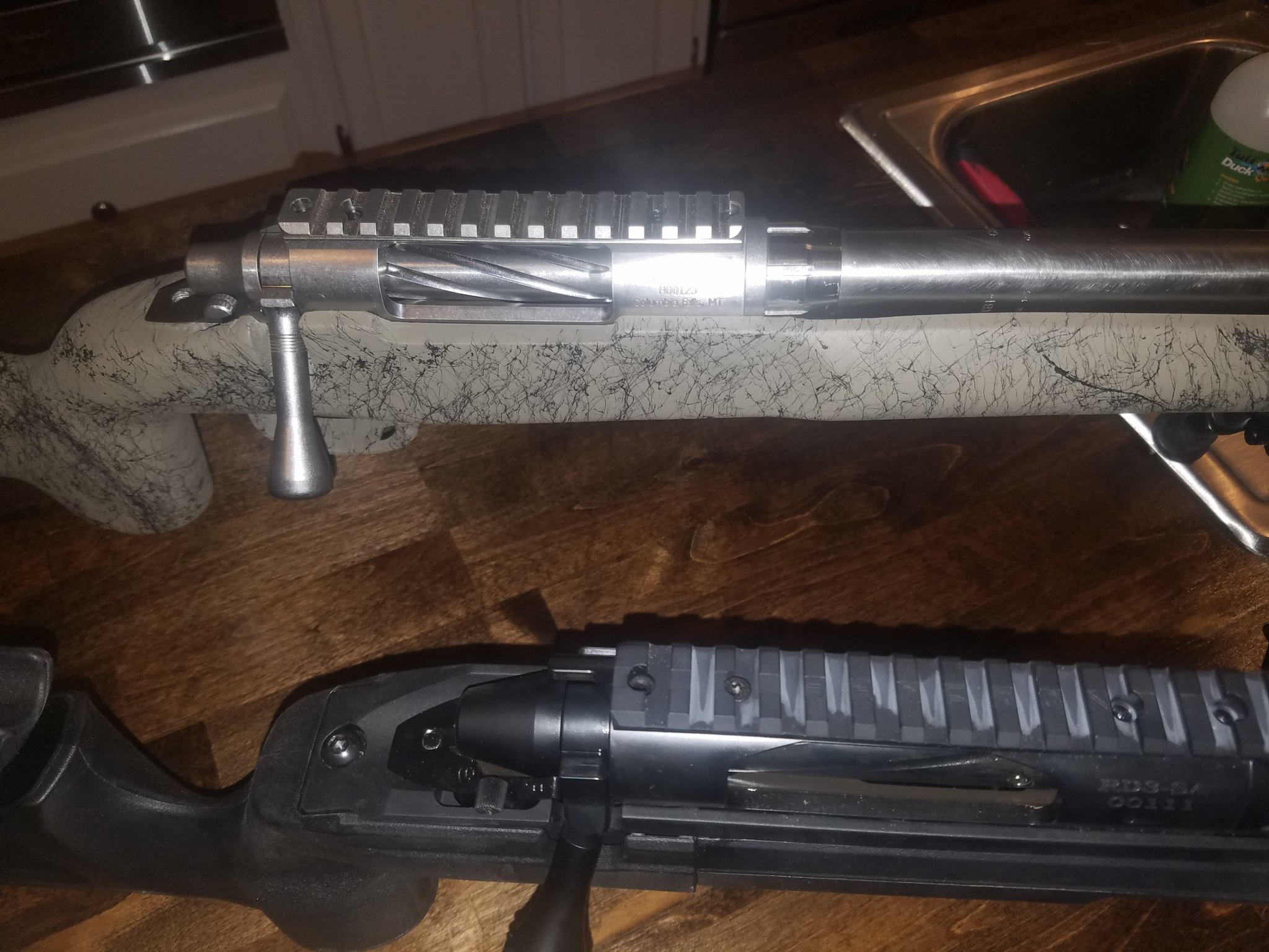

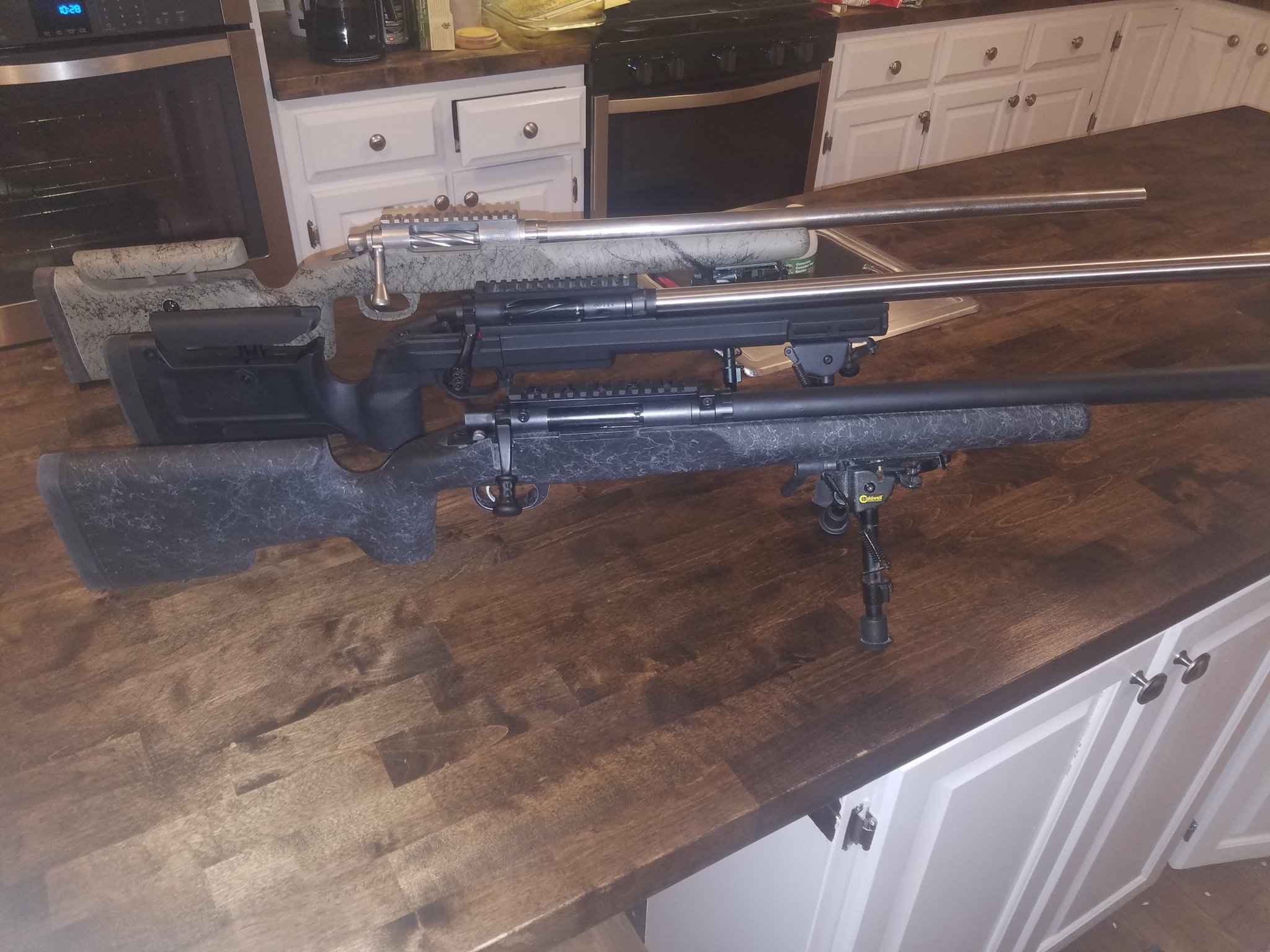

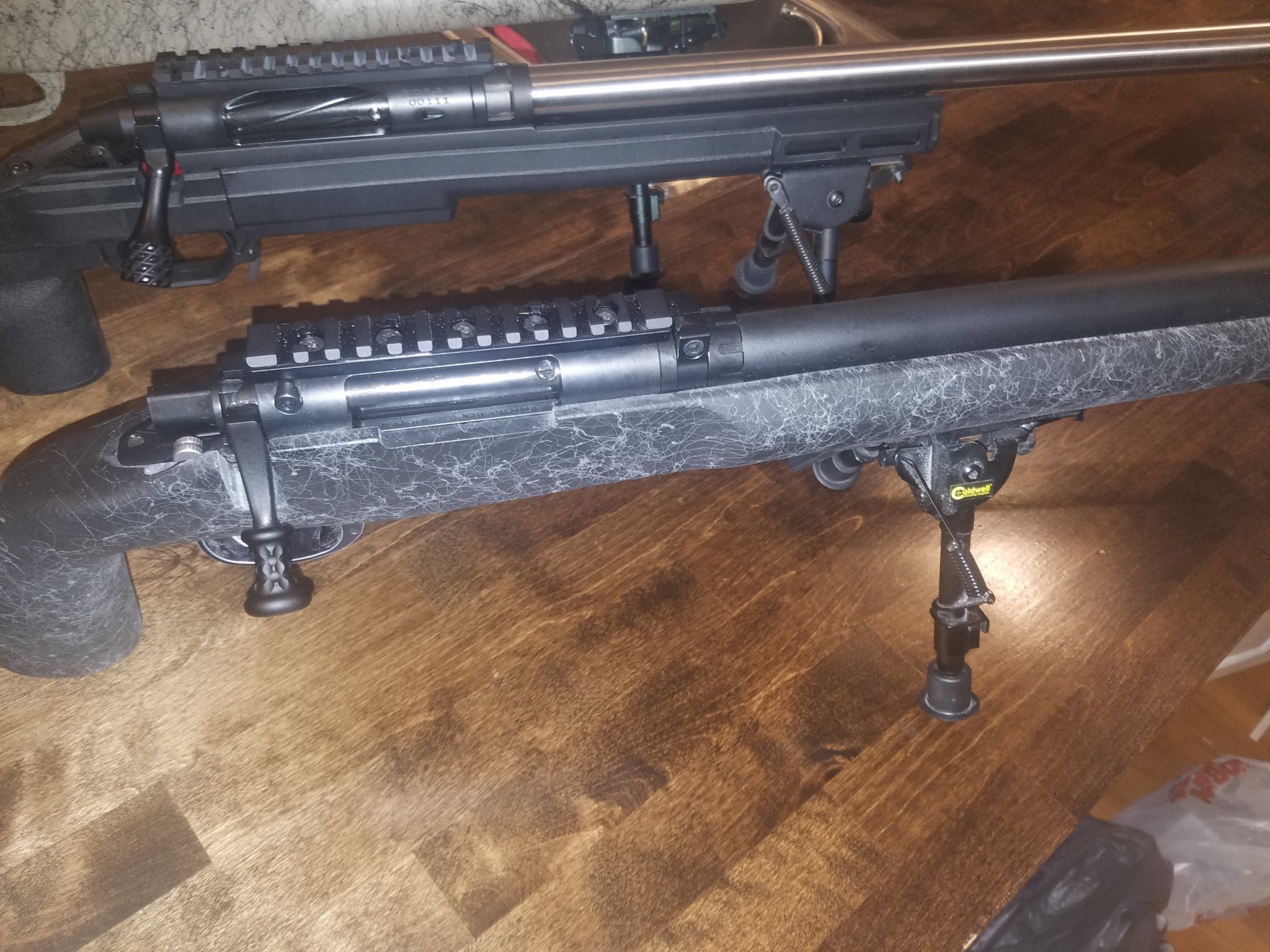

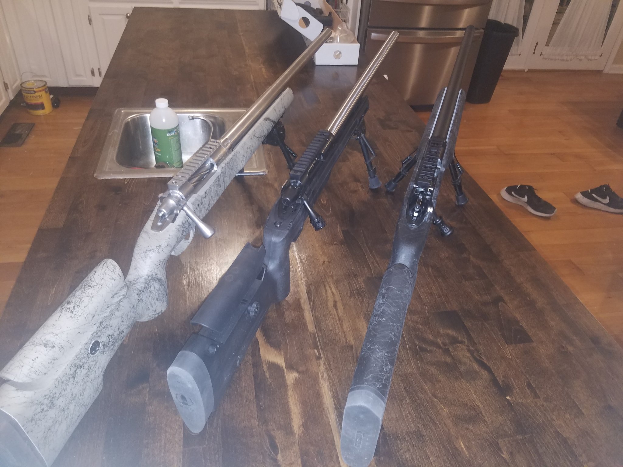

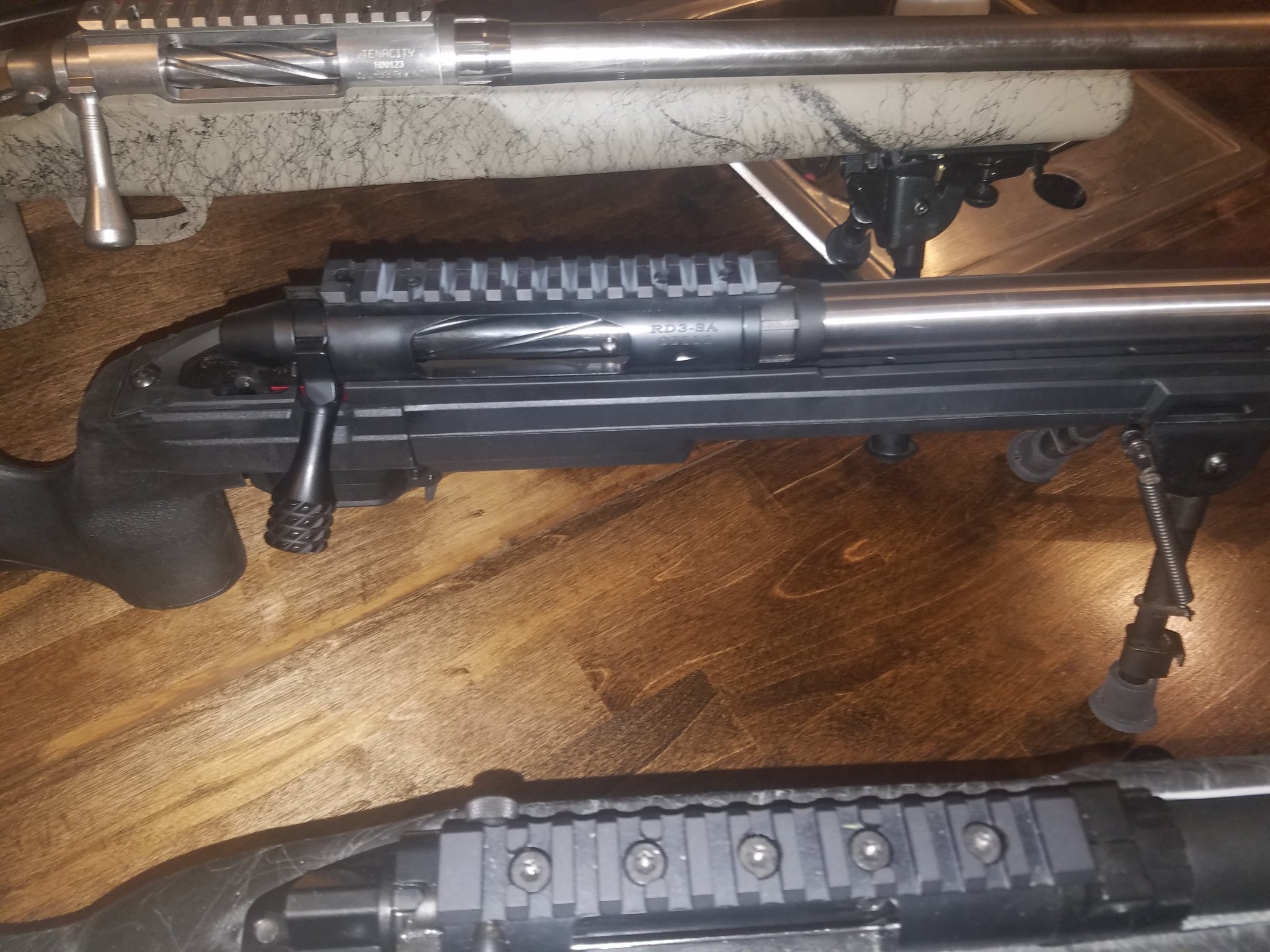

yeah, also made the mistake of getting a kelbly black bear when i found sn 26 in stock. That thing is sweet and built like a tank. Going to not do anything with it till after I play with the other actions as it is classed a little higher and would damper my thoughts about the others.
Nucleus short action .473 with x caliber 6mm creedmoor in grayboe renegade with ptg bottom metal and tacsport trigger.
Origin magnum bolt face, 6.5 saum, krg bravo, tt diamond.
Tenacity, 6xc criterion, grayboe renegade with custom made adjustable check test, ptg bottom metal and tacsport trigger

Thanks dai. I really like the tenacity. It has a duller finish than the rest of the defiance line, just fished with different kind of tumbling material, I polished it slightly to see how it would look. Pretty happy with it so dont think I will do a mirror finish on it.
If only it had mechanical ejector. But with badrock rifles using this action, well variant of it, and having control round feed and mechanical ejector it might not be long before available on tenacity. But the badrock rifle itself looks like a heck of a deal on a fully build defiance based rifle. Dont think they have announced, possibly haven't sourced, the barrel manufacturer yet though.
