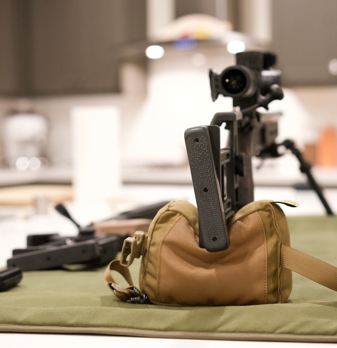

    The mag detach is wonderful, ergonomic, allows easy removal with a 'grip' - thumb release and mag grab so it doesn't just dump on the ground if you don't want it to (very sandy where I am so I like that). It also, works as advertised for removing any wobble in the mag when pressed against a barricade. That hump was smart...

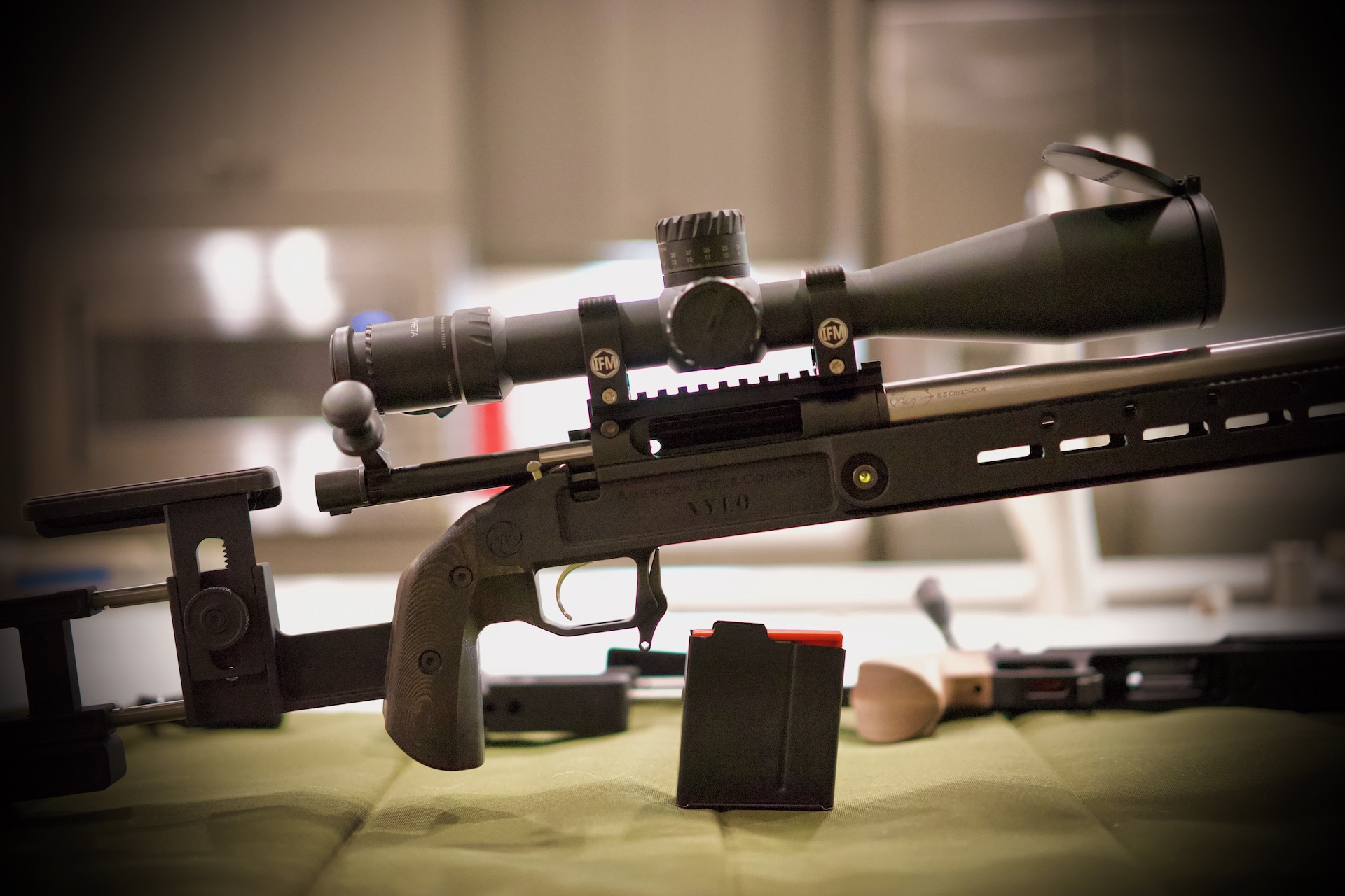

    The magazine is REALLY nice. I know, it's just a magazine, but the feel, finish and function is butter smooth. I prefer it to AI's mags.

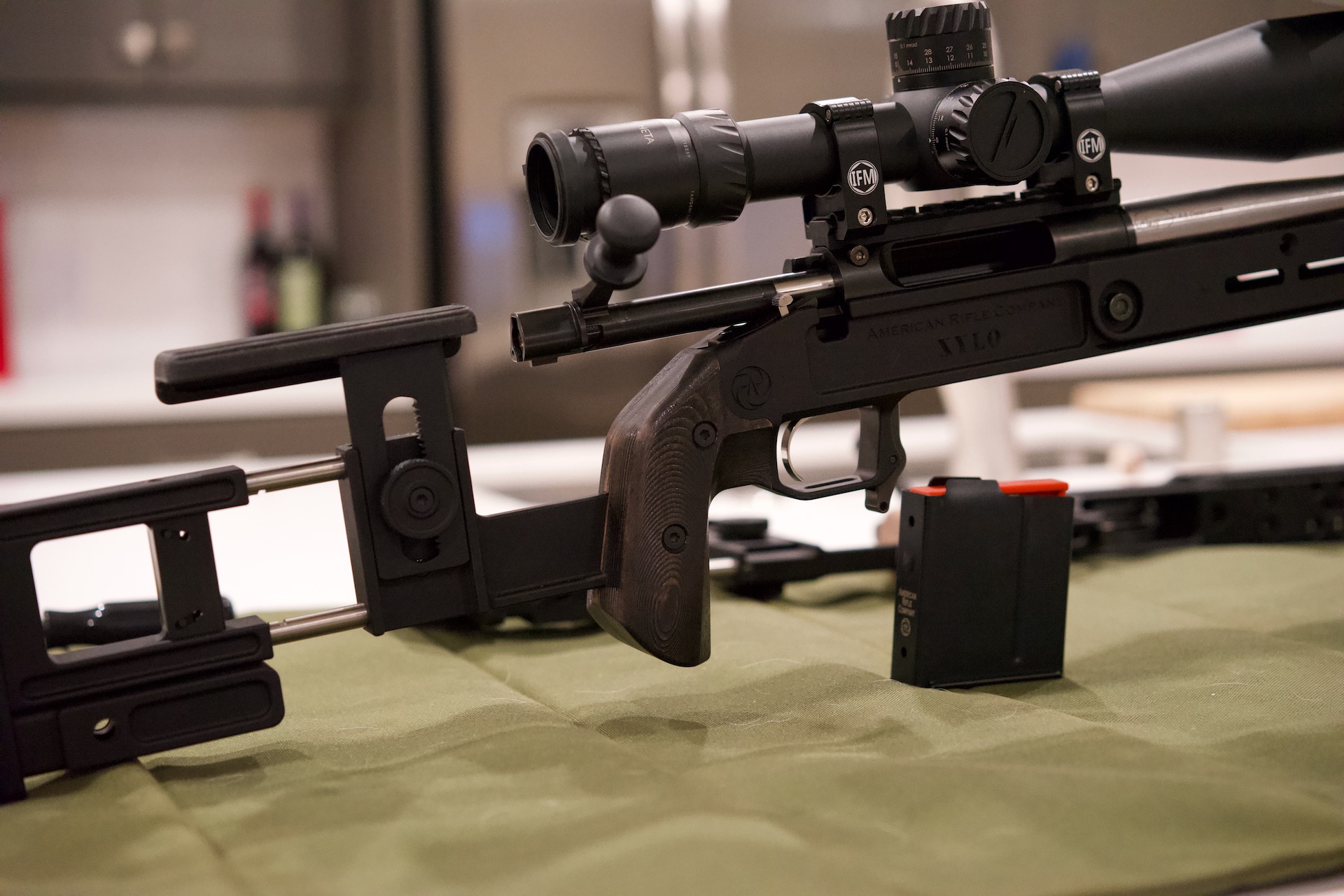

    The grip was the part of the whole chassis that I was most stressed about. It was either this chassis or an MPA, but once I got my hand on this grip, it was a done deal. The feel of the wood, the swell of the shape is just perfect. For the centerfire action I prefer the slightly smaller grip and the RimX has the large grip. I may just go large for both...
    So, onto the ergonomics. Really appreciate that ARC allow for vertical and axial adjustment of the butt of the stock. you have LOP, cheek height, left/right and yaw. It's everything you need to get that 'immediate' sight picture and driving position for the rifle.

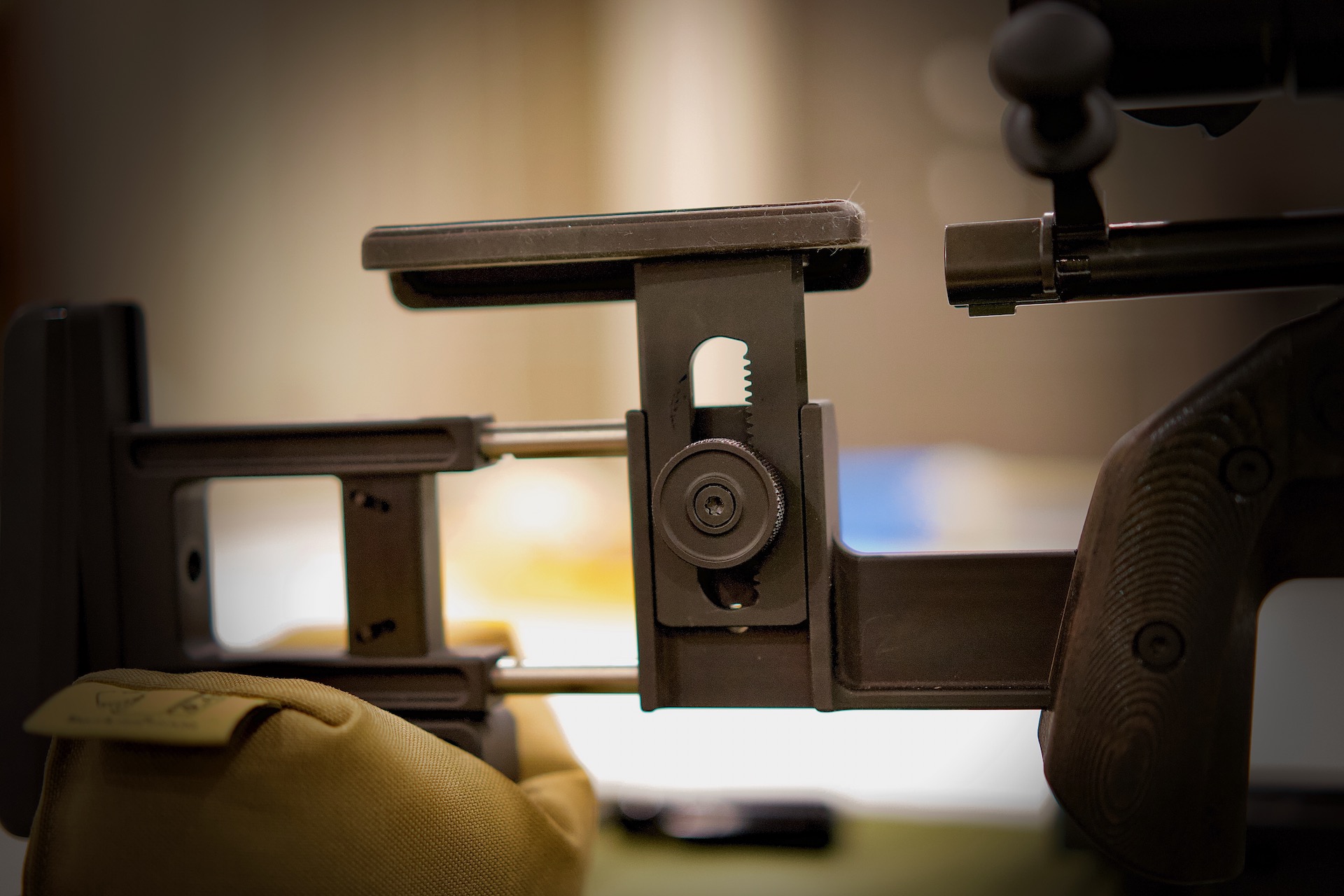

    Cheek height - for those of us who have high cheek bones, getting the right height on the cheek rest can be a pain. I used to have to add a couple layers of mouse pad materials and it made the cheekweld rather squashy. With the Xylo, I can rest my head on the cheekrest, and adjust the rest to the level I want and then lock it in within seconds. No tools needed. Once it's locked in (And you can lock it in without removing yourself from the site picture) it's not moving unless you want it to. It's the best design for this adjustment feature I've used.

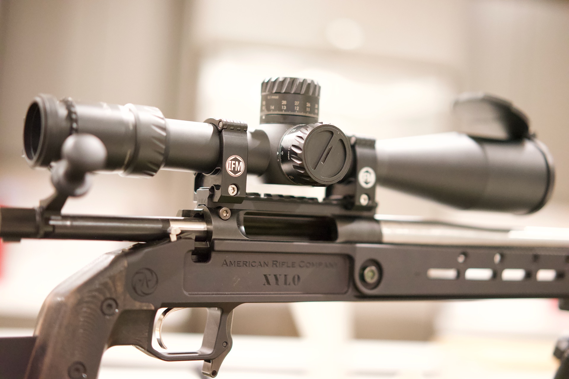

    Rings... love these IFM rings. Exceptionally well made, designed and they don't look overbuilt because... 'tacticool'....

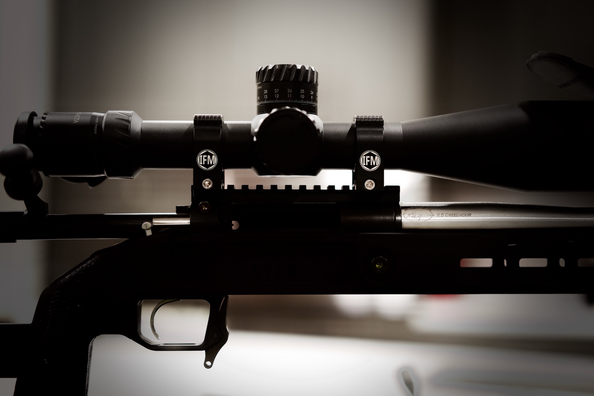

    Like Liberace... can't have too many shots of rings...
    And it's all for ought if the barrel isn't a PVA barrel...
